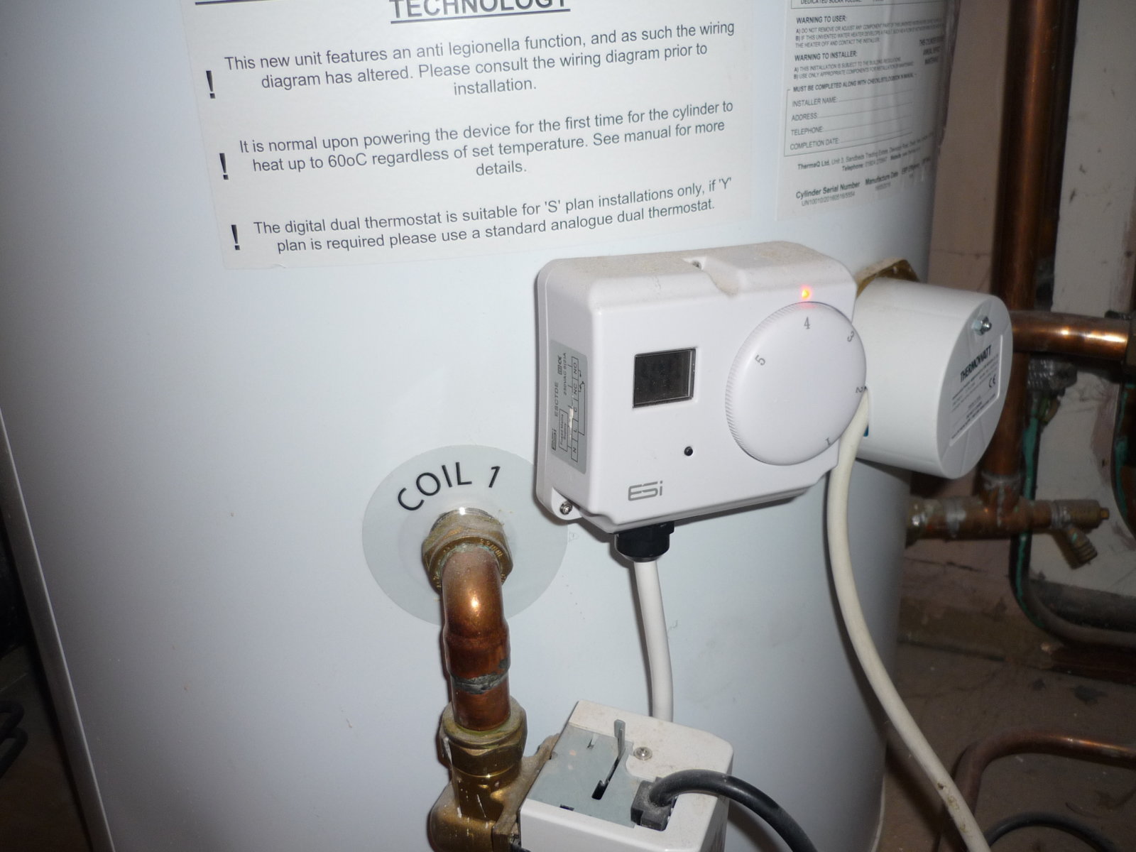

My house is heated by a Myson Velaire oil fuelled boiler (about 30 years old). About a year ago, I got a plumber to come and change the system so that we have a direct pressure feed with a new Unicyl water tank and a Honeywell ST9400C control system to run it all.
Things have worked quite well since then, but I noticed the other morning that it wasn't making the usual sounds when then system comes on in the morning. There's usually the sound of water moving around in the pipes as the boiler comes on to heat the water.
The water continued to be hot, so I didn't worry about it. However, what appears to be happening is that the water is being heated by the electric element in the tank (potentially expensive?), so that the boiler doesn't need to fire up. The boiler's light is still on, it did fire up briefly when I switched the whole system off and back on again, but now it sounds as though the electric element in the cylinder has taken over again (it makes a quiet humming sound).

That's the bit that puzzles me. In the airing cubpoard, there's a switch that looks like a light switch, which I assume is what switches the electric element on or off. It's always in the 'off' position.
Yet when I look at the tank (see picture attached), the red light for the temperature control is on, regardless of whether the timer setting for hot water means water is being heated or not. It also makes a sound like when you've just turned the kettle on, but quieter, which is what leads me to conclude that the electric element is on. You could assume that the element switch is wired wrongly, but why would this start happening after a year, having worked properly before?
Should I remove the casing to the element and see if it has power supplied to it?

That type of stat incorporates a anti legonella program and may be faulty and raising the temp above boiler stat set point.

I've investigated a bit further and switched the system off overnight. When I turned it back on, the boiler fired up and worked as usual.
I suspect the reason it wasn't firing up before (or making so much noise on start up) was that I had turned the temparature down on the tank and so there wasn't the need to heat the water as much.
I've also check the electric element with a current detector. There's current when the switch in the airing cupboard is on and none when it's off - so no problem there.
Having listened more closely, the 'kettle-like' sound is actually the sound of the electric pump working non-stop. If the system's on, it's pumping. I don't understand this, as it's supposed to be a mains fed system. Nonetheless, regardless of whether the heating or the water are swithed on or off, the pump's running. I would have thought it would only be needed for the central heating.
