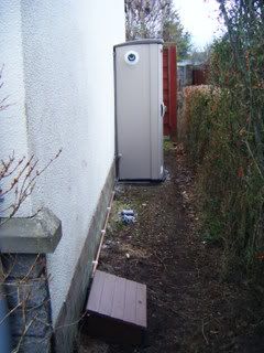

You could do this and it went through a minus 10'C for a week with no probs.
Inside is lined with Kingspan and the doors too.
