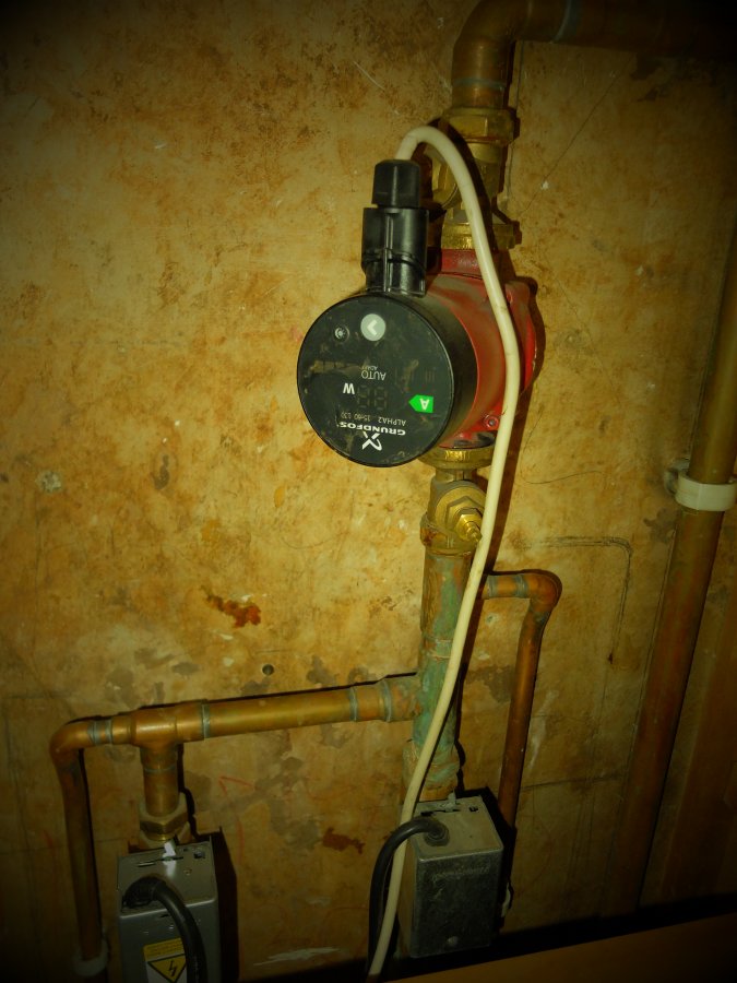

A strange fault has developed over the last week or so in our Worcester Bosch 40CDi (conventional) based central heating/hot water system.
Several times over the last week or so there has been load banging coming from the boiler when it first fires up in the morning. I was able to see what was happening yesterday and the boiler temperature was hitting the high 90s and which point steam was obviously being produced causing the banging. At which point the boiler went into some sort of recovery mode and after a couple of minutes fired up again and everything then works normally for the rest of the day. The hot water produced by the boiler is of the correct temperature, I have checked all the radiators (which heat up normally) and there is no air in the system that I can detect and the header tanks are full.
We had the central heating pump changed about 5 years ago, and about two years ago I changed one of the motors on the 2 motorised valves we had in the system.
There is obviously a problem with water getting to the boiler which corrects itself on the second attempt at firing up. This makes my think that something is sticking or getting jammed which is then starting to work on the second attempt.
Is there anything in the boiler which could be causing this (i.e. do I need to get Worcester Bosch out to fix it) or is it more likely to be a pump or valve sticking in the airing cupboard?
Any thoughts on what it might be or fault finding techniques I could try?

I have had a look at the valves and they both seem to be operating normally. In fact the one that I recently changed is operating the hot water side. The pump does over run after the CH/HW is switched off and there does appear to be some sort of bypass pipes in the system (The pipework was fitted in the late 80, we replaced the boiler in 2006).

The bypass would need to be on either of the 15 mm pipes at the left or right of the photo.
What is the nature of the bypass?
The bypass pipes disappear under the floor I am assuming they connect to the heated towel rail in the bathroom but that is about as much as I know.

The pump is on the maximum setting, when I first had it fitted I did try the auto settings but I found the rads were not getting hot enough.

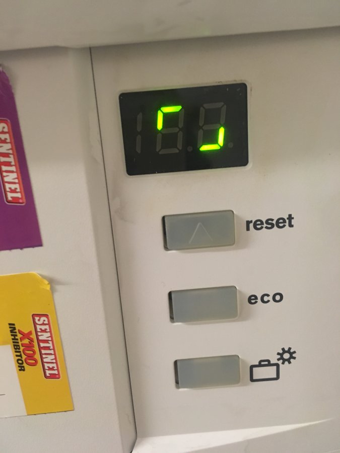

Is this the symbol?
Bottom line is the water isn't moving/not moving fast enough on first start up.
If it runs normally the rest of the time your best bet would be to get an experienced engineer there and make sure the heating/hw doesn't cone in before their arrival so they have the best chance of finding the fault.
Hi Phill
I don't remember if I saw that symbol or not, I did see a U1, U2, U3 symbol which I think means over 100C, it then basically reset itself automatically and when it fired up again (with me doing anything) everything was fine.

I would say either the pump is faulty. (Fit the head the correct way up this time please)
Or there is an air issue that settles over night at a high point clears after a few minutes of the pump running.

I have just fired up the system manually and the LEDs in the pump flash madly and the pump does not spin, after a short time I hear the boiler begin to bang. If I switch the system off then the pump continues to flash madly for a short time then turns itself off. When I restart it the pump non longer flashes and starts up (what I assume) is normally with a gradual increase in pump power over a short period (@ 20 seconds).
This is supposed to be a smart pump which can adjust its power to the demands of the system but I found it just left the rads too cold and we use in in the manual mode which rather defeats the object of the pump. I am guessing that the processor that controls it is not firing up correctly now and that either the electronics or most probably the whole pump need to be changed.
I remember the difficulty the heating engineer had in changing the last pump so I think I will get a professional to do this. I will however check with the manufacturer do see if their is a cheaper option of just changing the electronics which I would quite happily do.
