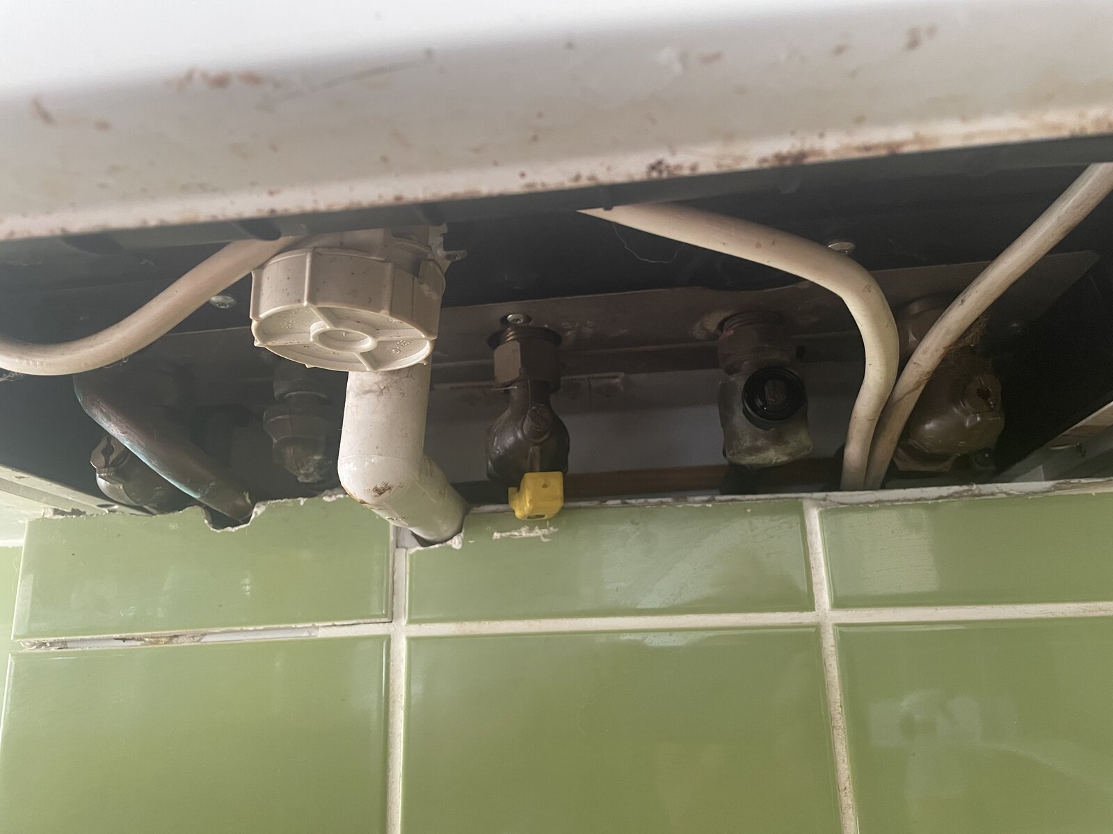

Hi, hopefully someone can help me. I have a Gloworm Betacom 24 boiler that’s displaying 0 bar pressure. If I press the reset button it will show 0.3 bar and fire off but almost immediately cut out. I’ve tried refilling the pressure but it doesn’t affect it. Also if I have the heating on while it’s briefly fired up it displays a temperature read out that drops quickly until it turns off again.
My landlord isn’t great with fixing stuff and if it’s a simple fix I might be able to do that would be great. Or if anyone has any ideas if it’s a really expensive job then I can decide whether to foot the bill myself or push for my landlord to fix it.

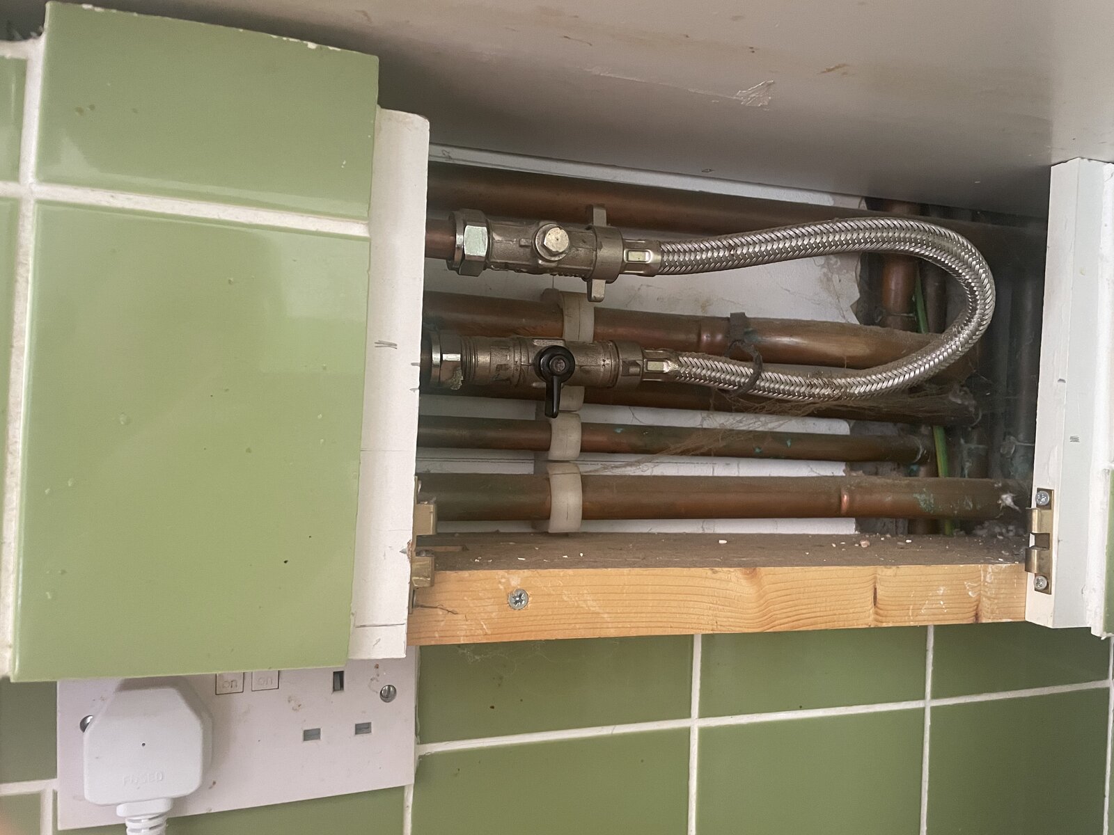

Can you post a photo of the underneath of the boiler, or the filling loop? As for the pressure rising to 0.3 bar after resetting, this is the pressure the pump creates.
Photos. I’ve tried the valve on the hose, which has worked on previous boilers I’ve had. You can hear the water but does nothing for pressure and the overflow outside starts dripping.
The small tube leading to the gauge is almost certainly blocked. You are building pressure, but is not being registered. You are then going over 3 bar, so the PRV opens.
EDIT: just realised that you have an electronic read out, so your sensor has probably failed or leads became detached. The rest of my comment applies
