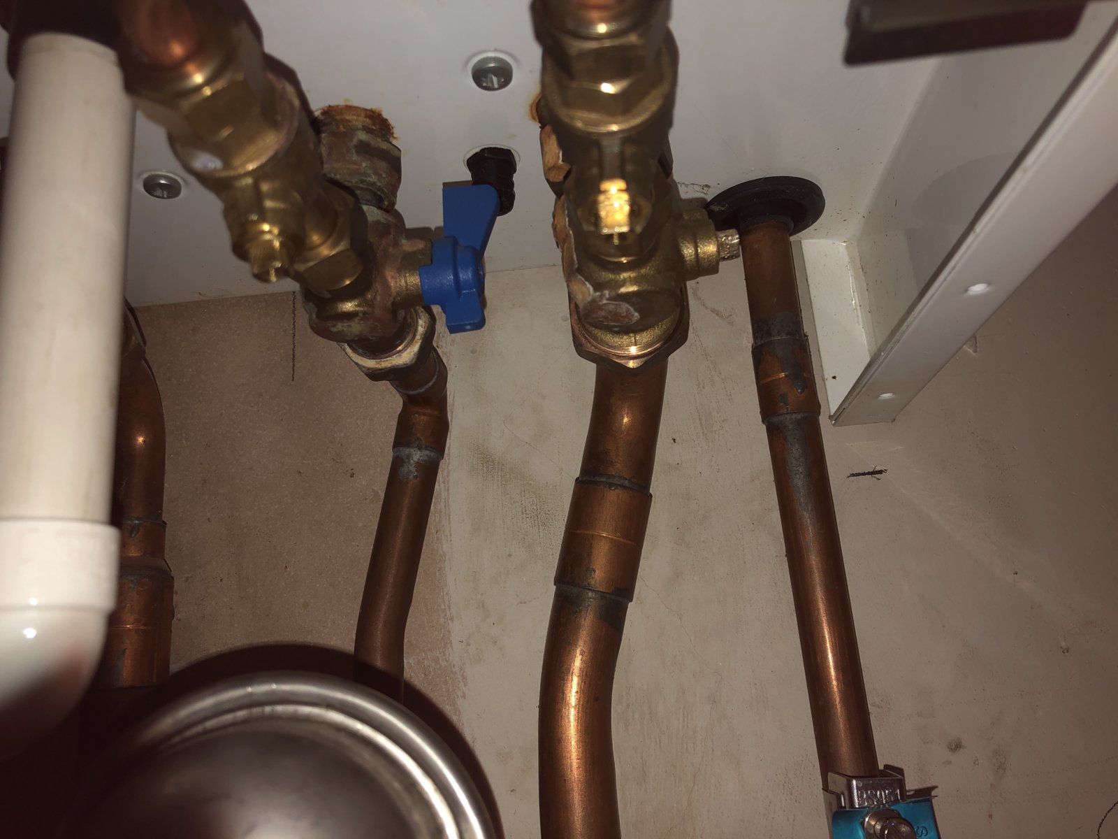

help i Have a logic combi Boiler the pressure was low so with a video call from the land lord was fixed and fine. Then had a lovely warm bath and the shower was used this evening and the presurre is high I tried bleeding rads no joy
Make sure you fully turned off the filling loop ,(when you topped up the pressure earlier ). You can then reduce the pressure / water in the system using radiator bleed screw's ,but it will take quite a bit of time ,as a fair bit of water needs to come out. What is the actual pressure ??
The pressure is at 4 which is scary do I still take pressure / water out a rad until it drops
As much as it takes ( a couple of cups full probably ). I assume your central heating is not on in this weather ,(you don't want hot water coming out the rads )
Your safety valve should have lifted / opened at 3 bar so system shouldn't get to 4 bar. Are you certain the filling loop is closed I suspect it is not. Can you post pics of filling loop ?
No heating on
When I spoke to my land lord last night when he got me to re pressure the boiler there was no Knobs and he got me to turn 3 different points with A spanner
post another pic of the pipes at the right hand side of the boiler that is where the filling link is
They look as if they are off, did you manage to reduce the pressure ?
yes it will take a fair bit of water from the rad to lower the pressure, the pressure shouldnt have got as high as 4 Bar, there is a safety valve set to release at 3 Bar, You should ask your landlord to send an engineer to check it
