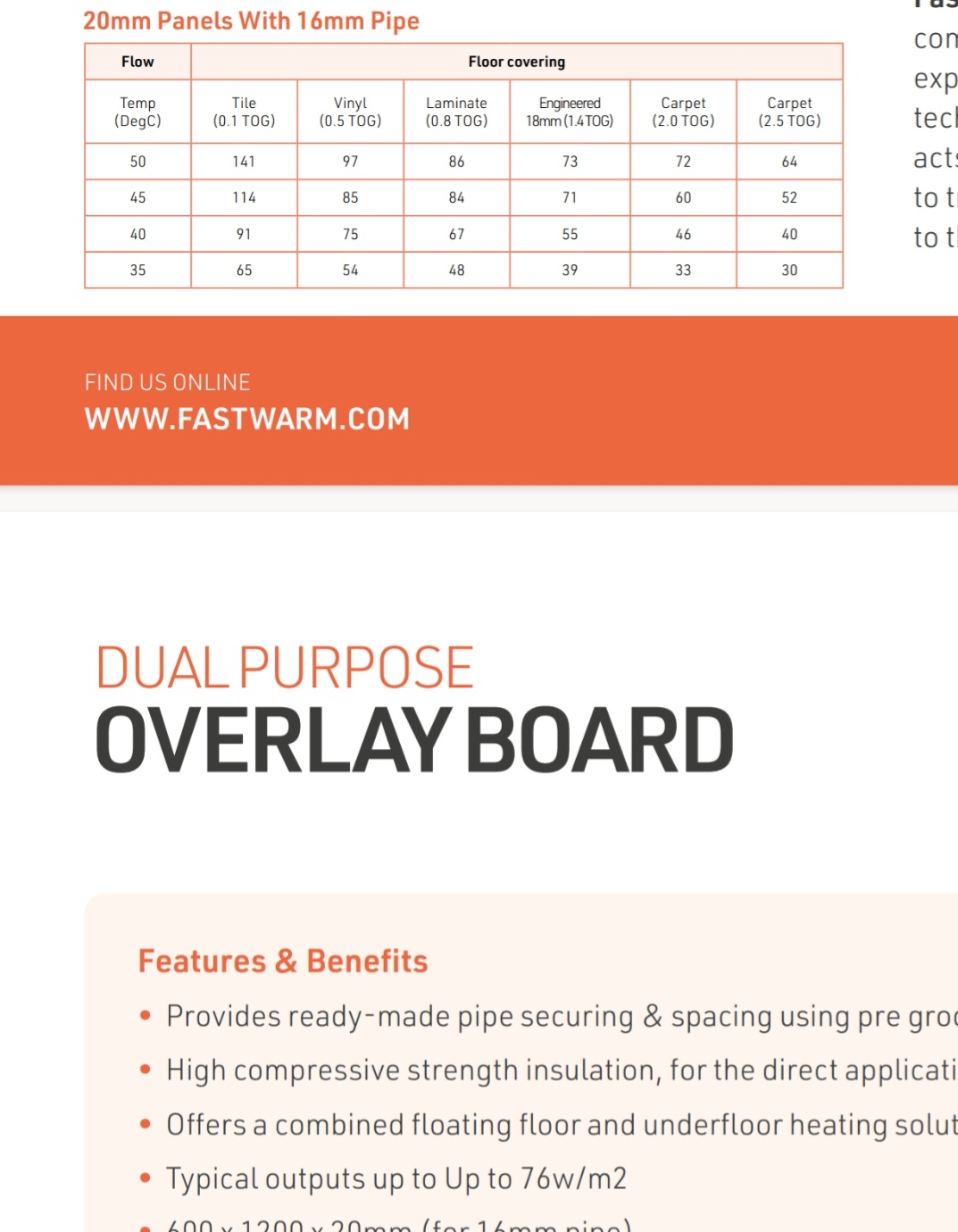

Fastwarm claims typical output is 76w/m2, we'll tiling floor throughout with their 20mm boards and 16mm pipes. They claim you can tile directly on top of their 20mm boards.
Available floor height for buildup in most rooms is only 30-40mm, so not much room for insulation. Was looking at the 6mm insulated tile backer boards to add a bit in though, or maybe 10mm.

Where did you see the fastwarm figures? I'm sure it could output that much but I suspect a high percentage of that heat is lost to the ground unless it's sitting on a substantial insulation bed.
Was on their data sheet, I would take all their figures with a lunch of salt though, yes, I'm sure they are inflated for marketing reasons.
