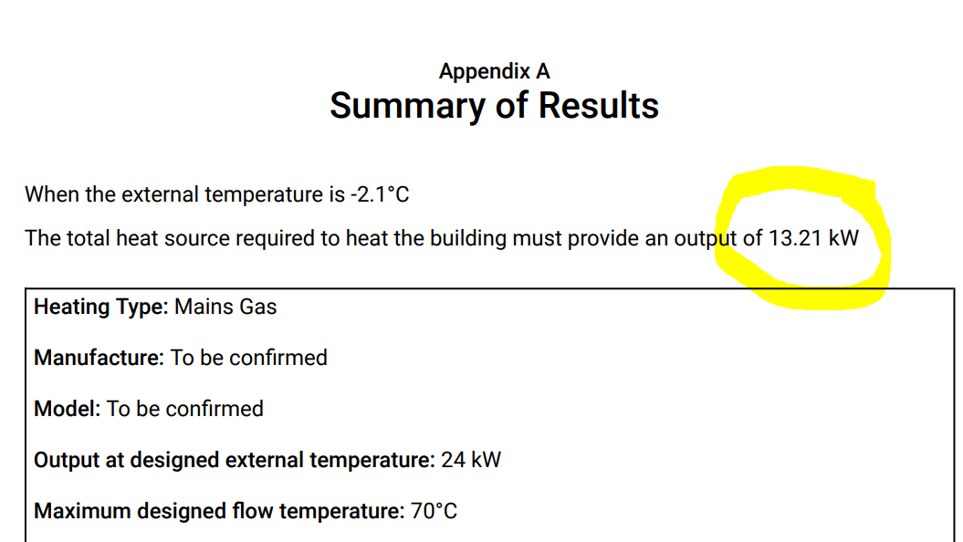

Spent a few hours measuring everything this afternoon and inputted all the data as best I could and it spat out 13.2Kw. Almost exactly what Muggles predicted. I am shocked. Its a large house which is not the most energy efficient and this is at the lower end of the boiler output range for nearly all models.
I dont think it makes a difference to the output figure but i used 45' for the UFH flow temps and 70' for the rads. Is that correct? If so it seemed to indicate the selected rad sizes using the online calculators were correct.
Assuming all the measurements are correctly inputted are there any variables that could throw the calculations out?

It also says output at designed external temperature 24kw.
So is it saying you need a 24kw boiler?
The output at external temperature seems to be a manual input depending on boiler choice. The 13.21kw stays constant
Oh ok.

I don't worry too much about boiler modulation as long as it's above 1:5. Out of interest it's easy with Heat engineer to change the external design temperatures; change it from -3 or -5 to +9 or +10 degrees and see the loss then, that will give you a minimum input in milder weather when you still need heating.

Vulcan - On the basis of 13.2Kw being the requirement that the Heating Engineer software spat out do i just go for a 15Kw model (if 12Kw is the one below) and it just doesnt work to full capacity or an 18Kw version. I dont understand how the efficiency ratio works to select the correct size accross the various manufacturers as i see they dont all do a 13.5Kw unit. I need an output range to work to or do i just go for the nearest size over 13.5Kw?

I wouldn't worry about being over by much, recent test determined for max appliance efficiency a factor of 1 or even 0.75 is best.
The object of the excercise is comfort and although perfect or undersized boilers has best potential heat in to heat into system water, under certain circumstances comfort wasn't achieved in time.
As long as the burn time is longer than 3 minutes the efficiency hit is 1%.
A 20 will modulate to 3.5kW and at 9⁰C outside you'll need more than that.

Yes the WB 4000 15kW or Viessmann 200-W 19kW would be good options. They both modulate well, so they'll not only be efficient on the very coldest days but also on milder days. A heat loss of 13.2kW when it's -3°C outside translates to 6.1kW when it's 9°C outside, as heat loss is a function of the difference between indoor and outdoor temperatures
