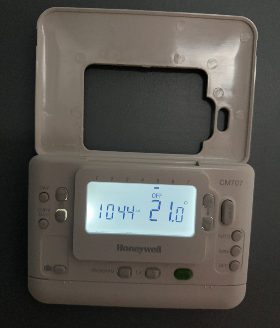

Show us pics of programmer/ timer, thermostats
We have top floor heating with one control panel and bottom floor with a separate panel. Two of these. All normal rads which work fine. No underfloor heating.

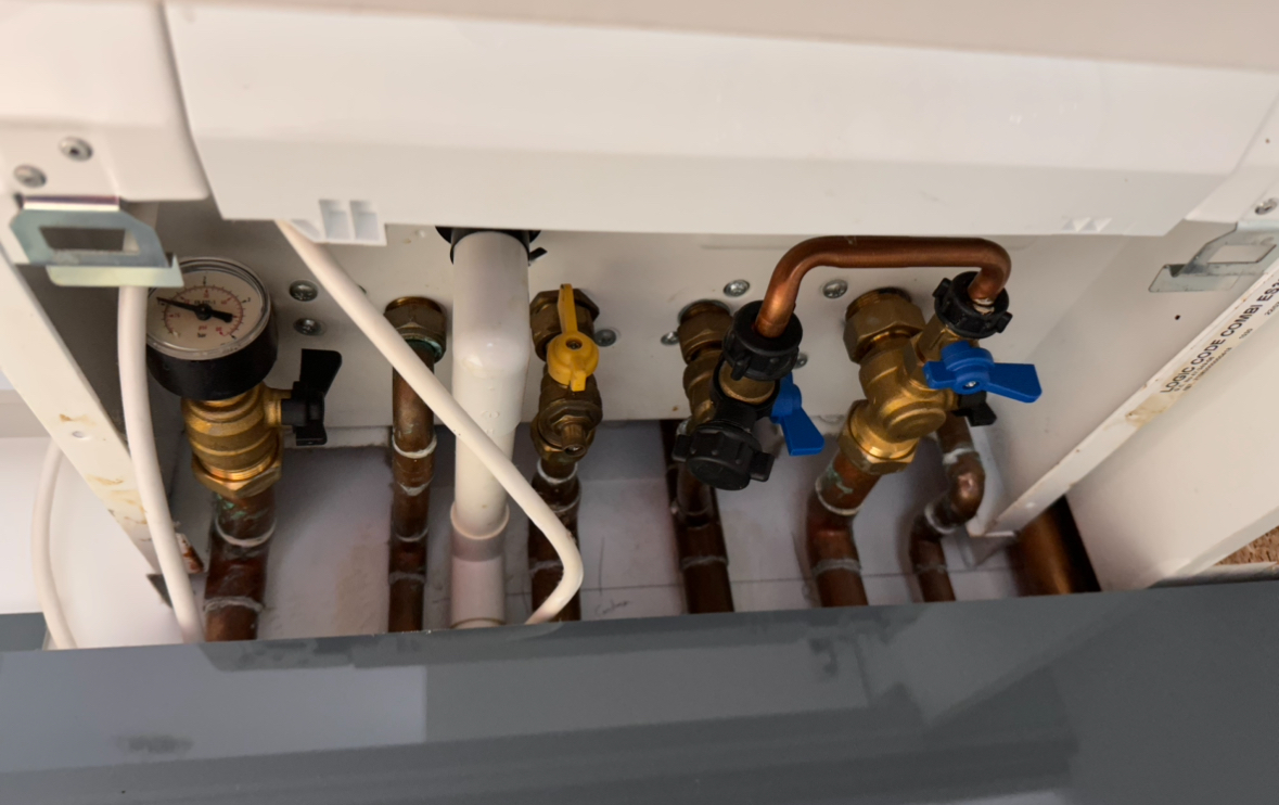

Two themostats (see pic above). This pic is under the boiler. It definitely looks like boiler thinks heating is called for when it isn’t as everything otherwise works fine.

Somewhere on your systems pipework there will be motorised valves. Look like a small box on the pipe ,with electric cable coming from them. One of them is likely faulty.

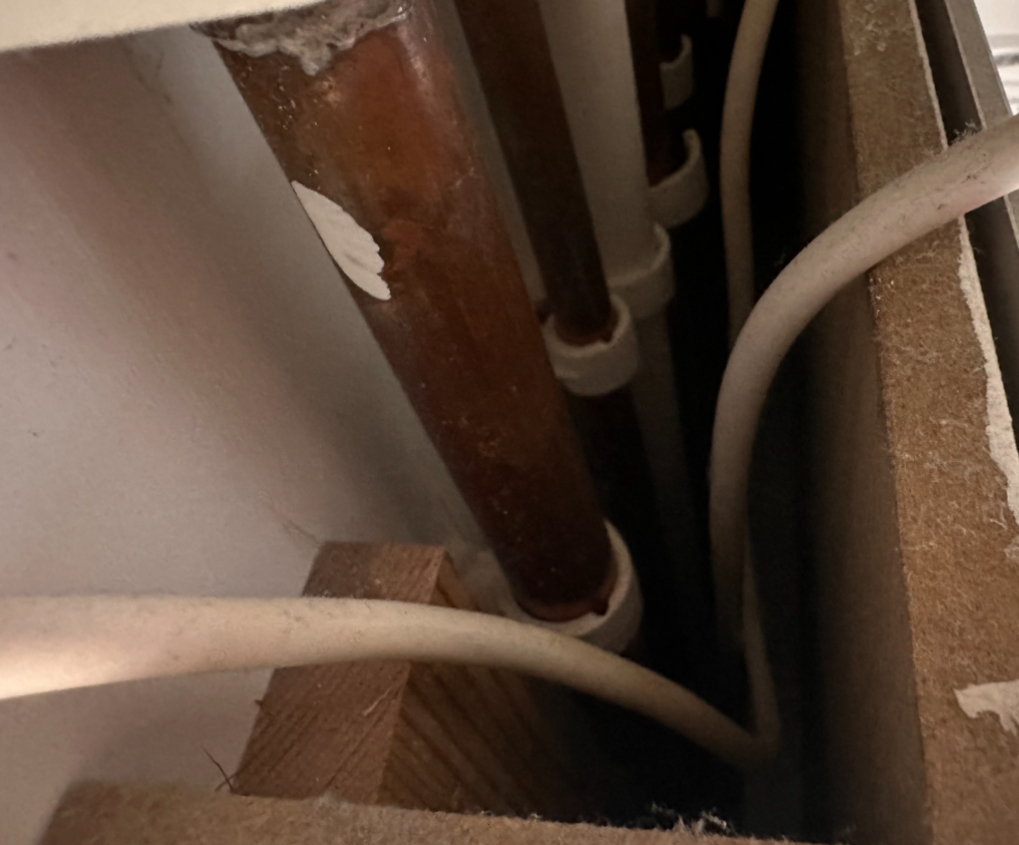

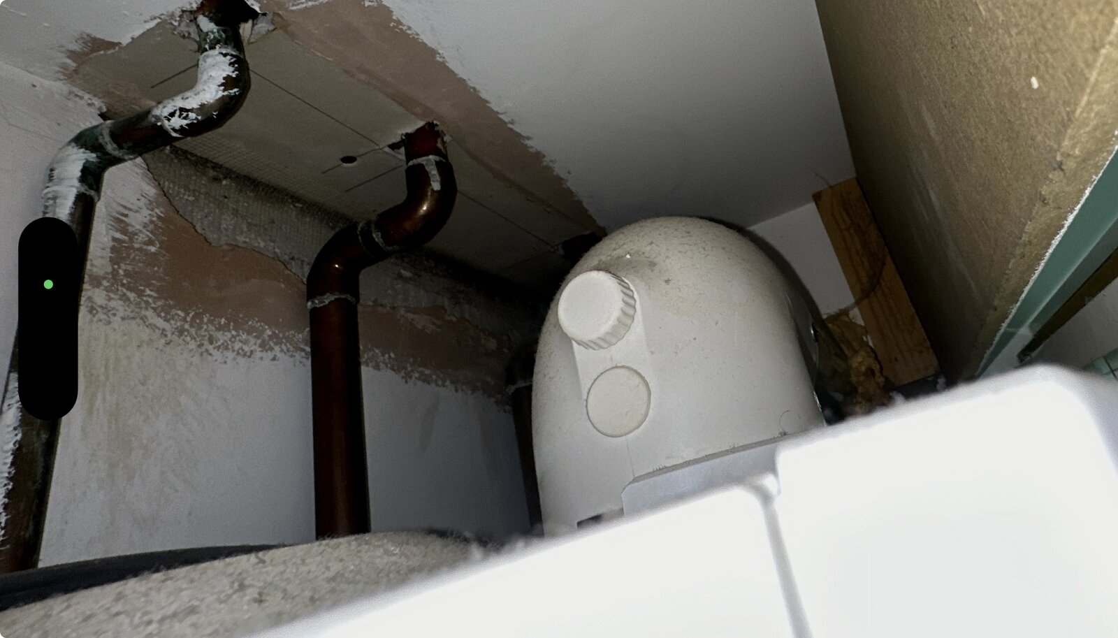

I can’t see any valves at all around the boiler. Top and bottom of boiler there’s nothing. Nothing that looks like a motorised valve. Anywhere else it could be?
