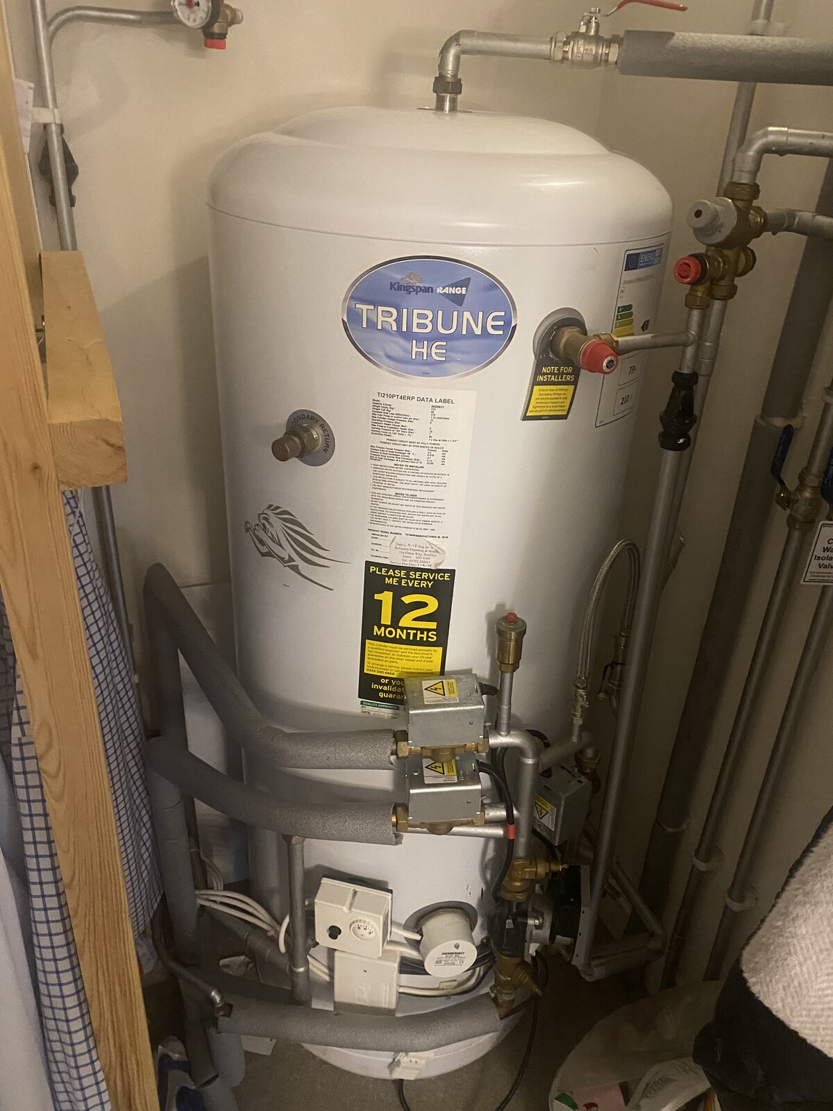

post a pic of your cylinder showing position of the thermostat and the immersion heater(s)
As above if the immersion is at the top it will only heat the top of the tank.

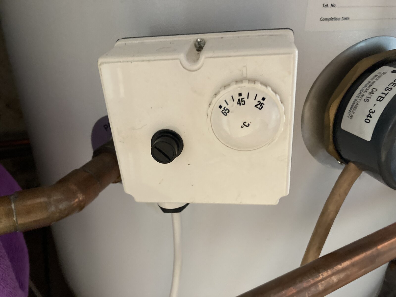

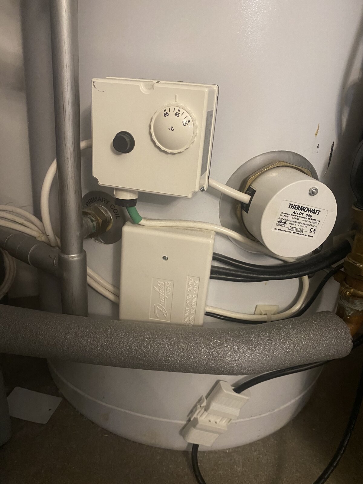

Hi all. Thanks so much for the replies. I have turned the dial at the bottom down to 50 degrees as suggested and I also attach photos of the cylinder. Any further guidance is hugely appreciated

The immersion heater is at the bottom of the cylinder, which should be ideal for your purposes. But you say the amount of hot water is small.
I wonder if there is something draining heat or hot water.
How far is the bathroom from the cylinder?
Experimentally, turn on the immersion heater, with the boiler off, and watch the meter to see how long it runs for before its own thermostat turns it off. A 3kW immersion heater heats water at the rate of about 1 litre per minute (easy to remember) so if your cylinder is, for example, 150 litres, the immersion heater should run for about 150 minutes. If no hot water is being used it will remain hot enough for a bath for several days because the insulation is very good. While it is turned off, feel all the pipes to see if any of them are hot or warm. The pipe coming out of the cylinder will be hot in the vertical section, but should be cool after a couple of feet. The pump should not be running.
I have the same thermostat on my hot water cylinder for the gas heated water and 45° at the bottom of the cylinder would give me VERY hot water so I have mine set at just above 40°.

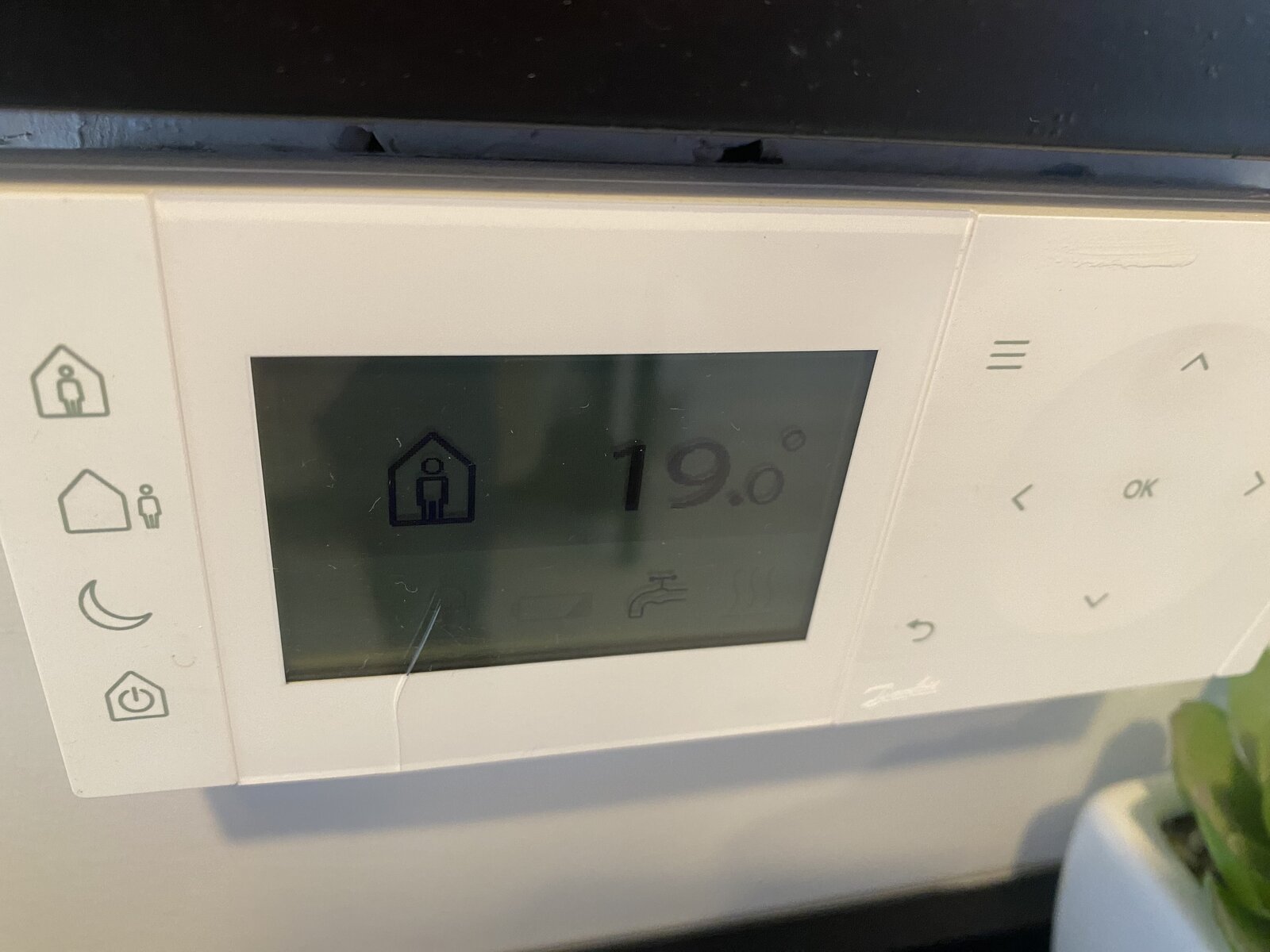

Thanks again for all the replies. It is greatly appreciated. I have followed the advice and done some more experimenting this morning but got the same result again. To clarify, I ran the immersion overnight to heat the tank up and that worked fine. Then, just to be sure that the water was up to temperature I switched the immersion on again this morning. I heard it kicking in and also felt the tank and pipes were very hot. The immersion was only on for a short while (maybe less than 20 minutes because the water was already hot from being heated last night). I then set the gas boiler timer to come on a few minutes later and would have expected the boiler to recognise that the hot water cylinder is already full of hot water and not need to come on. But the boiler did come on at the set time and was on for maybe 20 minutes or so. I had set the boiler timer for 1 hour to see how long it would stay heating the water. The boiler itself went off after approx 20 minutes and stopped firing at that point. However, the thermostat still has the tap symbol showing. Why is this? Is this just indicating that the water heat timer is still active? Or is it indicating that water heating is in progress? Sorry for all the questions. I am at a loss to understand why the gas boiler would need to come on at all if the water has just been heated up fully by the immersion. I've attached a photo below of the boiler timer/thermostat where it has a tap symbol showing now that the boiler has gone off.

I think the tap signal shows for the whole programmed time, the cylinder stat determines how long the boiler actually fires for, the display may show a flame symbol for this when the boiler is actually firing.

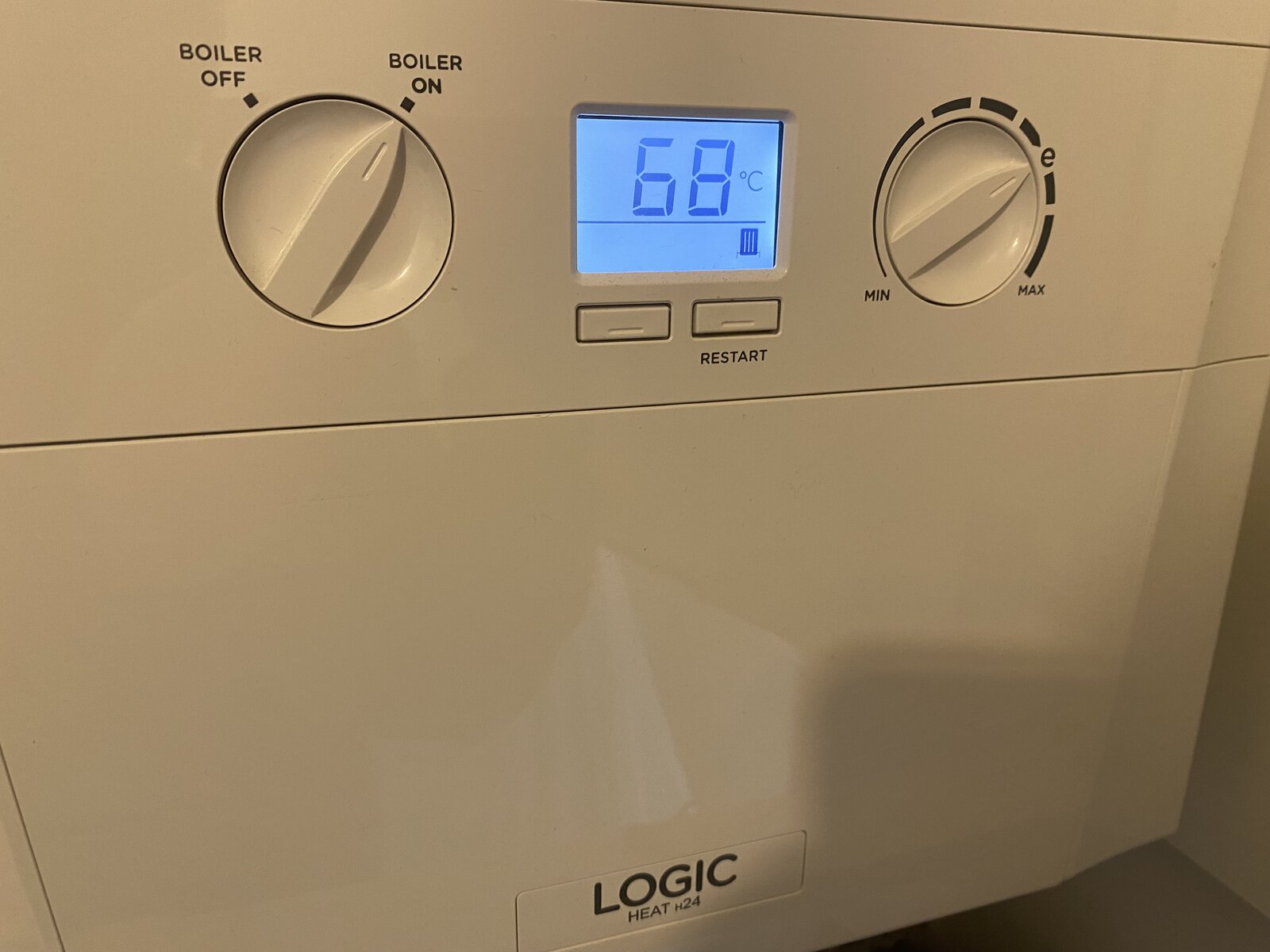

What is the boiler flow temperature set to, if its set below the cylinder stat set point then the boiler will keep firing on/off just to keep itself warm as the cylinder stat will never be satisfied, however as you have now set it to 50C then the boiler set point would have to be as low as 50C or lower. Does your boilrer use outside te mperature compensation for its CH??.

Many thabks for the input. Much appreciated. The clarification about the tap symbol is very helpful. I had misunderstood that to mean that the water was actually being heated. But it seems to just indicate that the timer period for hot water is still active. Even though the boiler is off. So that part is all clear and understood and seems to be working ok.
The boiler flow is set to the economy setting which when I turn the dial indicates 68 degrees. Which seems high for an ‘E’ setting?
But it is set above the cylinder stat set point.
And I don’t believe the boiler has any link to outside temperature.
A boiler temp of 68C with a former cylinder stat setting of 65C may have resulted in the boiler continuing to fire on/off because that cylinder stat seems to be located just above the coil return. It is probably best not to set the cylinder stat higher than 58C/60C.
To check if the flame signal is present when the boiler fires just briefly turn up the cylinder stat setting to max with the boiler heating period programmed on.
Super helpful Johntheo5. Thankyou. Please can i just clarify the last sentence and what i need to do and what i am looking for when i do it please?
I think you have reduced the cylinder stat setting to 50C now?, if so, increase it to is max of 65C and see if boiler fires up with a flame signal as well as the rad symbol on the front, what make/model of boiler?
