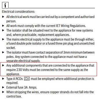

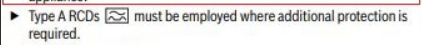

Note some boilers have a requirement for a type A RCD, not a clue why, Worcester Power.jpg but I would assume some think in the boiler can allow DC to be injected, but since I do not work inside a boiler all I know is what the instructions say.
Only where additional protection is required; would that be?
This could be for TT supplies only, where you rely on the RCD, or it could be talking about general under 50 mm deep and use of sockets etc. It would be nice if it did say why.
Personally all my RCBO's are type AC and the supply is TN-C-S so the RCD protection is secondary protection, so not worried about changing all the RCBO's I read the packet when they were fitted which said type B it was not until latter I noted the logo.
However the point is if the instructions say type A and some one comes to fit boiler and says sorry you have wrong type of RCD can't connect it, one could not say he was wrong. One may feel he is being pedantic, but that does not make him wrong wanting type A protection.
