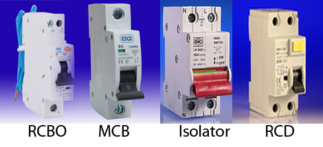

On the main board i have multiple breakers, one for each "ring".. i call them RCD's, they could very well be MCB's.

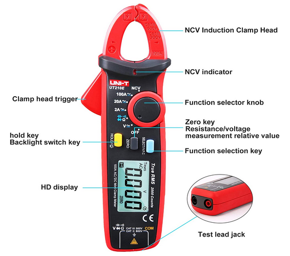

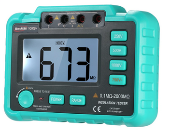

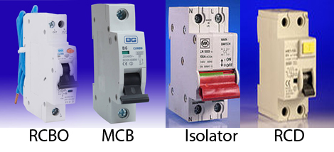

RCD faults are often a problem to find, I will normally use an insulation tester on the 250 volt range, I would not use on 500 volt as it could damage things in the boiler, I use one of these 1663878907252.pngand one of these 1663879017972.png to test to find the fault. In the CU you have these PartID_CU.jpg the RCBO and RCD have a test button, the other two don't.
Often the RCD trips due to neutral to earth faults which can be made worse as the load increases, but the amount one can test without some test equipment is limited, and as an electrician I would always use the test gear, although unplugging things can help I want to know why so it will not happen again.
