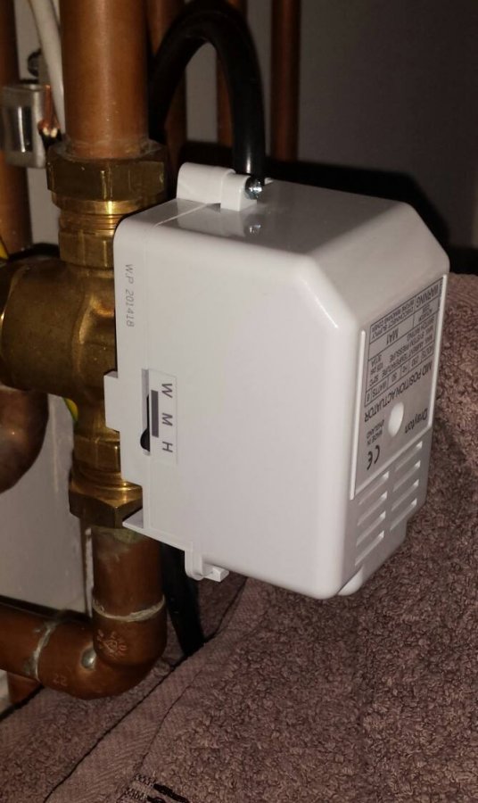

I have one of these in my airing cupboard (picture attached, hopefully) which was checked and working fine when the guys were here? Is that what you meant?

That sort of 3 port valve will at least make it easier to see what the controls are telling the boiler to do. Next time you have problems start by making a note of the position of that valve and try to decide if it is what you would expect?
For Heating only it should be at "H", for hot Water only at "W" and if both are required together it should be in the Middle position.

as per my last post and after seeing your new photo you have a Y plan system and not an S plan, I would still suggest that you have an external control fault, your boiler is a very simple but very reliable boiler and not much goes wrong with them, fans and sometimes gas valves but not a lot else and neither of these would cause the problem that you have , do you have an external frost stat by any chance ?
