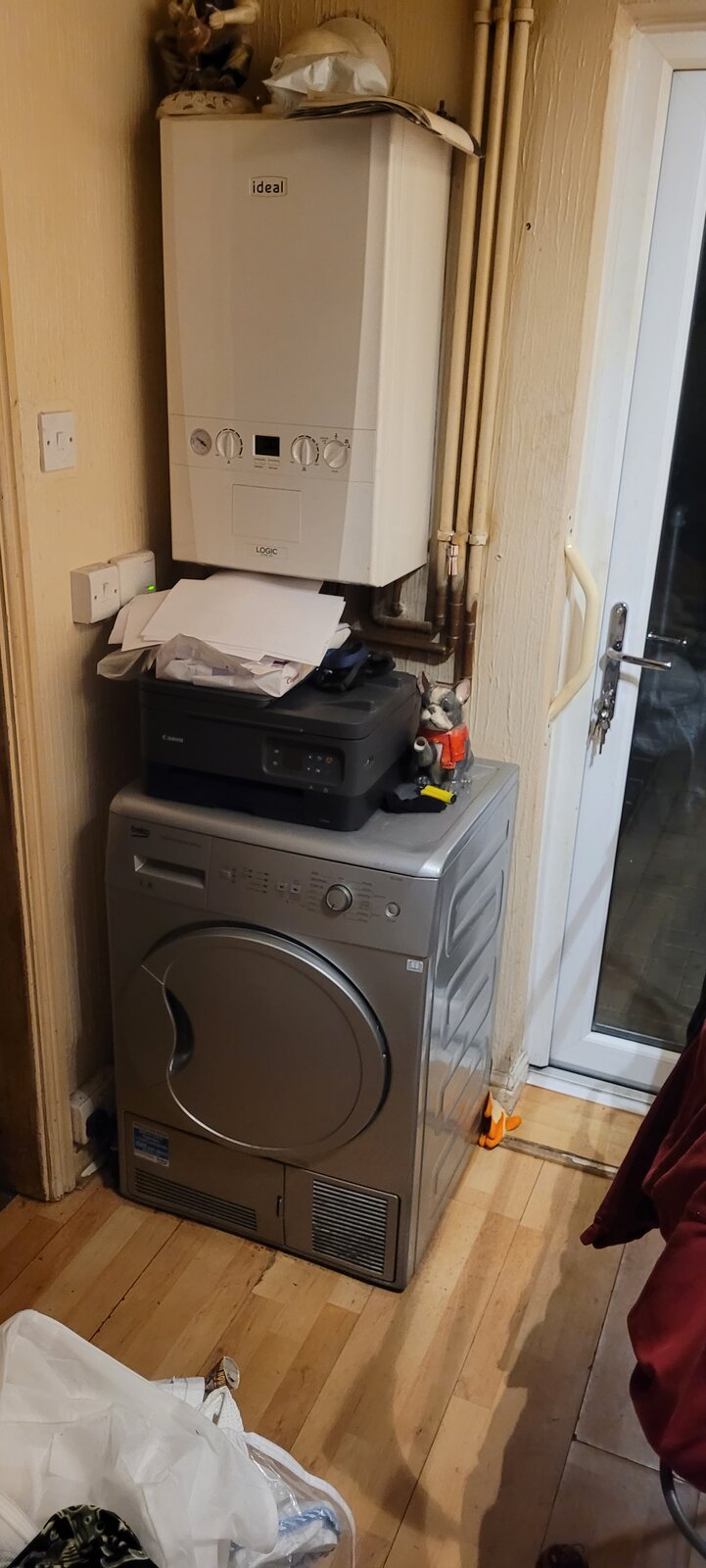

OK, just want to check I am doing right.
I have a front room that is in the process of renovation it is now front to back as removed a dividing stud partition.
In what used to be called the dining room is a 2 year old Ideal combi boiler on the back wall with the flue exiting the back wall
I am going to build a stud walked cupboard around this boiler floor to ceiling as is in corner of room with a 78x19 open louvre door.
Is that louvre door enough or should I add a top aluminium vent about 600mm wide that will sit above flue location.
Photo added, the tumble dryer is to be removed btw
Thank you
The MI's will provide this information. In the Ideal Logic manual you can see here, 1.8 Air Supply and 1.14 Boiler Dimensions, Services and Clearances state the requirements. These may not be the correct instructions for your Ideal Logic. So, if they aren't then you should be able to find the MI's for yours on line.
If you look up the boiler instructions it will give any ventilation / clearance requirements,if you don’t have the book it’s available online
Lovin' the use of space, although disappointed that you haven't got any paperwork jammed between the flow and return pipes. :mrgreen:
(y)
Yeah only place for the printer at the moment whilst room is being done, in time I'll get a two drawer cabinet for it but must get the media wall finished first
