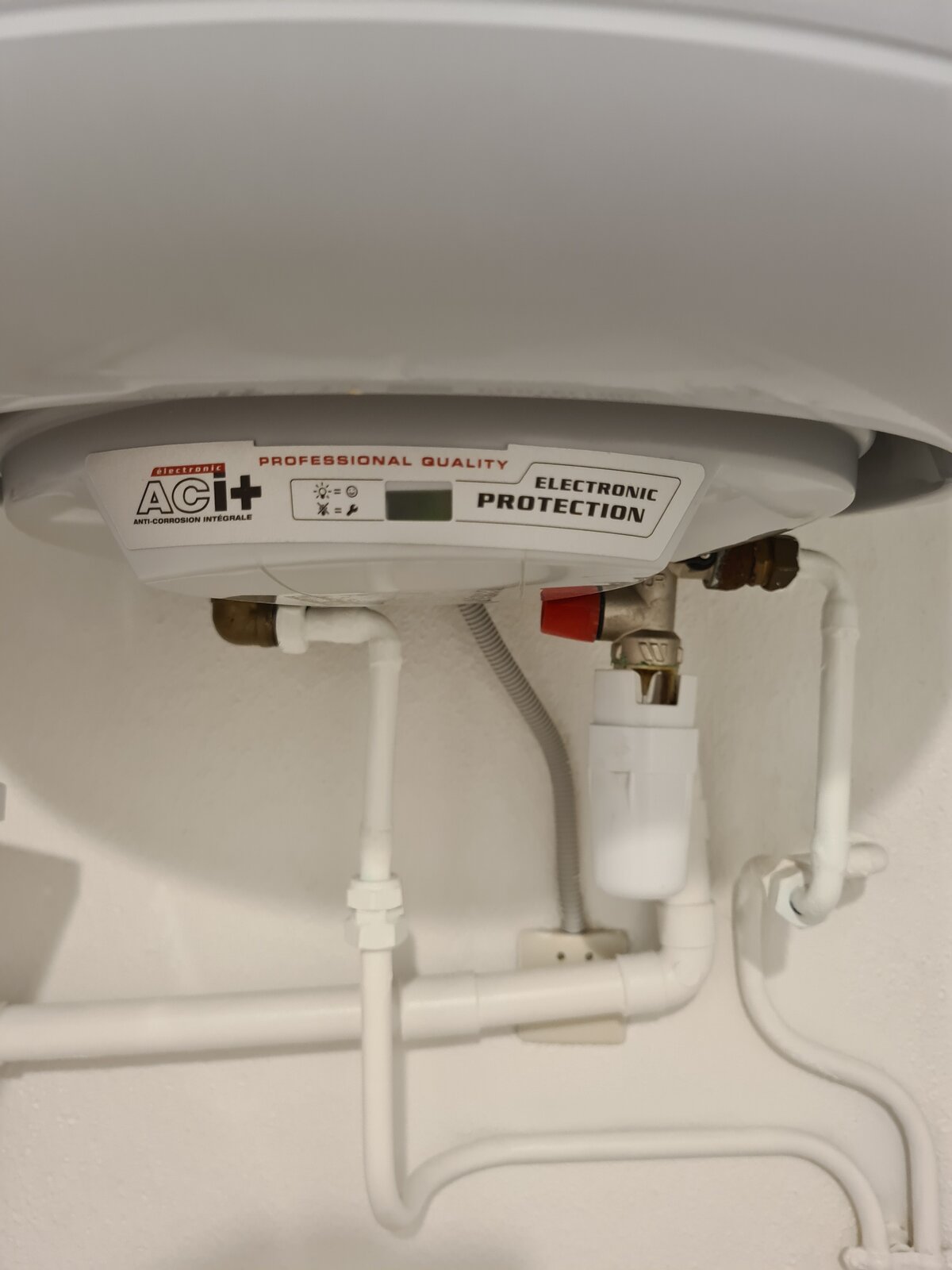

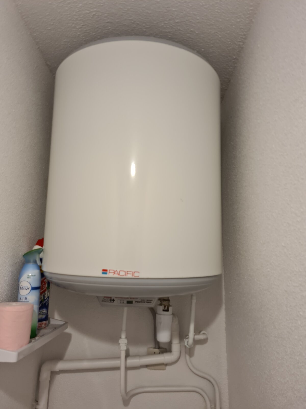

Hi,
Got this water tank in the holiday home in France and water gone cold.
Checked all fuse but still cold
Have switch all the electrics but water tank green light still green.
Anything else to check before to call local plumber?
What source is used to heat it up?
Not familiar with the make Pacific but looks like a Tesy, isolate the power and drop the lower panel where the electric cable enters you will see the immersion element, it will have a manual reset overheat cut out, that may have tripped and you simply press it back in, if you are not sure ,post a pic of the element when you drop the cover
Mine has a battery backup for the anode anti corrosion so just because a lights on it doesn't mean mains power is getting through
