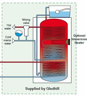

My daughter has a Boilermate 2000. She complains that the hot water is far too hot. I would appreciate advice as to what are the most likely causes? She lives some 200 miles from me so it is not often that I make the trip. I do have a saved copy of the Boilermate 2000 Installation & Service manual which I downloaded and I see that it makes reference to a DHW sensor.
The Boilermate thermal store maintains a supply of very hot water that is used to heat the domestic hot water. Control of the temperature is usually achieved via a 'mixing valve' that blends the hot water with cold water to reduce the temperature of the water reaching the taps. The mixing valve can be adjusted to give different temperatures.
The mixing valve will look something like this, it may have a green or white cap that is removed to allow adjustment.
Take a suitable thermometer and measure the hot water temperature on a bath tap,if no thermostatic mixing valve (tmv) is fitted (pic above,ta stem) then it should be 55 degree C.
If a thermostatic mixing valve is fitted it can be adjusted or replaced :idea:. If no tmv and the user wants lower hw temperature a tmv can be fitted.
Check if the switch heating element if fitted (240v hw & heating back up unit) , is not turned on. If its on it can produce hot water up to 70 degree C (n) If no tmv is fitted.
Could be a sensor fault but the above need checking first,does your daughter have any insurance for the hot water system (appliance insurance is sometimes bundled in with other insurance,worth a check) :idea:
I may be mistaken but my understanding is that the hand adjusted mixing valve you refer to is fitted to the modern Gledhill Thermal Store but not to the older Boilermate 2000. This has, I believe, a thermostatic sensor which operates electrically. So, thanks for your responses, but I would appreciate input from someone who has Boilermate 2000 experience.

Buy a thermometer TPI 312C or similar post it to your daughter and ask your daughter to check the bath flow temperature and obtain an average temperature over 3 days.
On site investigation is required,every system is different (n)
