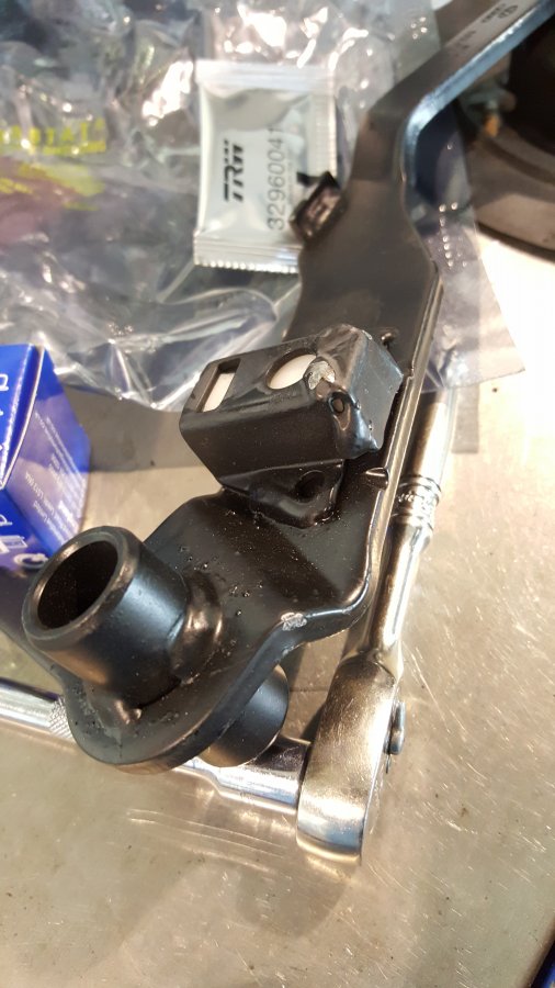

Ok, correct me if I'm wrong but you have not fitted a new or repaired/welded clutch pedal?? The only reason that black clip breaks off is when the clutch master cylinder rod pushes the white clip through the end of the clutch pedal! There is a bent over & tac'ed on plate that breaks off.
If all you have holding the white clip & clutch master cylinder rod back then it will fail very soon indeed!

This is how the clutch pedal should look when repaired, notice the end plate that's been welded back on.
Was the master cylinder rod on you're pedal not pushed through the end of the pedal cap?

This is what I'm not understanding, in my pic you will see the piece of metal that should be there to stop the rod! A new pedal from VW is less than £30, if/when you change it be careful not to loose the round spacers that live in the cylindrical part where the bolt goes through, pedal will wobble without them!

This is the thing, it's not a different setup! A Bora identical to a Golf, I have owned & repaired Golf's for a long time, had a MK4 which is the platform we are talking here for 12 years, the black plastic clip is the shoe contact for the clutch switch & nothing else.
What's happened is the metal end plate has blown off & been thrown away! You need a new pedal, the white nylon clip & the black plastic clip might retain the master cylinder rod for a short time but not long.
I'll post a better pic in a min mate :)
Here is a pic of the end plate of the box section that the clutch master cylinder rod lives in!
