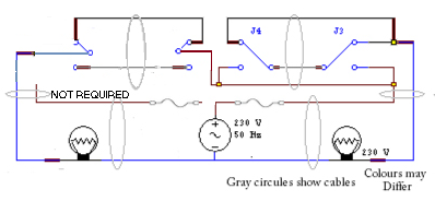

This is how I would show shared lines, very dangerous as although it will work without having a RCD, the left hand light has two major faults, so shown light is off, switch the left hand switch and all is OK, however if instead right hand switch for left hand light is used then left hand light fed from right hand lamps fuse, and if both switched then lights remain off but the two circuits are connected together.
If a pair of RCD's are added then clearly it will trip them. I wonder if a video can be re-done? He seems to be using what I call a school boy two way switching,
although it will work, it would likely cause interference as it is a large loop, and not easy to in practice wire.

View attachment 181726 This is how I would show shared lines,
Why? That is not the usual situation.
Don't wire it like that, then. You have just included an additional fused line for no reason.
Are you saying you have made a dangerous circuit just to avoid interference?
Of course, The circuits will have to be separated if you want two circuits And two RCDs.

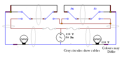

He seems to be using what I call a school boy two way switching, View attachment 181727 although it will work, it would likely cause interference as it is a large loop, and not easy to in practice wire.
It is known as the 'conventional method' for some reason.
It is the adding of the two-way system which causes the borrowed neutral situation, as JW says.
Obviously alterations have to be made to bring it up to modern methods - hence the name 'conversion method'.
I thought that the term "conversion method" arose because it provided a fairly easy way of 'converting' one-way twitching to two-way, rather than because it was 'bringing things up to modern methods'?
I have to say that I only became aware of 'the modern method' relatively late in life, and for decades had been using the old ('conventional') method of 2-way switching, probably as recently as within the last 20 years.

as shown here, I used this diagram to make the one showing dangerous method as that is what I have found over the years has been the way the circuits have been split.
Originally one can often see how the borrowed line would have been OK, however I agree with @JohnW2
not the least so as to avoid the 'radiation' problems associated with 'unbalanced cables'.
the use of twin and earth clearly has a problem with EMC, but it would have been one circuit for all lights, and the circuit I have shown in first post would be OK if only one fuse feeding both sides.
It is where at a latter date, some one has decided it would be better if upper and lower floors were split, and often there were two cables in the fuse box, one going up and one for ground floor, so easy job to split and so increase the current that could be used for lights, often found required when down lighters added.
I found in the early years you would have two reels of cable for lighting, one red and black, and one twin reds, and the boss rarely supplied one with red, yellow and blue so one would need to run two twin reds to do two way switching if you did not borrow a line. I also found twin reds a PITA as one had to work out which was which, far easier with red and black.
The bringing line into the com was not liked, as it often needed a connector block in the switch.
I have put grey circles around each cable, and brown box with yellow centre to show connector block, which was why the other method was used in this area, as did not require those connector blocks.
I find it interesting that the connector block method was used in other areas of the country, and it does make more sense for John Ward to show that method if that is how it was done down South where he lives.

The first time I came across the 'conversion method' it was this:
with a wire nut behind the switch, it didn't work.
thinking it was wired wrong I did this:
by adding another join it worked OK, no idea why it didn't work initially, but that is how it was left for more than 20 years.
