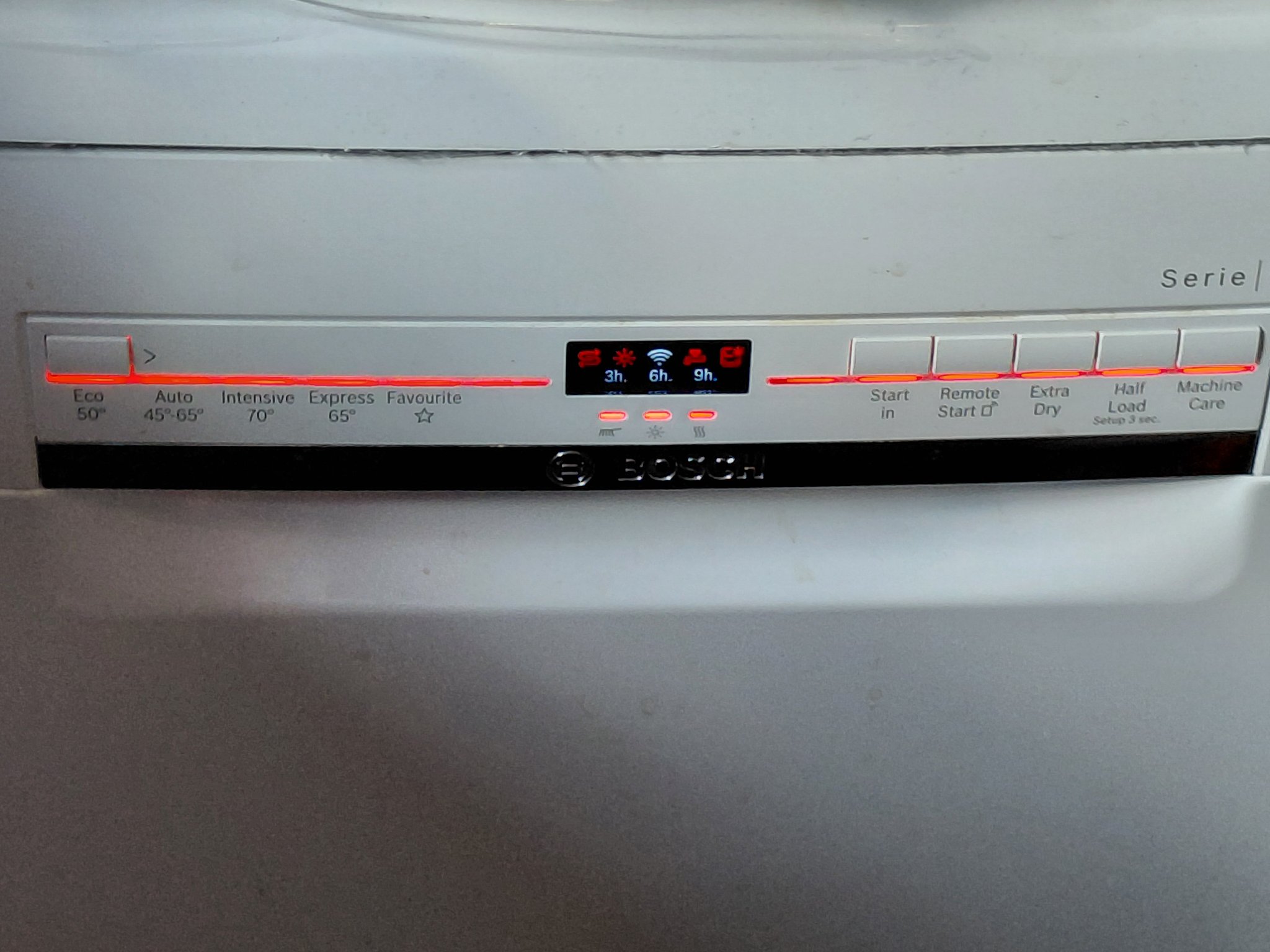

Bosch Dishwasher, all lights on

Presumably it's in pain?
What might it be?
None flashing.
I left it powered off at the wall, but got the same after.
Did the problem arise after a wash cycle, John?
A rudimentary search on google suggests water may have reached the PCB.
You could try holding the start button for 3-5 seconds, while the PCB is on and all lights are illuminated.
Failing that, try having a look at the PCB for any water ingress.
I don't think so
I unpacked it today, put some dirty stuff in, pressed the on button and it lit up. The door had been slightly ajar for airing after Saturday's wash.

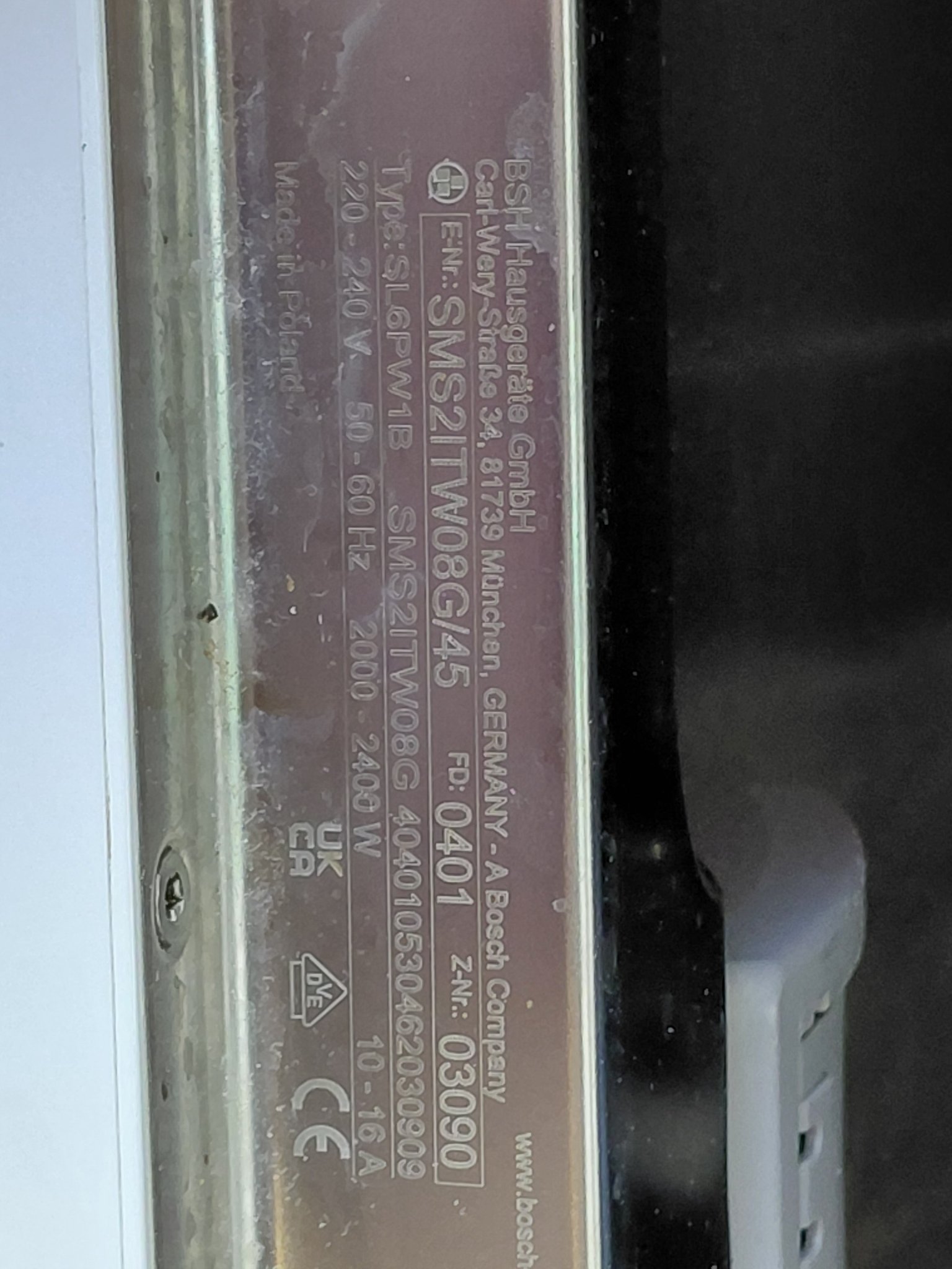

FD 04/01
I don't think it's very old.
January 2024, is that?
Edit
Yes, it was bought in Feb 2024
It was working after being disconnected overnight.
FD 04/01
Edit
