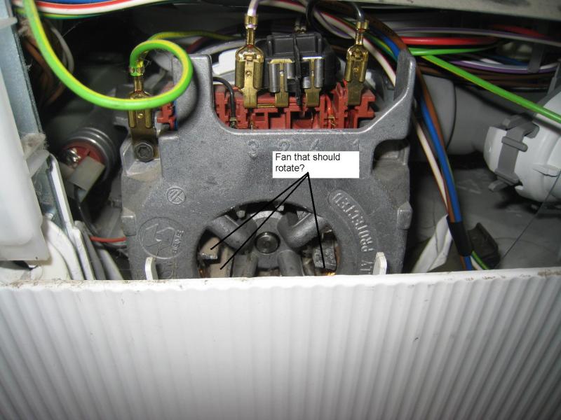

If you look in the end of the circulation pump you can see a fan blade, this will rotate when the pump is running.
If the pump is not running but is making a humming noise or getting warm then it could be the motor capacitor has gone low in value.
I can't see anything turning in there but I can't make out anything that looks like a fan blade either!
It is humming & getting warm and definitely has 240V across it!
Where is the capacitor and does it need the motor to be removed?
Thanks....
the fan is blade can just be seen looking in the back of the motor through one of the chassis holes, looks like an aluminium plate with small pieces sticking straight out.
The capacitor is usually mounted on the left hand side of the circ pump motor and is usually a 6 to 8 micro farad cap.
If the fan is what I'm pointing to here I thought it was part of the motor case. It seems like part of it when I try and spin it by pushing it round with a screwdriver.
I guess if it's stuck that hard then the pump is stuffed?
