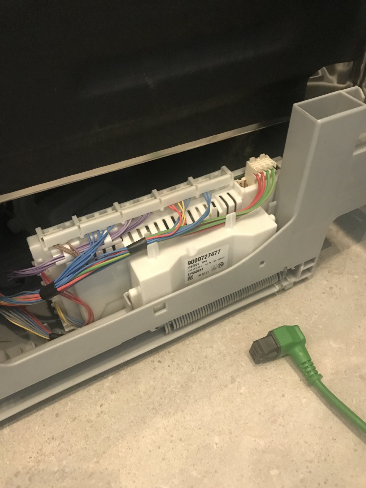

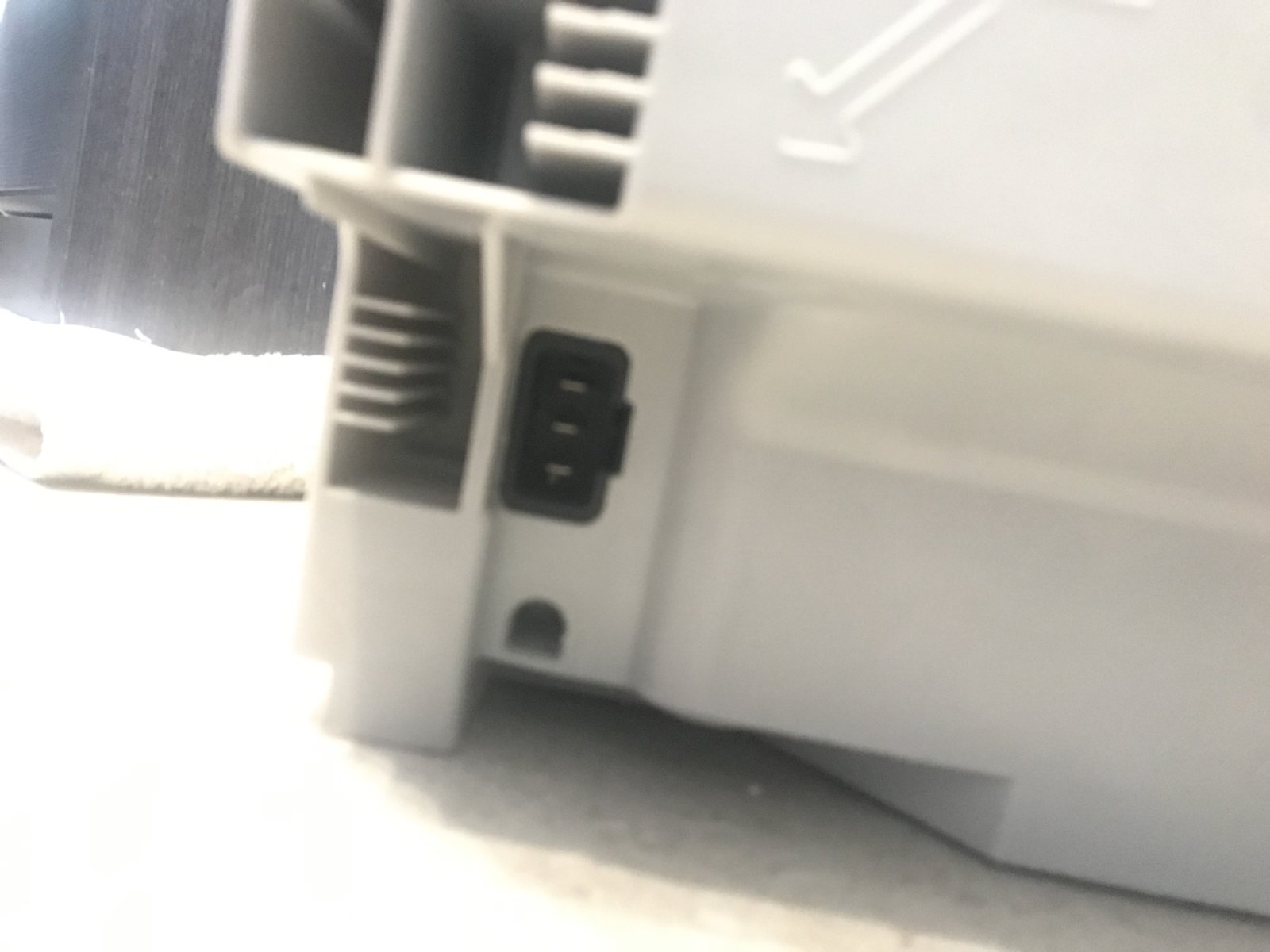

My integrated Bosch SMV69T20GB Dishwasher is not powering on. I've checked the connecting power via a multimeter (green cable) and it is receiving correctly so must be something internal. So far I can not see or locate any internal fuse so can only assume that it must be a fault with the main control panel?
Does anyone know how I could check this unit prior to ordering a replacement?

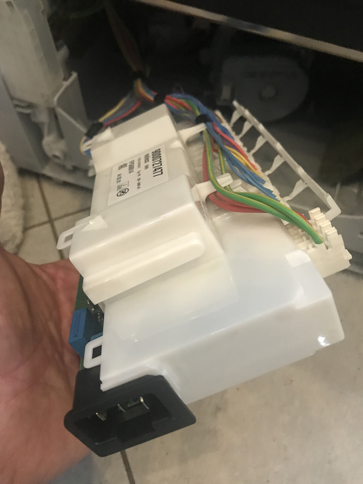

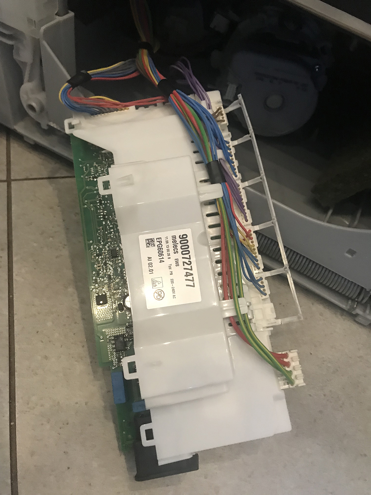

If you take the pcb out of the box and look very carefully, sometimes you can see some fried components. Usually a resistor and a mini transformer chip.
Hello mate and thanks for the input. Greatly appreciated. I've just done that and everything seems in tact. Unfortunately for me I took a punt and have ordered a replacement of that part. I suppose if its unopened I could return.
Any other suggests as to what I should be checking? I can only think of looking around the control panel where any indications of life would usually be displayed..?
Thanks.
I've just had a good look over the full unit and anything electrical visually appears to be in check. :(
Dam, just replaced the main board pictured above. Thought everything was working again as the unit powered up and the control panel lit. Went to program a wash and as soon as a button was pressed the unit failed again :( Boo.
