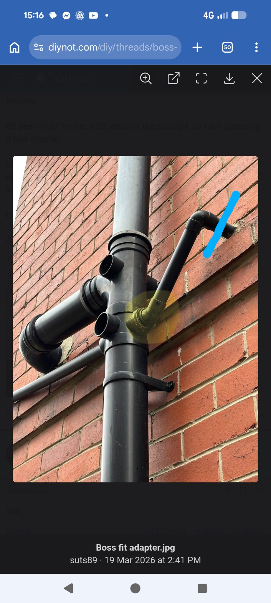

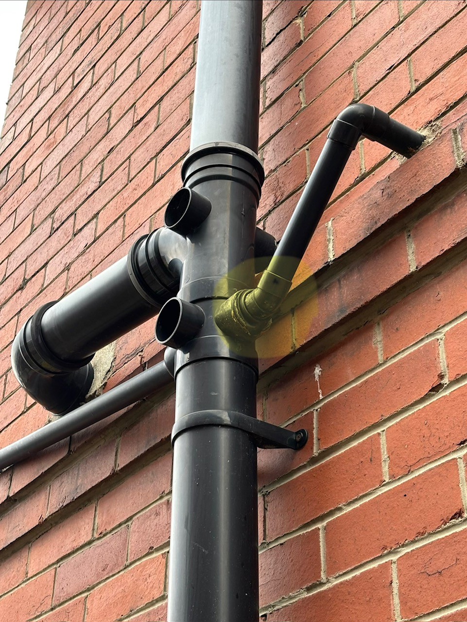

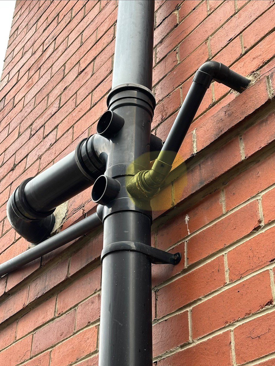

I have a boss adaptor as highlighted in the picture which is leaking.
Its been their for circa 20 years in the sunlight so I am guessing it has shrunk.
My main concern when I come to replace it is that the pipework entering is all solvent welded and i don't want to damage any of it.
Do you think i will have enough play to "yank" it out ?
Cheers

Try, (gently!) and see if enough wiggle room, if not, cut (carefully!) as above. Is it the Rubber type of Boss Adaptor? I cant tell from the pic, but if it's the solvent welded type with a socket to accept the waste pipe, then you wont remove the Adaptor!
