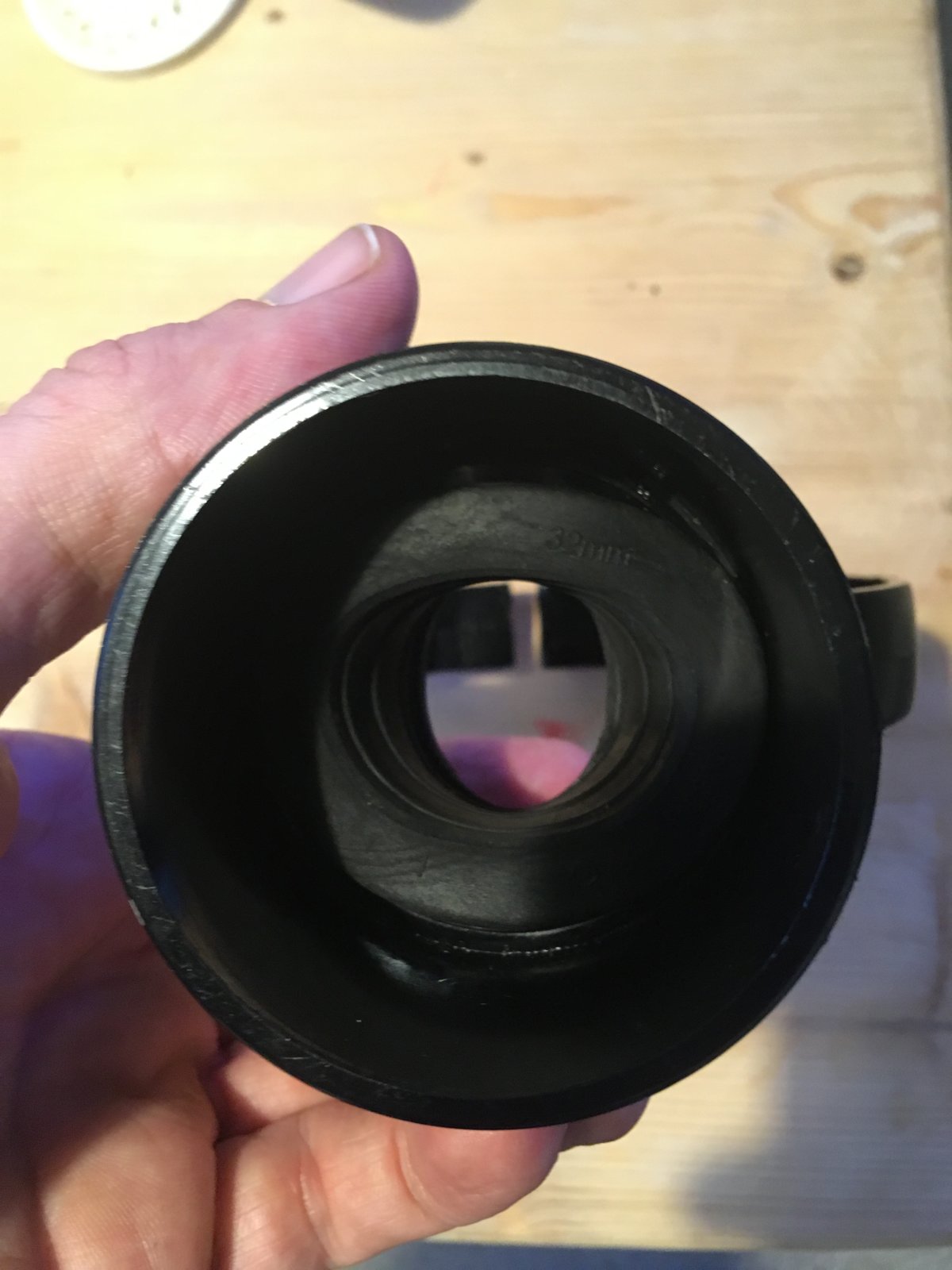

Yesterday I bought a Floplast strap boss and 32mm adaptor to fit a waste pipe into my soil pipe.
The issue I have got is that the rubber adaptor is to small to fit in the outer edge of the opening, and when I fit it into the opening where it fits into the soil pipe, the 32mm pipe won’t go through it with all the fairy liquid in our kitchen? Have I got the wrong adaptor?? Should it fit on the outer edge of the boss? I’ll try and post pictures of what I mean if that will help. Thanks in advance!!

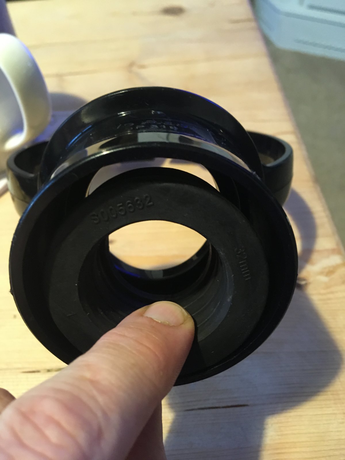

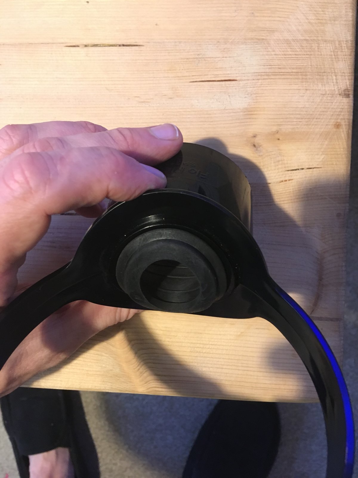

CA944A96-E472-45C9-A155-2BE538949DF4.jpeg 687C2DD6-94C4-46B3-B7E1-25C021088876.jpeg 225624B2-4B63-4BBA-8626-057774FBAFC9.jpeg So, here are some pictures showing the adaptor too small to fit on the outside of the inlet, and then the adaptor pushed into the inside of the inlet but no chance ‘I think’ of a 32mm pipe fitting through.... any advice?? Have I got the wrong pieces?
The rubber bit is a Marley one. If the boss is Floplast you will need to get a rubber adapter to match.
Brilliant... Thankyou. Wickes has done me again... both were in the same basket... so I naturally assumed they were compatible parts... that’ll teach me to assume..
Could even be an internal flush pipe connector.

You'll be better off getting a solvent weld adaptor for that boss and the pipe that inserts into it. You'll need the solvent cement for securing the strap-on to the 4" anyway... To make a proper watertight seal.
