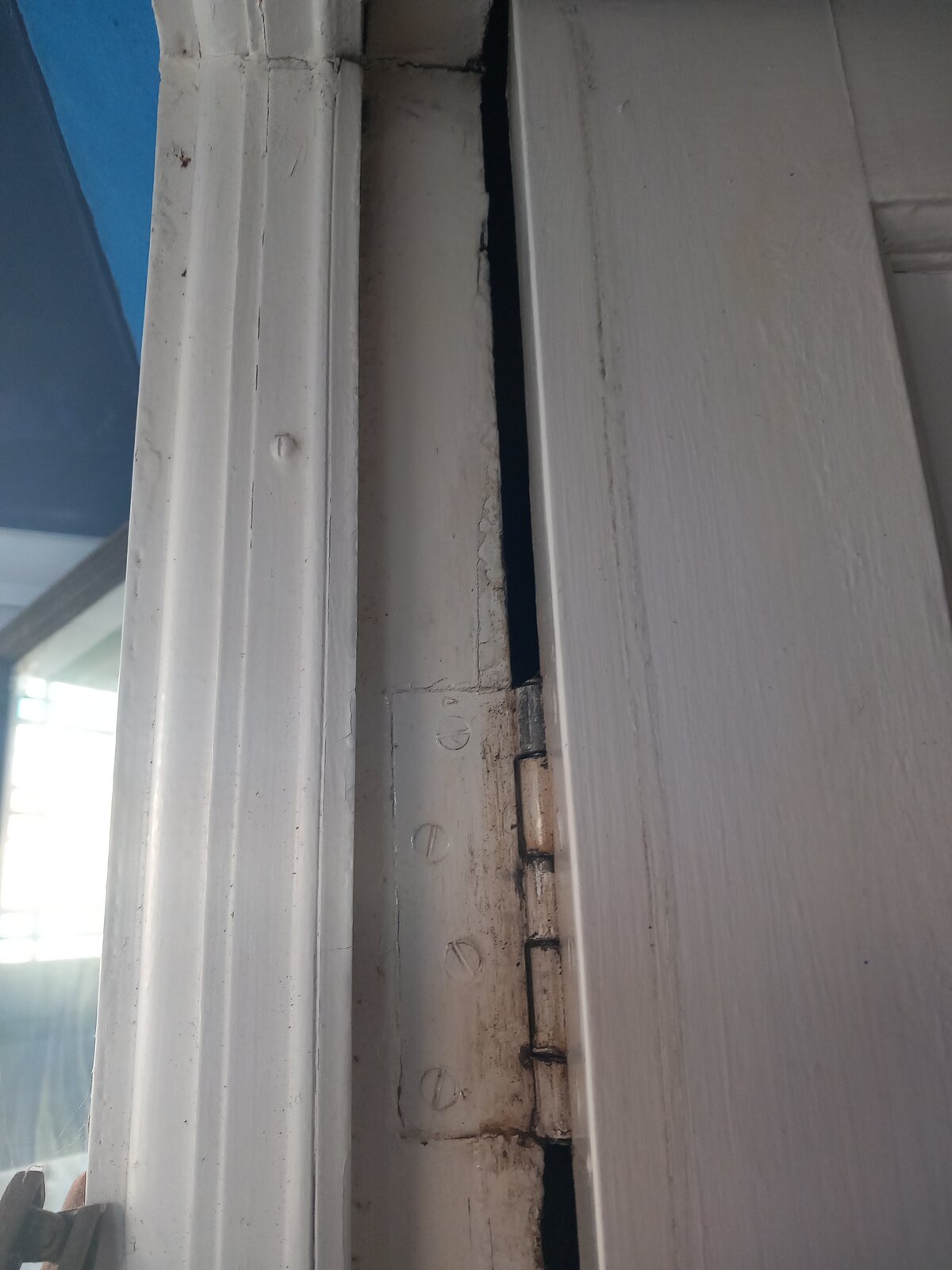

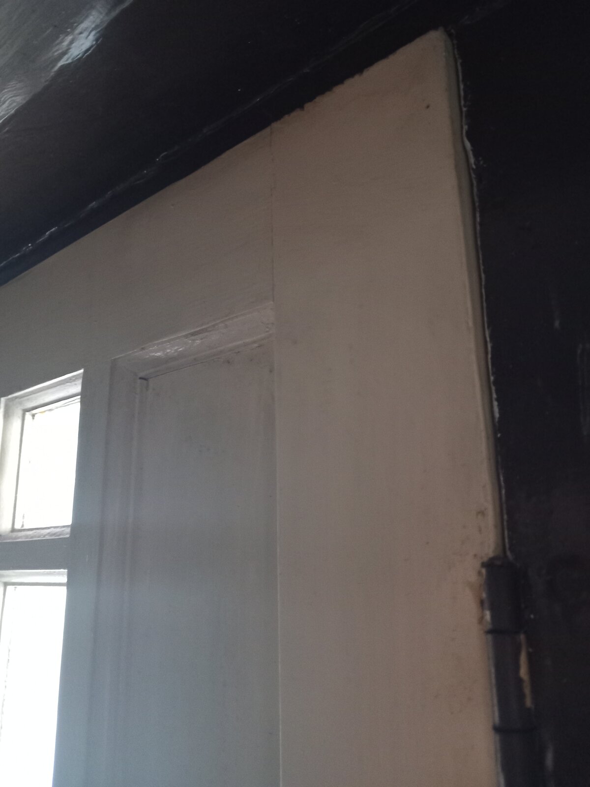

as drop can be caused by loose hinge /loose frame or sagging door through buggered joints through dipping you need to cure the cause /causes otherwise it can drop further and give you a very trimmed door that after solving the problem and pulling back to correct position can leave an incurable mess off gaps where they need not be
several answer really
you need to work out where the slack is so start with the frame if thats solid lift the door handle side looking for slack
now this can be loose hinge or worn hinge or something like a sloppy loose pin hinge
it can also be the door has dropped through dipping or even top door joint hinge side loosening
do you have a nice even gap both sides up the door if not look at packing out a hinge or letting in a hinge
now iff you have ruled out all these possible causes then trim the door
Cou
it can also be the door has dropped through dipping or even top hinge joint loosening
