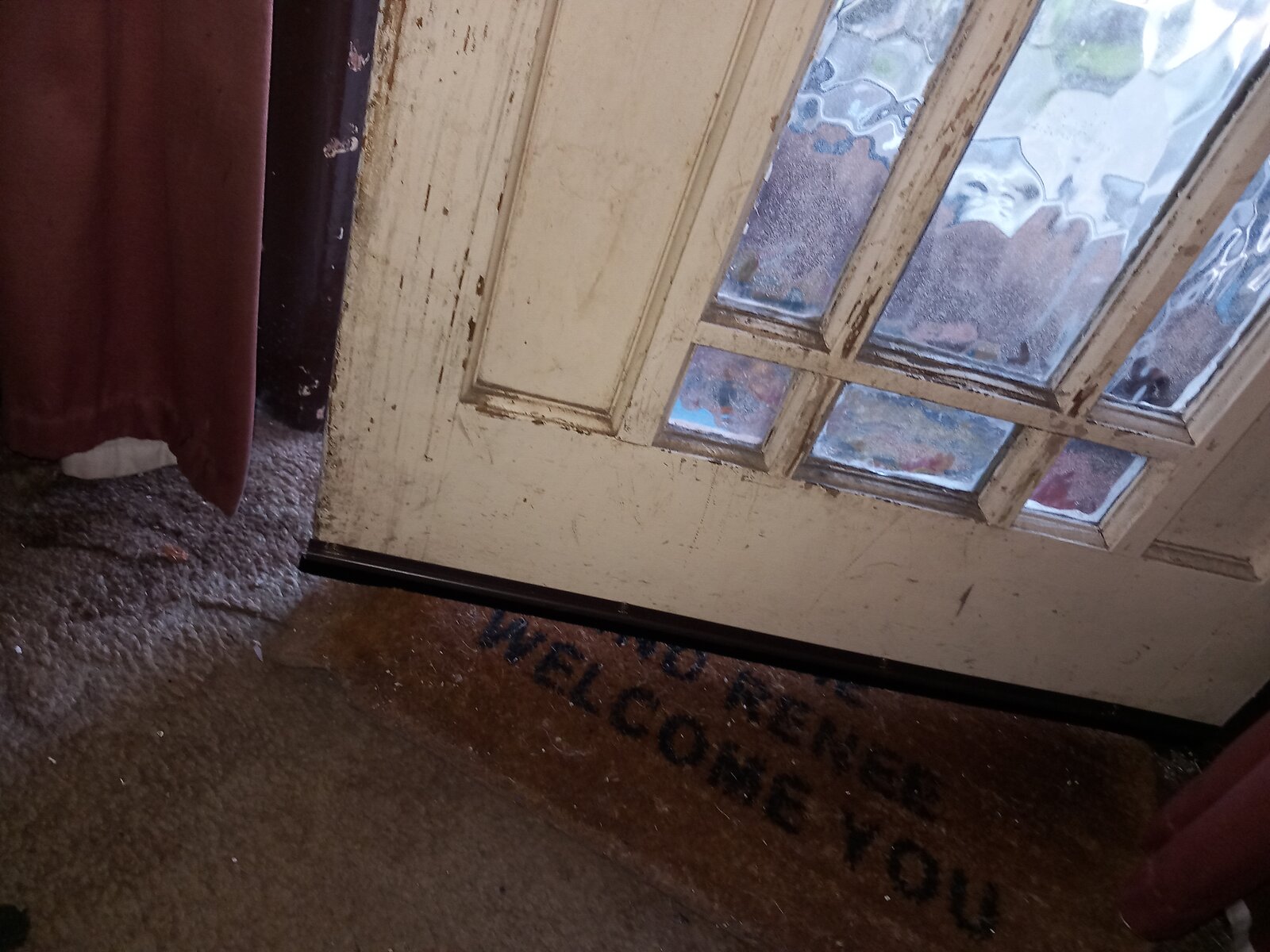

Bottom of door is rubbing

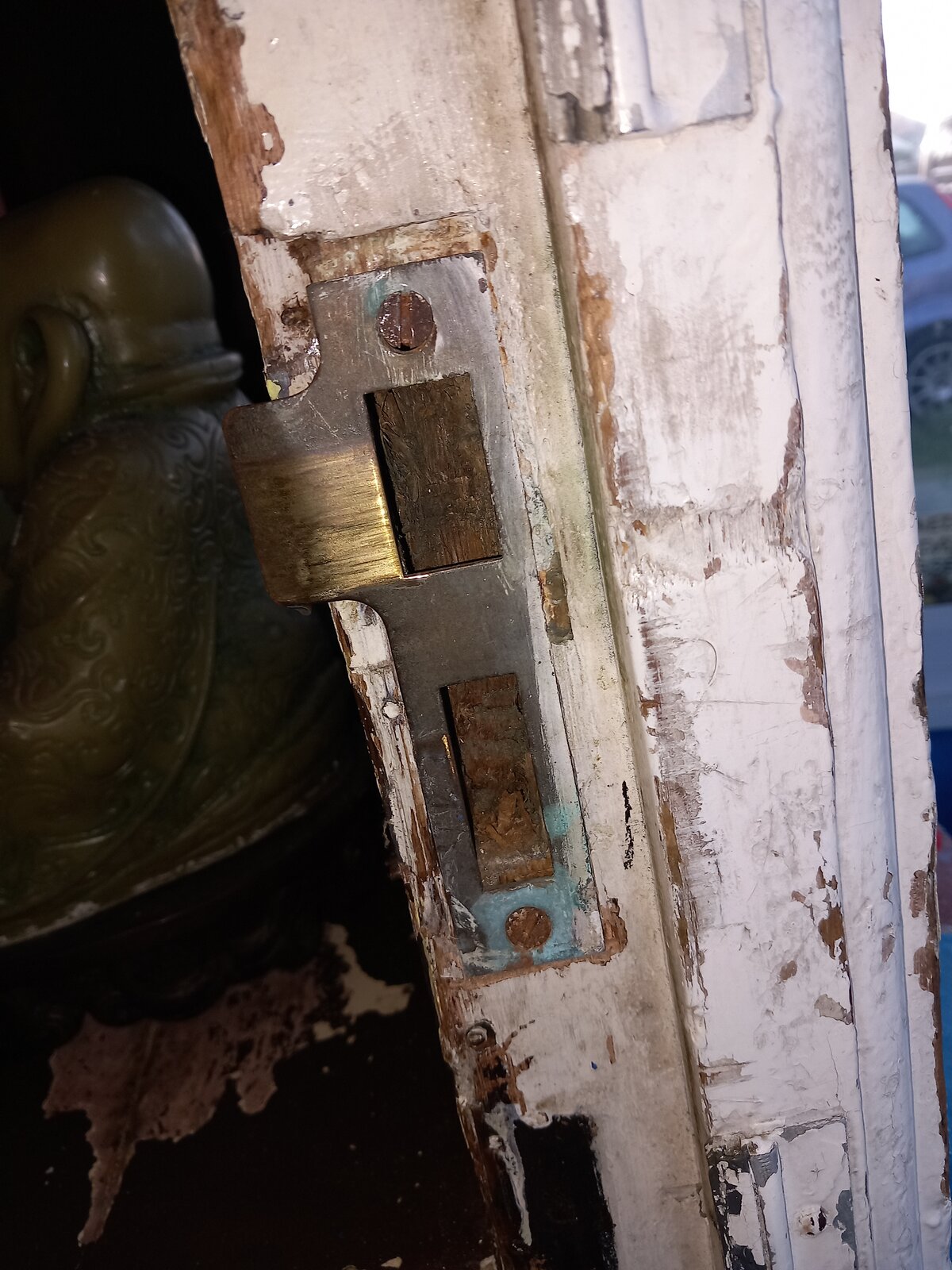

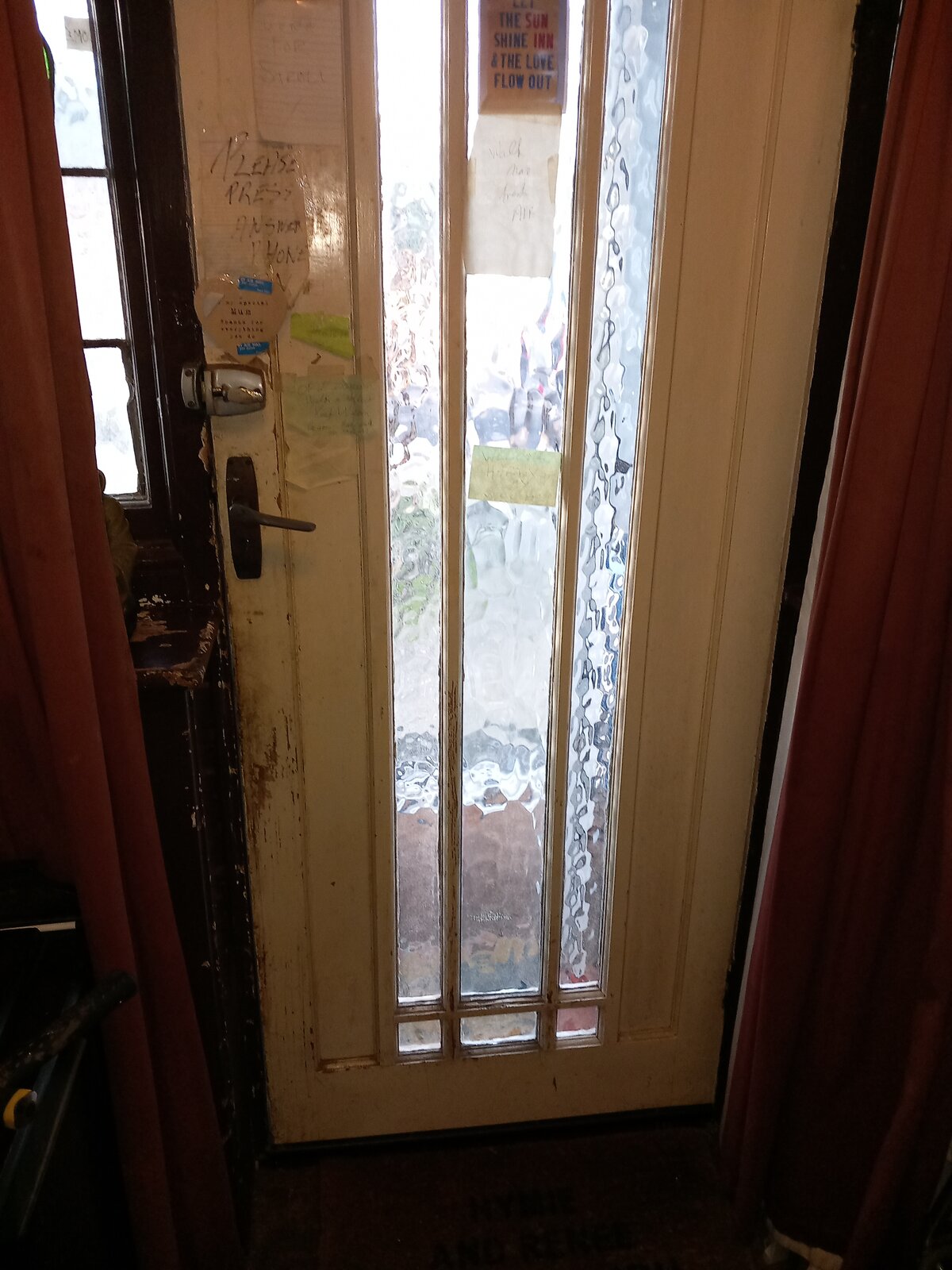

The keep needed lowering so chiselled it out and dropped it so latch would fit. I guess whole doorframe has gone lopsided. Could I cut the metal in middle of keep instead?
Also put a thing on bottom of door to reduce drafts
No get a five lever insurance approved mortice lock and start again. Otherwise you will jeopardise front door security and possibly the home insurance.
I'm assuming the elderly client can't afford a new door/frame to be fitted by a professional.

You can use a file on the metal to alter it slightly. If you have it, a dremel sized diamond bit can be used as a power file.

Wrong tools for this sort of job. A four square file (with a handle fitted) is probsbly a better bet if you need to modify the keep. A 6 to 8in four square and an 8 to 10in 2nd cut flate file (both fitted with handles!) are handy additions to any toolkit. Not everything can be done with power tools!

I did it with a dremel and a diamond bit.
In the OP's case, I think it's more effective to fix the wonky door by deepening the recess the top hinge is sitting in. That will correct the keep as well as the lock.
