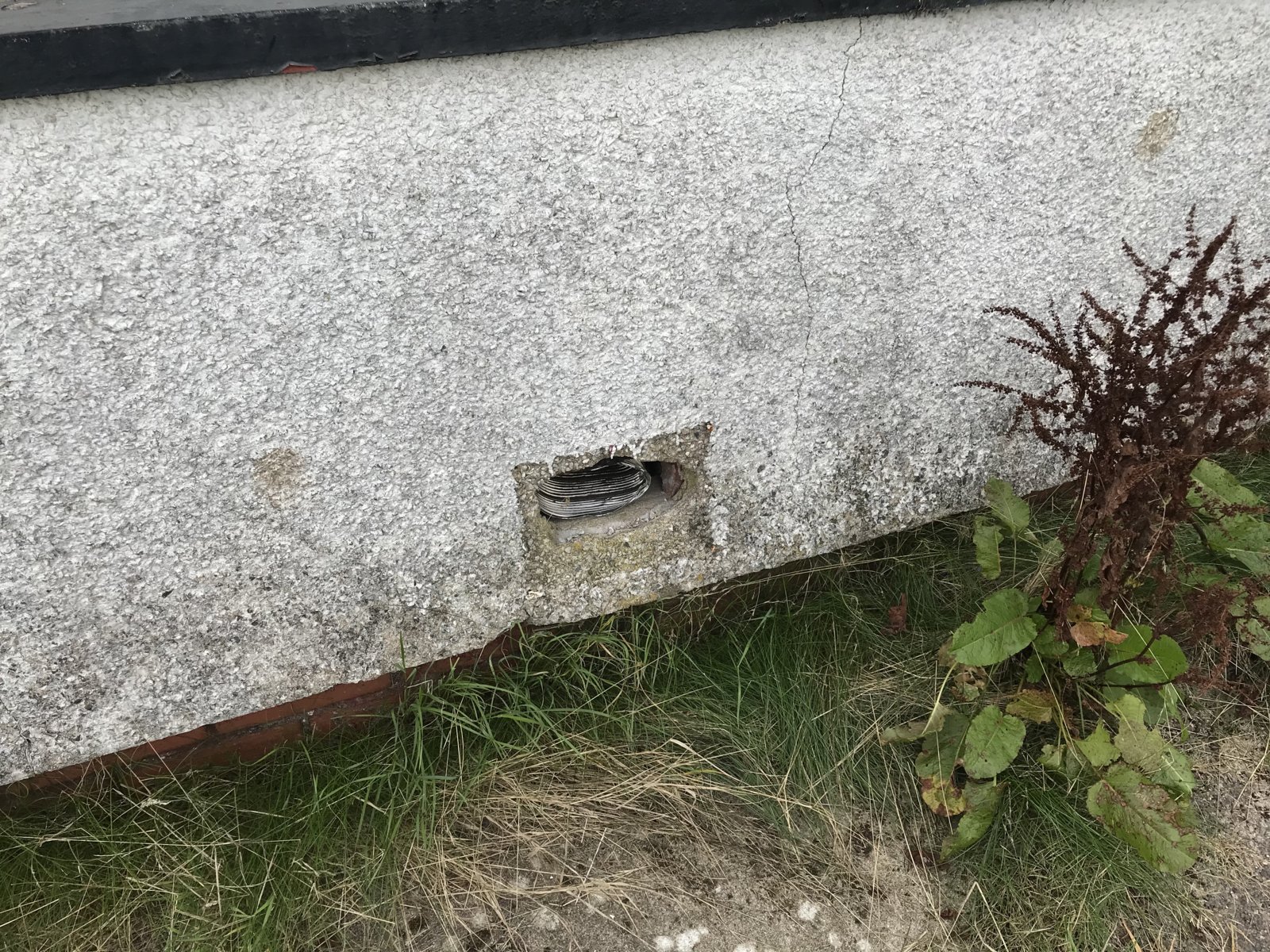

Bought a fixer upper. What’s this front vent?

One thing I can’t work out is what this vent is. Duh, it’s a vent. But it seems so crude and jarring. Any way to replace it?

While it does need a new front grill, you would be best identifying where the silver pipe goes?
Is it for an extractor fan the other side of that wall? What is there that is the other side of the wall?
Fan, boiler, fireplace ? (as the list gets longer so does it also get worse if its for that item).
Thanks Andy. I just noticed as I uploaded the pic.
So just measure and buy a normal vent cover.
Is that crack in the render to the right anything to be concerned about?

It possibly is for the fireplace but it’s the exterior of the bay window.
It's pretty low down.....could it be an air supply for an open fire?
Either way, the local rodents could get their eyes on it so I'd block the gap between duct and the brickwork promptly!
The render looks sound, but listen for a hollow sound when you tap it.

Thanks John.
It could very well be air supply for an open fire as there is one to the right of the inside of that wall.
