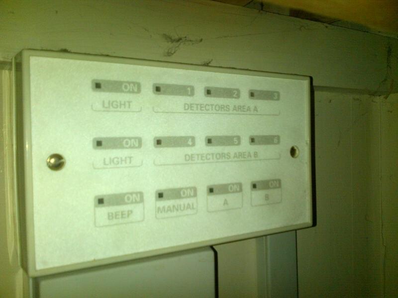

I have a box in my airing cupboard that seems to control my security lights. Have uploaded a photo. It basically is connected to 3 lights and 3 sensors on the outside of my house.
Only moved in about 6 months ago and not worried about it till now, but only one of the lights is now working and it appears I can only trigger one of the sensors, so I am assuming it is the sensors not sending the required signal back to the box rather than the bulbs going. Two did work till quite recently though....
Anyone know anything about troubleshooting a system like this? I am seriously considering just pulling it out and sticking in three stand alone PIR's, especially as they don't seem to have any daylight awareness and end up on all day in the bright sunshine!
Any advice appreciated.
My only caution about stand alone PIR's is that the lights are very high up just under the roof (two story house), would these work ok that far away from the ground?
Hi, i have a friend who has that system and it's twenty + years old and has been no hassle, it would be easy to replace the lighting as you suggest. Try google for the instructions and check setup . There is an override button which will keep the lights on all the time !

Many people seem to get acceptable performance from PIRs at that sort of height - but if it were a problem, or you feared that it would be a problem, you could have separate standalone PIR detectors lower down than the lights.

That's a good point, when I push manual the light on the box comes on but the light outside remains off. So I guess that means means bulb and sensor have gone :s

PS, that control panel seems to be a standard device, I have never seen one, but I expect that all of the PIR and light connections come back to that.
A decent electrician could work out what is faulty in an hour.
Just swopping sundry components at random is never a good way to find a fault, especially if it means going up a ladder!

When, as in your case, one has multiple lights and multiple PIR sensors, there can be a problem if one sensor can 'see' the light from one of the other lights. That can mean that once one of the lights comes on (at night), the other sensors will think it's daylight and therefore will not respond to movement. A few years back I had to do a lot of fiddling when a neighbour installed an on-all-night light, which was fooling one of my PIRs into thinking that it was daytime!

Thanks for your help guys, I think I've finally worked out what is happening.
From the advice above I have found my sensors, or at least the updated models.
http://www.gjd.co.uk/wp-content/uploads/wpsc/downloadables/Opal-XL-Manual-.pdf
They do have light detection, so basically what is happening is one of the sensors is triggering in the day and as such both of the lights in that zone go on. The other PIR is working fine, but only after dark. Same with the one out the front.
So basically I have deduced I have one sensor that I need to take down and look at the lux setting and two lights where I need to replace the bulbs. Thanks everyone for your help, much appreciated.
