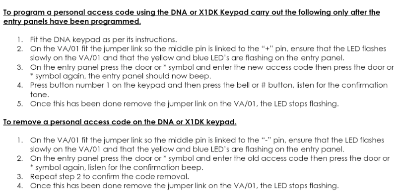

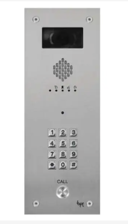

Hi, we've inherited a bpt door entry system from the previous owners. I'm trying to change the entry code but so far no joy :(. The entry panel is an X1DK keypad (with video as well - pic attached), along with a VA/01 control panel. I've tried following some instructions I found online (screenshot attached), and although when I fit the jumper the correct LEDs do flash, it doesn't seem to work whether I'm trying to add a new code or remove the existing one. Any help much appreciated!
EDIT: sorted after a few hours of trying various different methods - had to reset master code as per attached pdf instructions.
