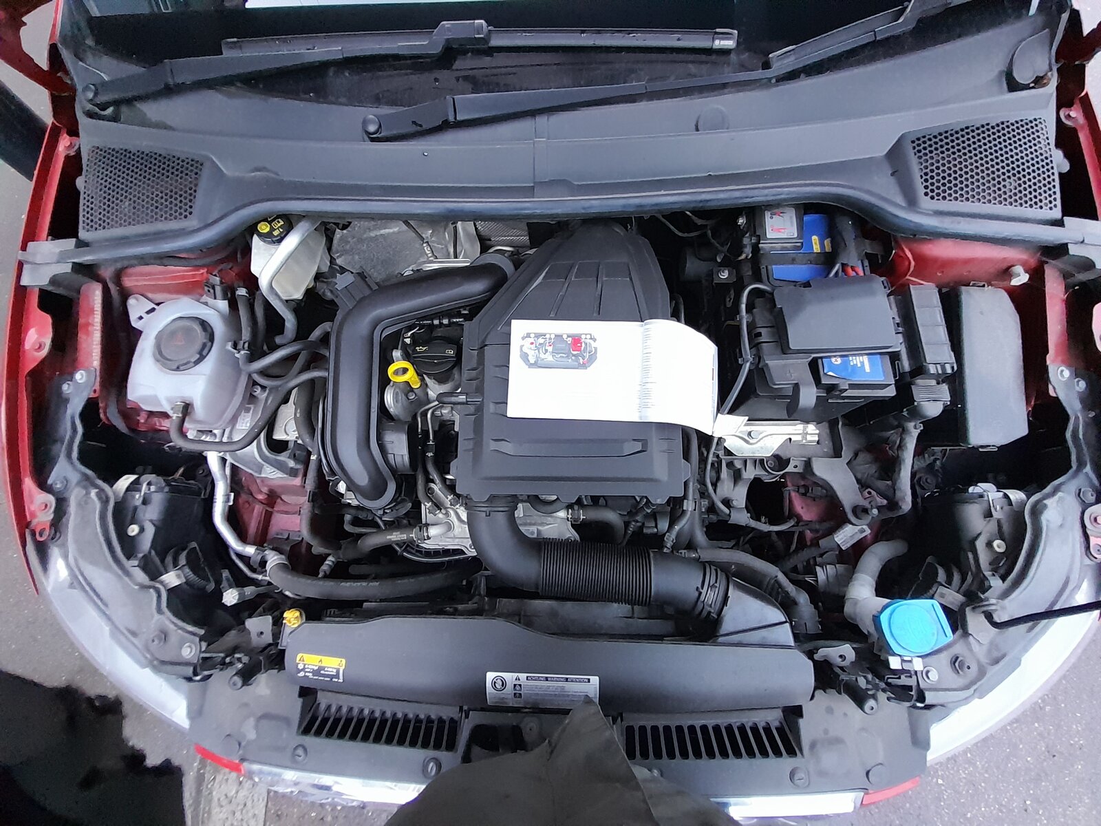

Hi all,
A funny thing happened on the way home tonight.
I was driving really slowly in traffic - maybe 2mph - when suddenly there was no response as I pressed the brake pedal right down. I pulled the handbrake up too with no response and consequently bumped the guy in front. He was fine about it as there was no obvious damage. during the rest of the journey home I tested the brakes thoroughly and all was normal.
I get the car (67 plate Seat Ibiza) serviced at the local garage annually, the last service was in December.
I'm thinking that there may be a problem with the hydraulics but would that affect the handbrake too? I thought handbrakes worked on a cable principle.

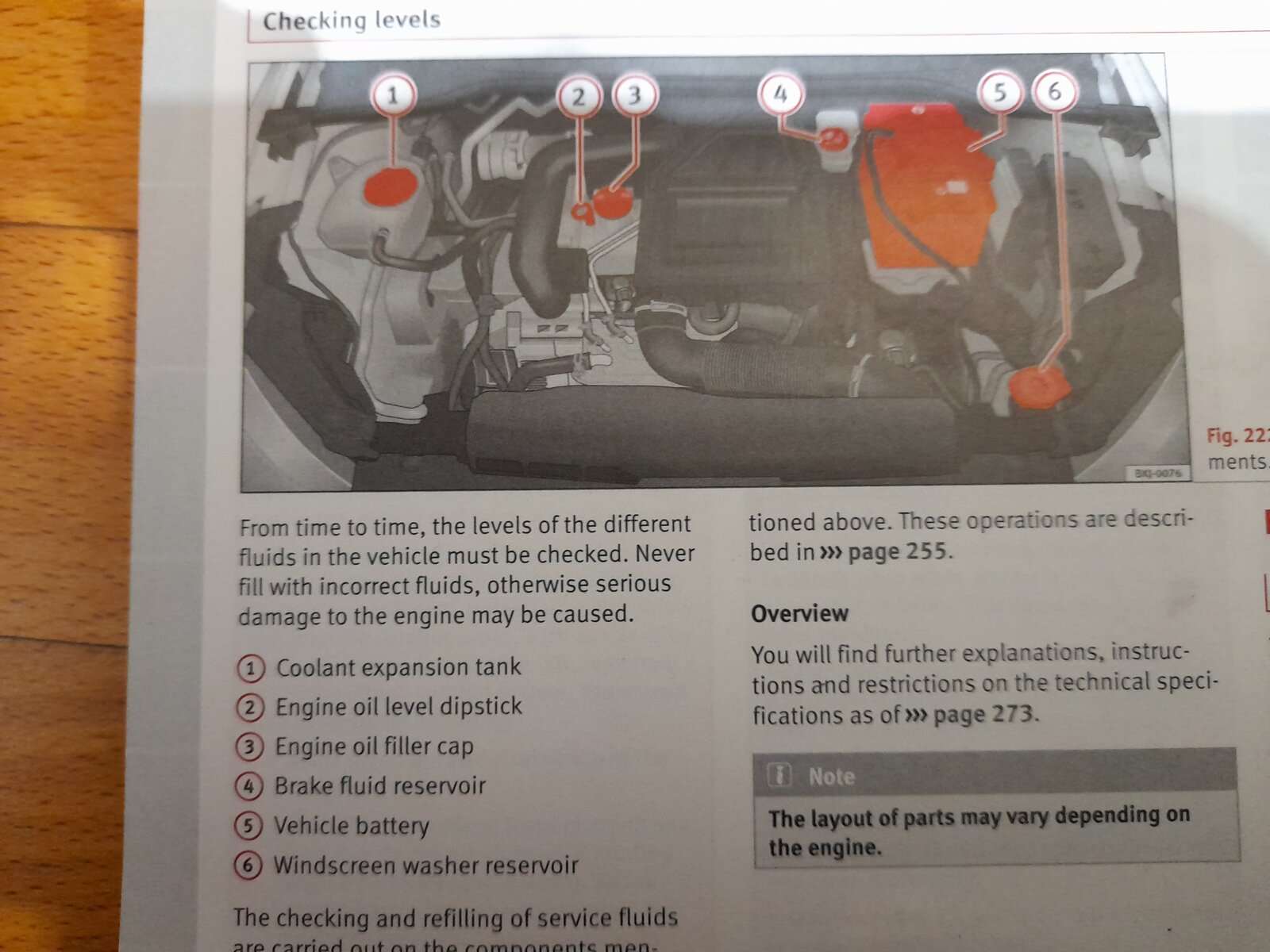

Could I fix the problem by topping up the brake fluid? I think the brake fluid resevoir is the one second from the left of the below picture
The manual shows it as being elsewhere but I'm guessing there was a modification

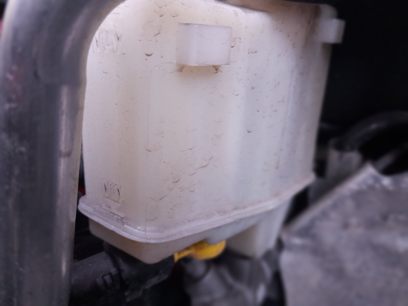

Anyway, here are a couple of close ups of what I think is the brake fluid resevoir
It looks empty to me though I cannot tell for sure.
would it be safe for me to just pop out to Halfords and top up the thing?
The brake fluid reservoir is the one marked DOT 4 - the type of fluid to top it up with.
How low is the fluid level......any pool of liquid under the car? Do lets know exactly as the level is difficult to see from here.
We cant recommend driving the car until this fault is sorted.....it’s probably a master cylinder issue.

If the fluid is that low you have a problem that needs resolving before the car is driven. Manual? You were probably pressing the clutch having got distracted from sitting in the queue. :D

The brake reservoir should never be empty, some use it as clutch fluid as well but the clutch fluid is always taken off further up the bottle for safety reasons.
Thanks for all the answers guys. I get the distinct impression that simply topping up the brake fluid resivoir aint gonna cut it.

Pop the bonnet and give the reservoir (the clear pot with the DOT 4 label on the yellow cap) a wiggle. You should see the fluid moving about in there. Chances are, it will have a "max" mark on it. If you are low on fluid, as others have said, you have a problem that needs urgent attention. Look for leaks under the car, drips of fluid on the insides of the wheel rims, and feel the carpet round the top of the brake pedal to see if it is "wet", suggesting a brake fluid leak from the mater cylinder.
Total brake failure is extremely rare, but not unknown. Indeed, I have a colleague to whom it has happened. In his case, it seems to have been the ABS pump. However, they tend to leak internally, so if it's that, you shouldn't have seen a drop in fluid level.
Got the car back today and the garage owner can't find anything wrong.
He thinks there could be an intermittent fault with the ABS system though as he's heard of similar faults on other VW Audi models.
Didn't charge me anything butsaidbring it back if it happens again.
If there was no fluid missing, then I'd be inclined to agree. Bloody worrying though!
