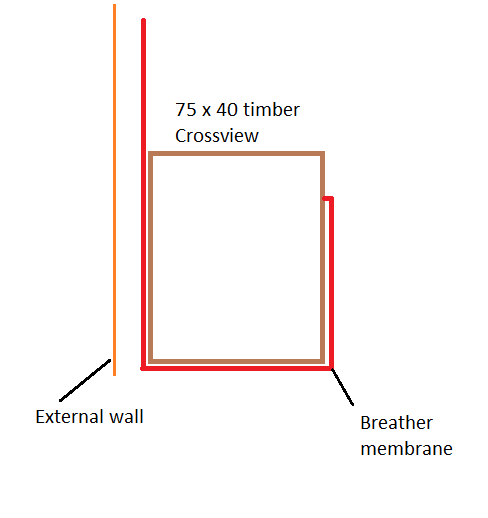

Hi,
When installing a breathable membrane on the back of studwall, are you supposed to come our from behind the studwall and go over brick pillars to seal it fully. If I only apply it to the studwall, the gap between the brick wall and the timber will still have a gap.
Also, at the floor, should I bring it under the timber into the room slightly? Will this help safeguard the timber also? I'm not talking a lot, just fold it under and staple it to the front side of the bottom horizontal timber.
I've tried to explain in an image below, blown up large. So down the studwall, under the beam and tacked to front edge.
Thanks!
Breathable membranes typically go on the outside, not the inside
It is sitting between the external wall and the first layer on PIR insulation inside a stud wall. Preventing anything getting to studwall timber or my insulation.
So brick wall > breather membrane > studwall with PIR taped > more PIR taped over top > VCL > Plasterboard.
This is not correct?
Sorry, your pic was confusing and made it look like you were putting the breathable membrane on the internal
Yea, your buildup is correct. Some would say you don't need a VCL if you're taping your foil faced PIR. Personally I use a VCL and don't bother taping the PIR. I'd also have battens between VCL and plasterboard to form a service void so I'm not bashing holes in the VCL and I'd use an aluminised VCL
Housewrap's advantage is it's light, comes in useful 2.8m widths and can be aluminised on one side for better U values. It was relatively cheap back in the day but is a bit eye watering now. I'd use a roofing type felt instead these days, white side out if it was dark coloured. I wouldn't go for the financial shafting wickes are offering though; 30 quid for 20sqm is high compared to eg picking up a 1.5mx50m roll of Cromar vent3 for around £45 - https://www.ebay.co.uk/itm/222693242050
Do you really need it?
Does the brick wall get any ingress of water? And if it did, it would just run down the inside face, in any case, your pir won't be affected by it.
You'd want it under hung tiles, external cladding, or if you had mineral wool insulation, but your current set up doesn't really require it.
Your floor DPM should go under the frame and up the outer face 200mm or so, and the membrane lap that at least 100mm, but not touch the floor.
