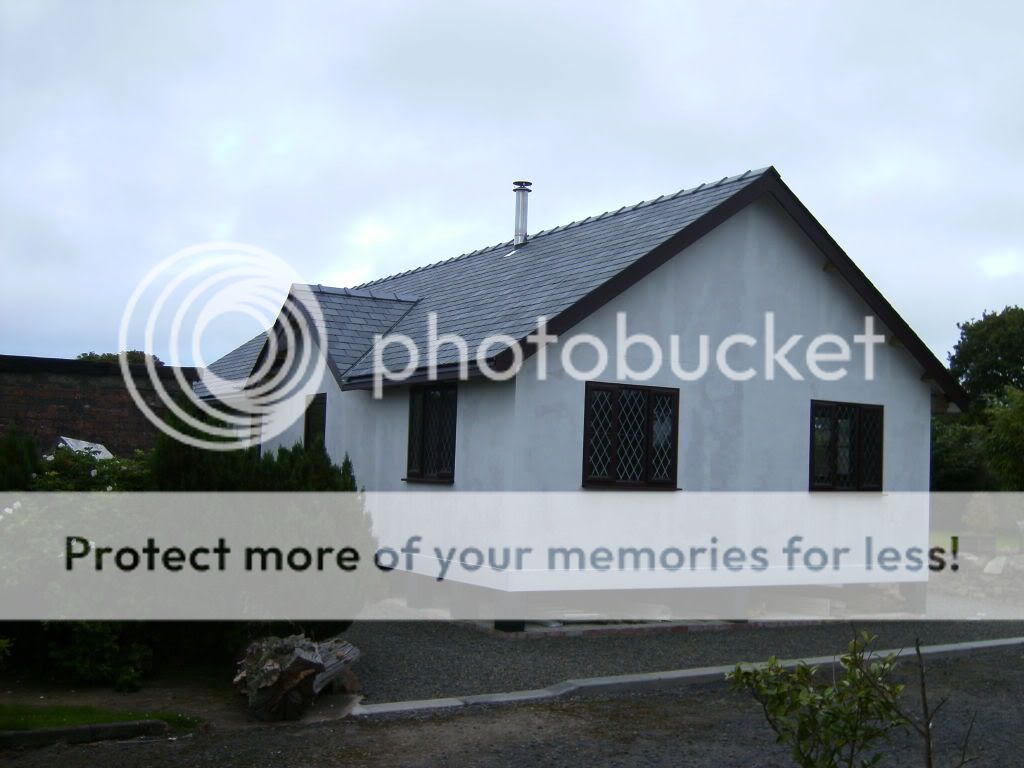

Almost there. It was PT coatings I used, bought their primer and stipple coat, to cover the whole thing (primer both sides of the boards) including delivery (with a small overage) came to just shy of £600 ... not the cheapest stuff in the world.
We've now just finished building the bare structure and roofed it, the primer is all on, I'm aiming to do the topcoat in the next week or so.
Will post an update when it goes on.
