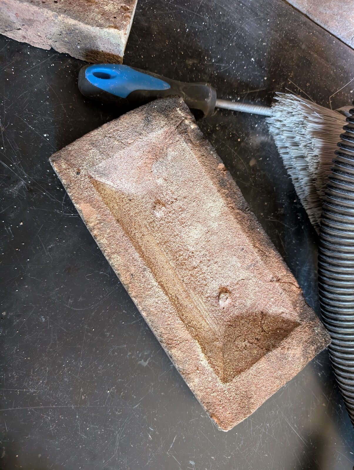

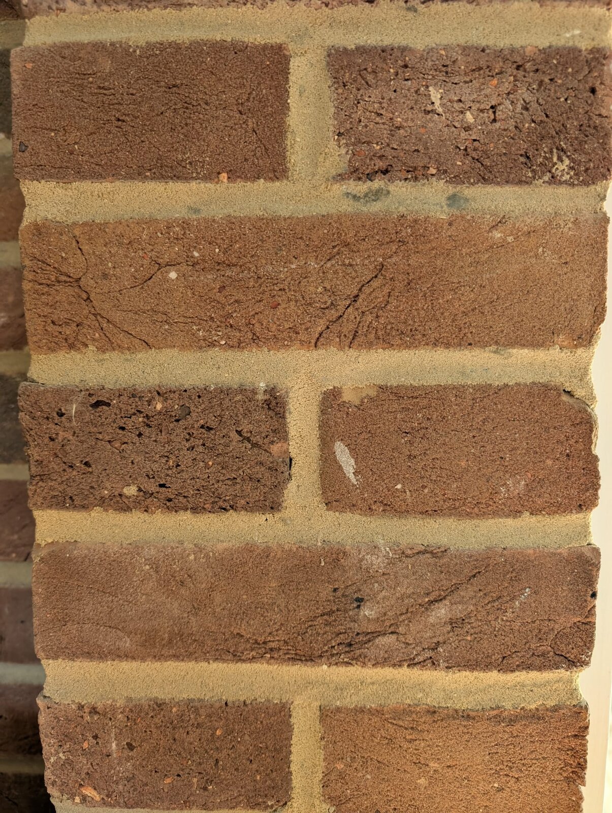

Hi there,
Can anyone help me ID these bricks which are 50mm high and mortar colour?
Looks like yellow sand and cement.
How old is property?
Could it have lime in it..
You may need to find a good brick supplier that's local.
This is one I know of you can have a look at. Scroll through pictures..
Bricks Metric and Imperial | Bricks from AW Mobbs of Oxfordshire
House is approx 1965 in suffolk if that makes any difference.

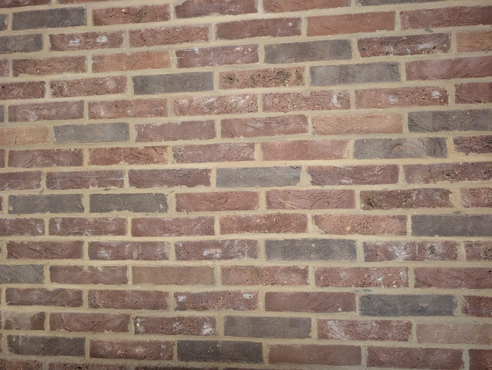

It's a stock brick. Type in words such as 'handmade stocks' or 'stock multi' on the Wienerberger site or similar.
Bog standard yellow s/c mix 4 or 5 :1
Have a look at Brickhunter library. There's thousands on there, but being 50mm and textured will narrow it down a lot. They might be on there, but not in production.
Google Imperial Tudor Multi.
