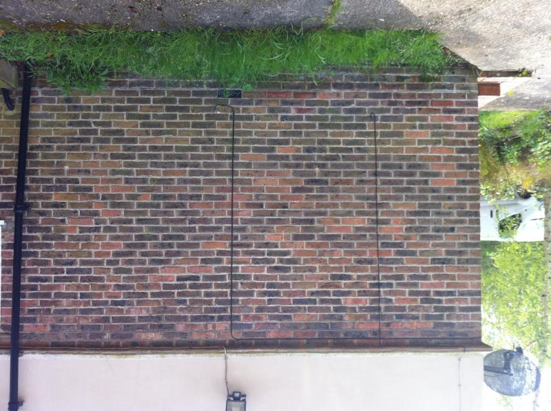

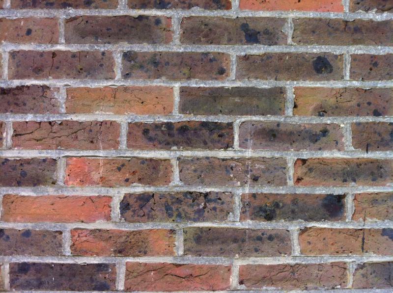

Hi,
I'm looking to order the bricks very soon, I'm hoping someone will be able to help me identify these bricks so I can match them, I understand there are brick matching services but I'd prefer many peoples views as well as the builders merchants! Besides they are all closed today.
£5 to the first person to correctly identifies the bricks!
They're a London red stock of some description. Windsor reclamation is your best bet.
Could it be anything like this - right-hand column, 2nd down?
Remember that the colour of the pointing has an effect on the overall appearance of the brickwork.
yep, that's the closest I've seen yet :D
It's the black flecks/spots that have thrown me, they are really prominent on a lot of bricks but none on others!
I first thought it was a kind of road tar or mould, thanks tony that's a great start for me!👍
