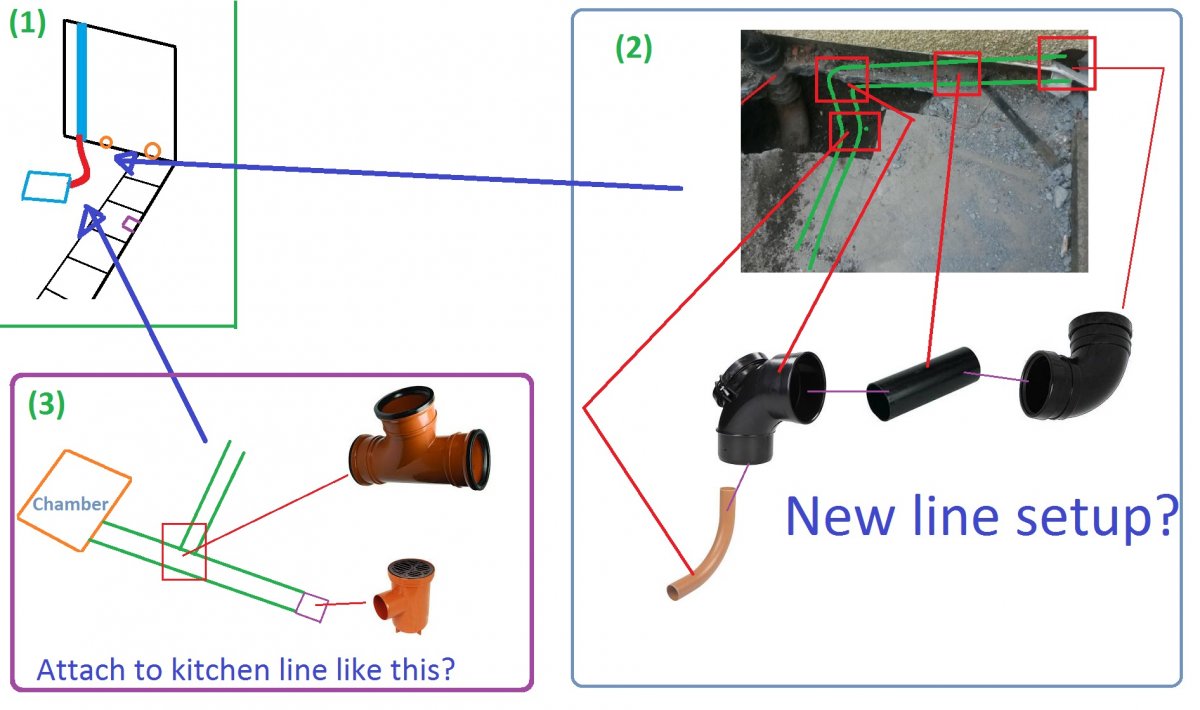

If we were to install a new inlet into the chamber then we would need to get someone with a diamond core drill to drill it, which may work out quicker and cheaper (if there was enough room for the new inlet) than me having to smash out the concrete to find the kitchen drain pipe, chop and connect new fittings and then back fill this extra area that I'd have dug out.
For the other option of joining to the kitchen pipe line, I drew a pic that shows what I interpreted to be the suggestion for this option?
-There are paving stones next to the kitchen wall, so I though it maybe easier to just go round them rather than disturb them.
(1) = Sketch of the way it looks now
(2) = Connection from new w/c wall to the kitchen drain line
(3) = Kitchen line

Thanks. I did a mock up of the inside of the w/c, just need to do the one for the outside pipe work now. I mad a sketch of what I interpreted from what
you said about connecting it to the plastic.

No, what I'm suggesting is you renew the existing run from the manhole to the current gulley position, and replace the gulley at the same time. Then join onto this "new" run from the house with the connection from the new WC.
Oh right, I get what you mean now I think.
Would this mean removig the clay pipe thats attached to the end of the existing soil pipe? If so, what's the best methord for removing them? The clay pipe is cemented underneath, on the side were it connexion to the chamber
No, dig down and find the 'other' pipe that runs from the manhole to the gulley, at the point where you want to connect to it. (As you've shown in your picture number 3 above.) Just take a straight line from the proposed position the new pipe will exit the house to this drain, you don't want any more bends than necessary.
Once located, either cut it there, or expose it back to the previous joint, and change to plastic from there. The section from manhole to stack in your pics is Hepworth 'SuperSleve', so, hopefully the other run to the gulley will be the same. The required couplings to take you from this to plastic are readily available. Fit junction or chamber in required position to provide lateral to new WC position, then continue to existing gulley position.
