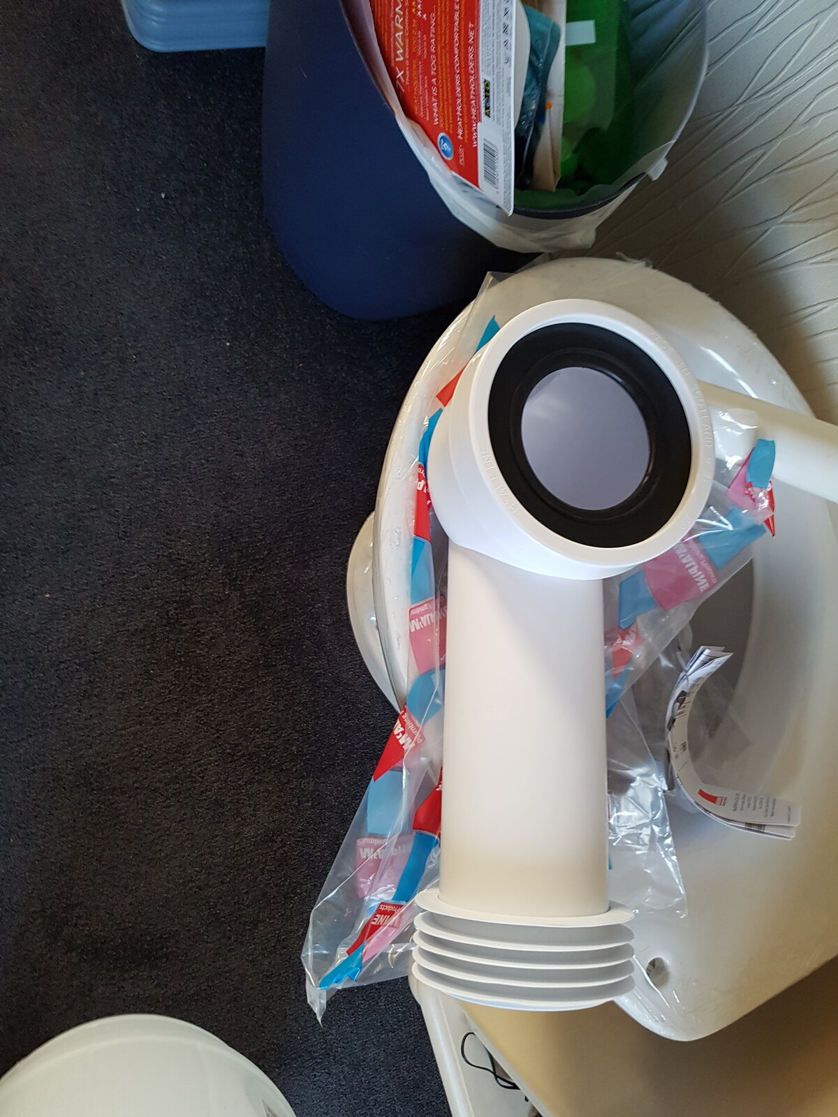

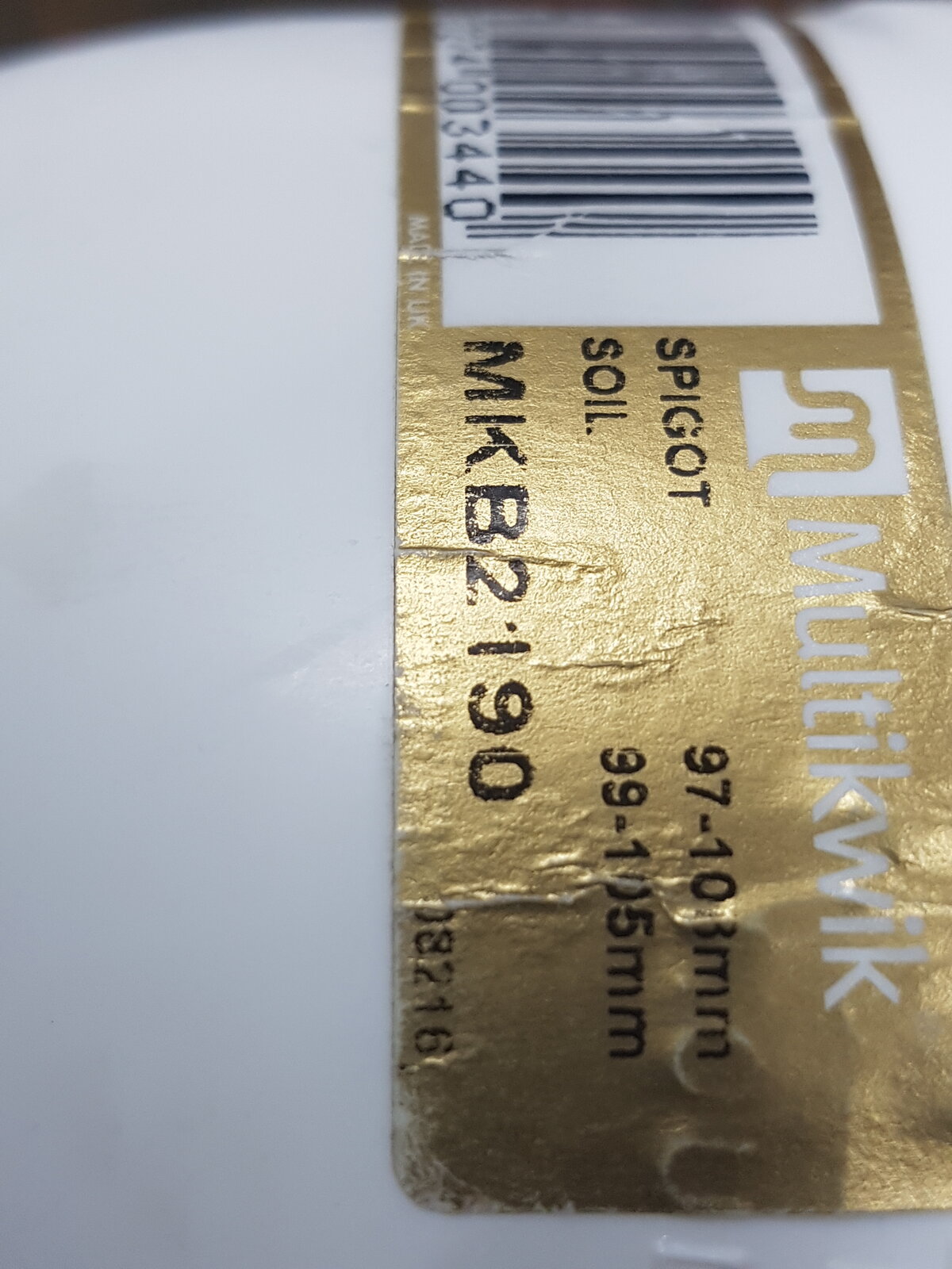

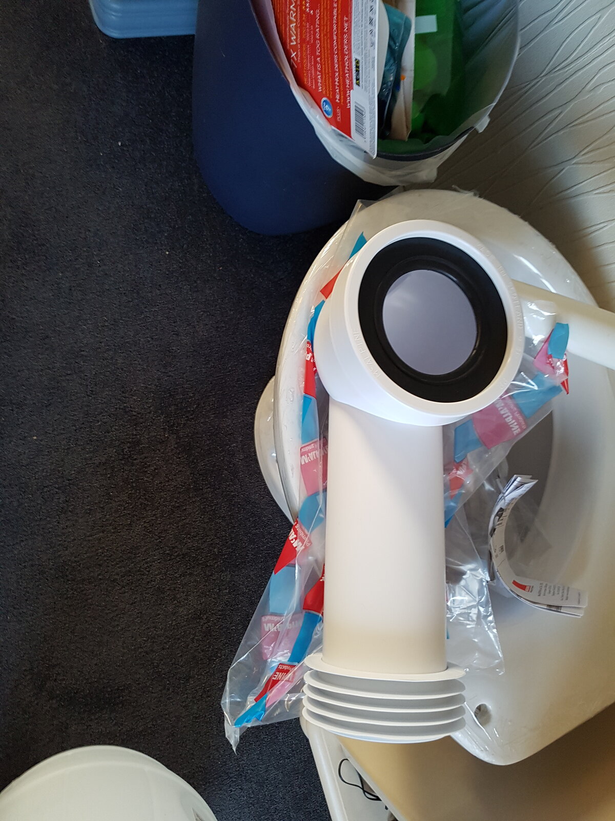

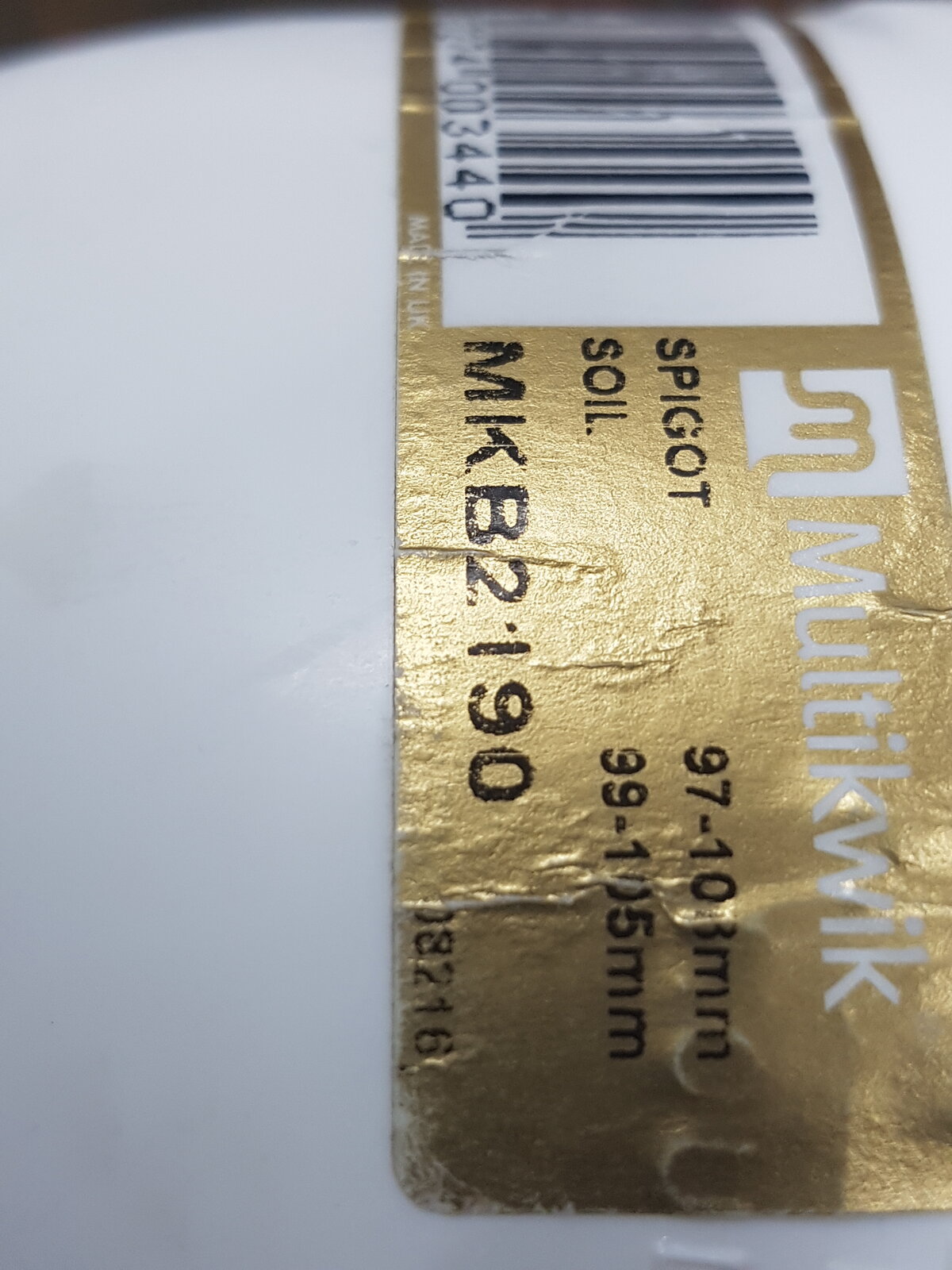

I've got clay soil pipe at ground level that a toilet needs connecting to, but the internal diameter is 90mm.
Standard plastic drain connectors are 100mm, including the plastic/rubber fins at the end that fits into the clay pipe. How do I connect a pan/drain connector to the clay? Thanks
I had the same problem a few years ago and found an adapter that fitted onto the toilet outlet and reduced to 90mm for the soil pipe. Got it from a builders merchants. Ridgeons if I remember correctly.
Here's a picture.
I'm a bit late updating this (better late than never though!) I managed to resolve the issue by using a standard 100mm connector and used scissors to trim the rubber/plastic fins down by about 50-60%. The connector then with a bit of encouragement pushed into the clay pipe and has been working fine since. Hopefully helps anyone who stumbles across the same issue.
