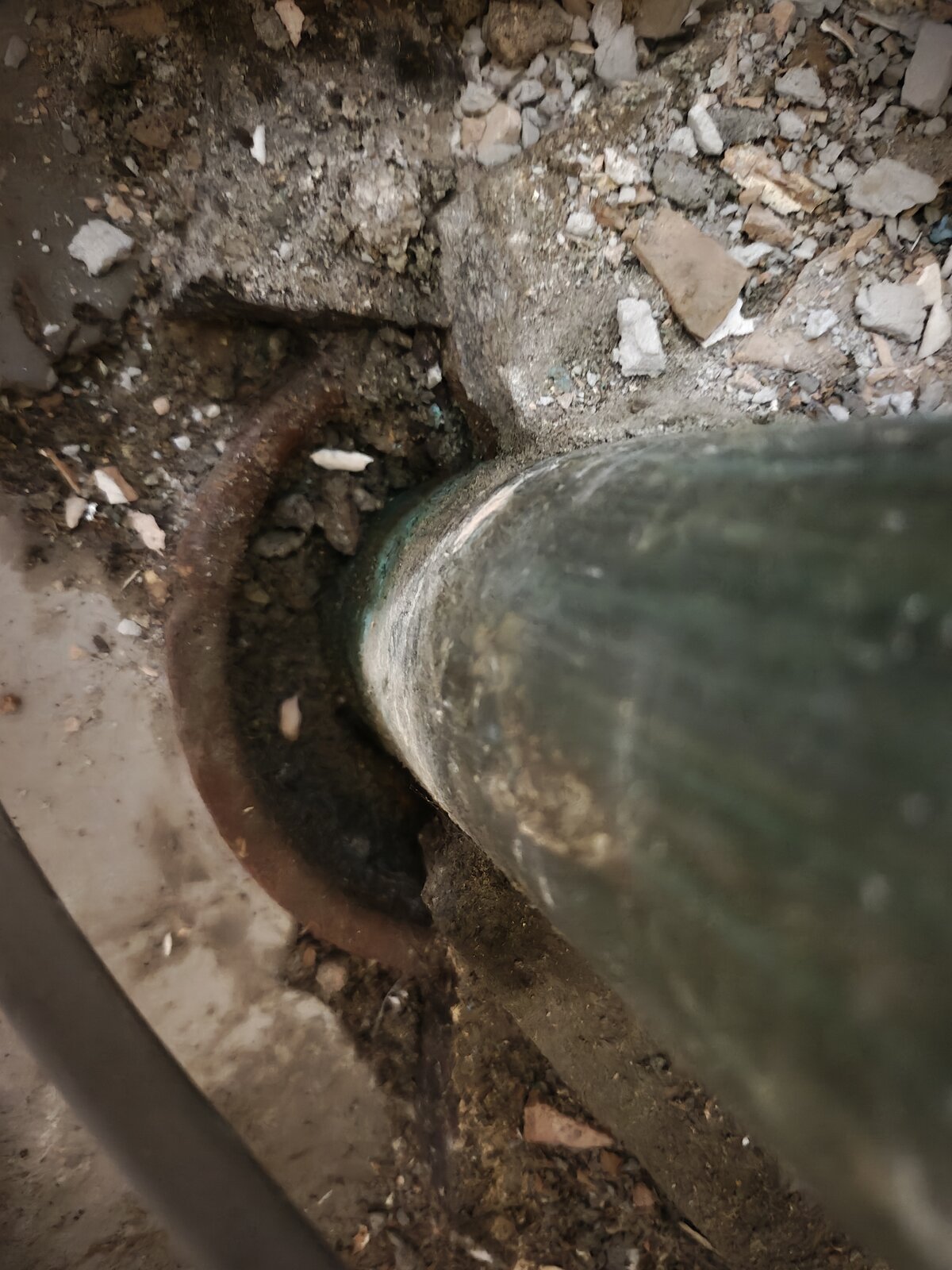

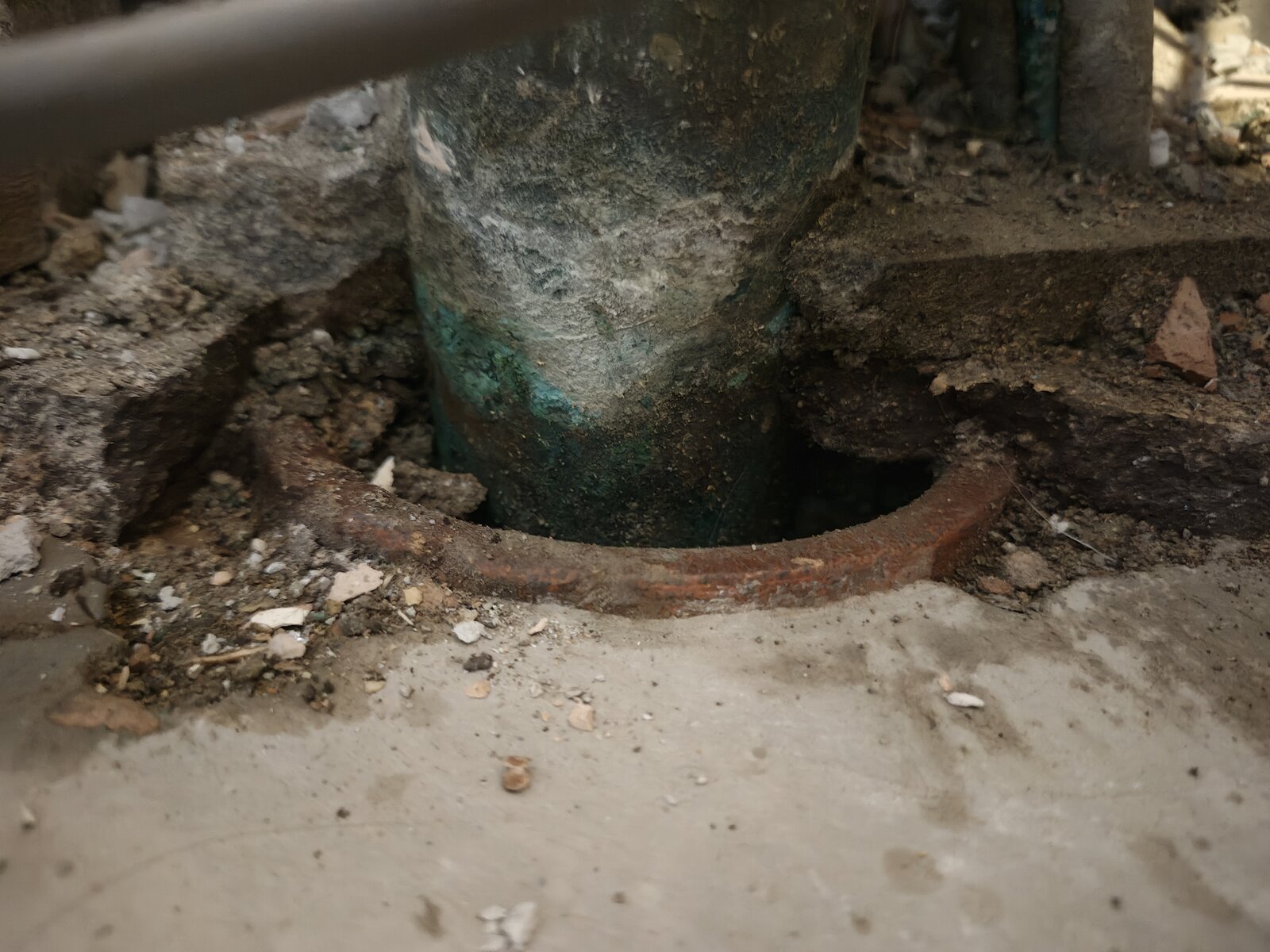

Hi, We are replacing our copper soil stack with PVC. It runs internally, in a straight line, from bathroom floor down to kitchen floor where it enters a flanged clay pipe.
The copper waste pipe is 90mm in diameter and the hole in the clay pipe that it sits in looks to be the same (a very small amount of wiggle room). Is there a connector I can put in the clay pipe to connect to new 110mm PVC waste?
Would something like this work? - https://www.toolstation.com/mcalpin...8Ic2VDatWmJteXiRD_JxkGSTWzz8UWbRoCJ3EQAvD_BwE
This https://www.toolstation.com/mcalpine-drain-connector-110mm/p96056 is designed for the job.

That's just what I thought I would need, thank you!
