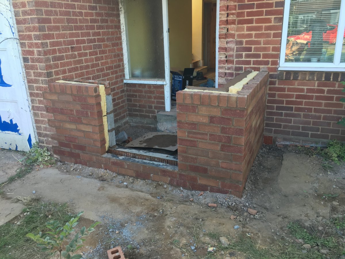

My brick layer cancelled on and wants to now come on Sunday. Given builders merchants are closed on Sunday. I have to be double sure I have the materials for him.
I'm doing a small porch and this is what I have(I have checked quantity/)
Facing and engineering bricks
Hemlite and topcrete blocks
Insulation ties
DPC
Wall staters
Sand
Cement
Plasterciser
Is there anything else I might have missed?
Are your neighbours aware that building work will be taking place on Sunday?
Some councils will stop it in a heart beat.
Andy
Thanks all. The builder cancelled so had to do it today
Here is the result
