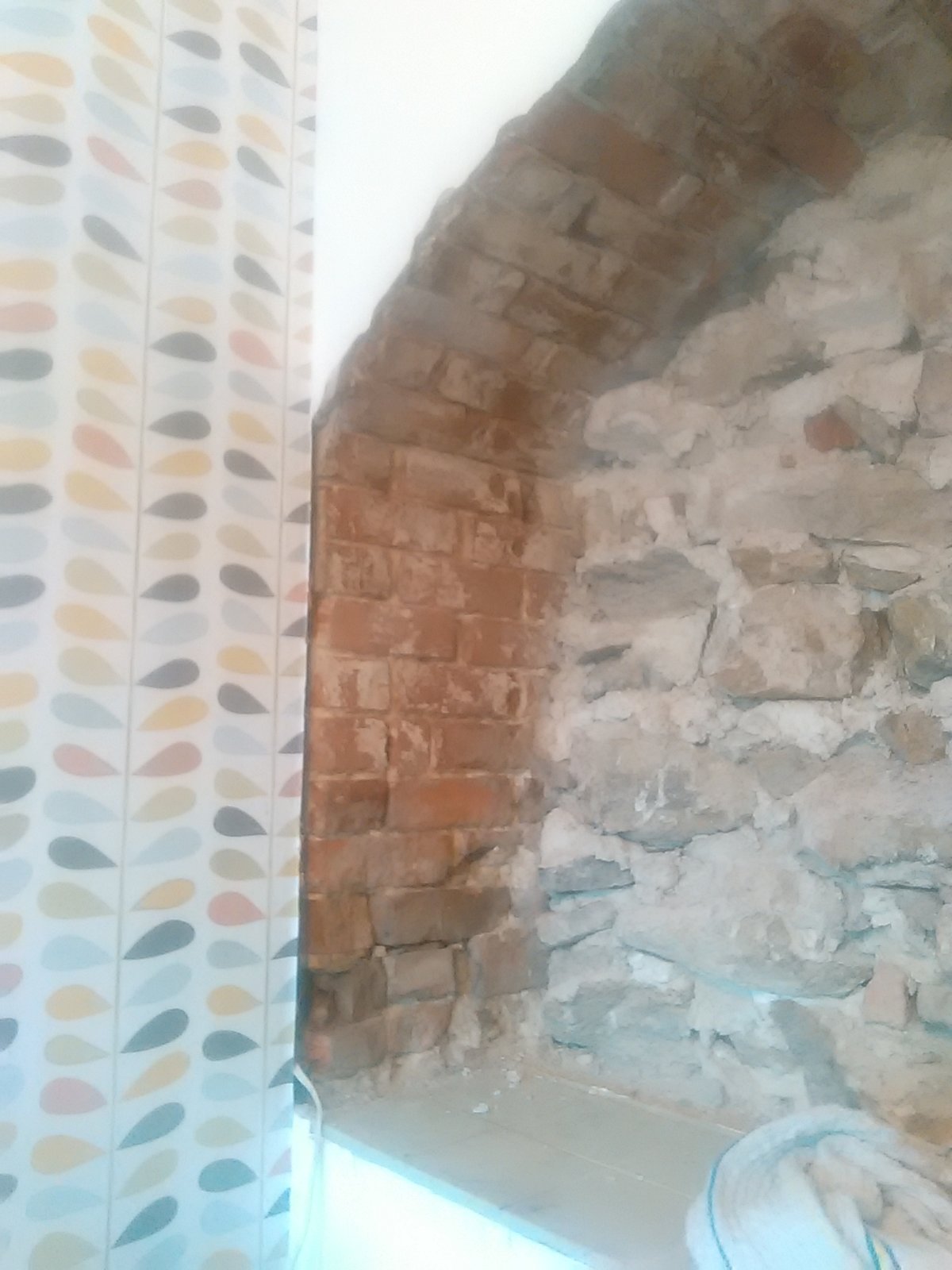

We have house built with thick stone walls - about 80cm. In the kitchen, there is an archway covered by plasterboard which was the original exterior wall to the house about 100 years ago. We'd like to uncover it as a feature an also to let ore light though.
I've removed the plasterboard and surrounding plaster and behind there is all red brick sides and an archway in good condition going right across. I've removed a bit of the stone work where it was bricked up. I'm fairly sure it is well supported - most of it aprt from 20cm didn't have any stones under it anyway and it is the original back of the house - think it may have been a bakery or something!
What do you reckon - am i good to remove the rest of the stone that has bricked up the arch?

Looks OK to remove, it would appear to have been installed some considerable time ago??
Is there a fairly recent "Extension" on the other side of this arch?
Reason I ask is that you may have located another Egyptian artifact on the other side, the arch reminds me of Egyptian relic hunter films??
Seriously, the infill does not appear to be supporting the arch, the arch is in what appears to be good condition, it will be a stunning addition to the house, and probably in keeping with the age.
What makes you think of a Bakery? the arch would appear too small for a horse drawn cart, but a hand barrow would fit well?
Ken.
The infill won't be supporting the arch; in fact the one thing you don't do is to try and support an arch from below because all bricks in the arch must be in compression, and supporting an arch from below can induce tension in the mortar joints = collapse of the arch.
What does matter is that there is a suitable length of solid wall each side of the arch (aka 'abutment') to stop the arch spreading.

Some of the pointing was loose in a small area of the arch so I've cleaned up the brickwork and will repoint it before removing the rest of that stone work. Then got a black Smith making an iron window frame to go in it which should help support it and also separate the kitchen and lounge with regards to noise a bit.

Thanks Tony - good to know aswell. There are no worries with the abutments - quite substantial!
