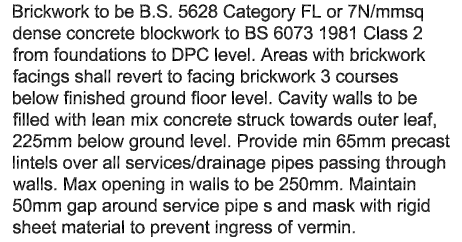

My architect has specified the below.
The walls will be rendered so blockwork to both skins above DPC. Is there any benefit to either brick or block below DPC? Blocks are cheaper to purchase and i guess quicker to lay so why do people use bricks - What am i missing?
Also there is no mention of insulation below DPC. Should a celotex type insulation be used to fill the cavity between the lean mix and rockwool above DPC.
You wouldn’t render all the way to the ground, you’d stop the render at DPC and have bricks below it
So bricks unless you want visible blocks.
dritherm can be used below dpc/ground I think, check the manufacturer spec

Ok so no structural difference then purely the look if exposed.
The spec calls for turbo blocks above DPC but i have heard these can cause issues when rendering. Does using dense 7N concrete blocks give a better build (slower on the laying)?
If you’re rendering, then yes a dense block rather than an aerated block is more sensible for the outer skin.
