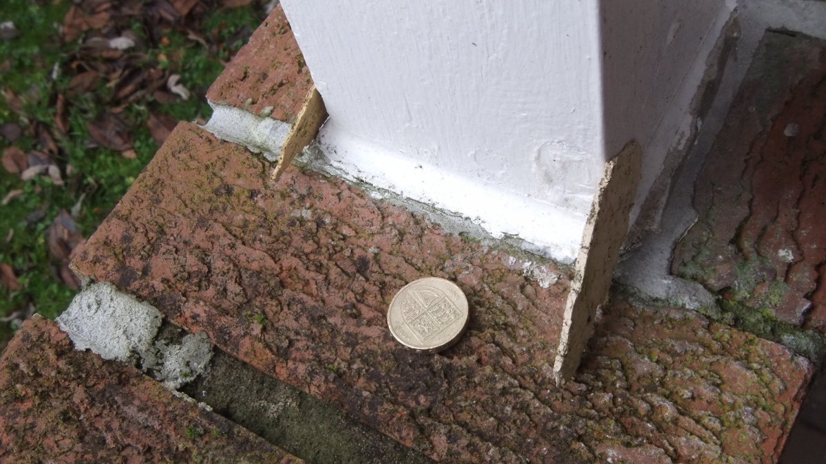

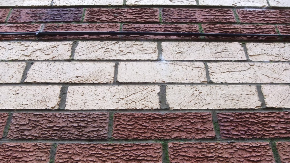

I have noticed on my house thin layers of brick shedding off some of the yellow bricks - not the red ones (they appear to have a different, rougher cast finish). When the 'shedding' occurs, it appears to reveal a smoother yellow surface of the brick, almost like the brick is losing its 'old skin'.
and this photo;

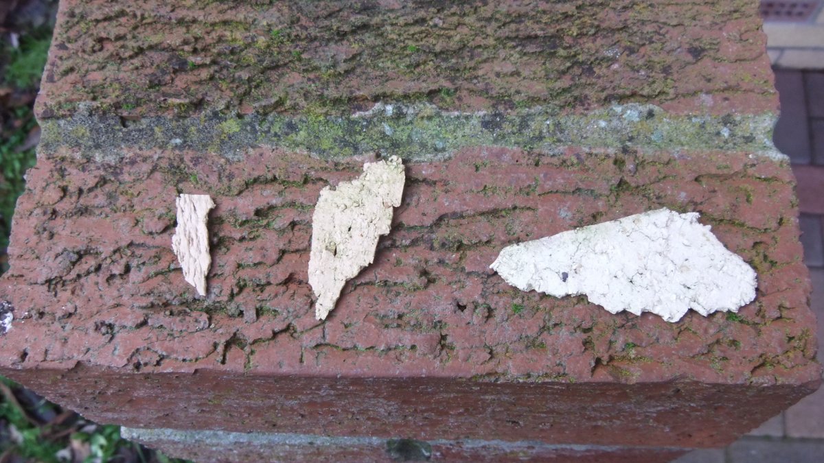

The 'shedded' layers are only 2 or 3 mm thick;
Side on, compared to one pound coin;
I'm finding a few of these sheddings from the yellow bricks around the side of the house; perhaps five or six of them this year, but we have had a lot of rain recently.

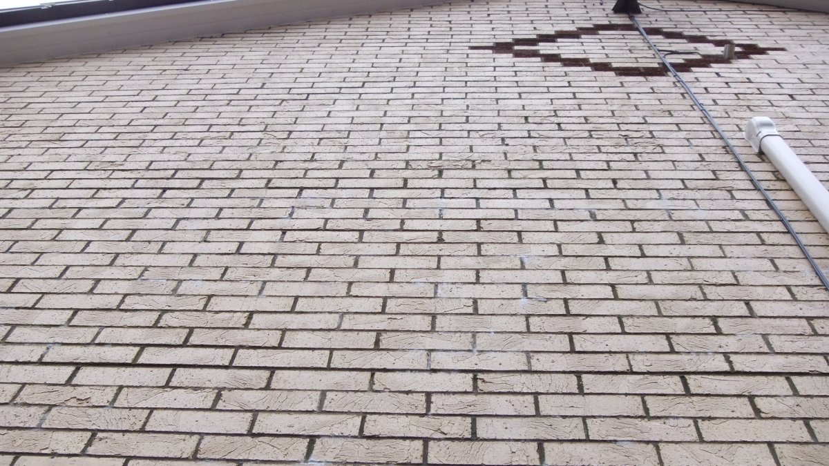

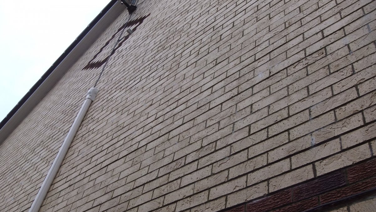

Here is some pictures of the gable end of the house:
and this one:
Should I be worried about this 'brick shedding'?
is that wall getting excessively wet, for example from an overflow pipe or gutter?
Is Renfrewshire often frosty?
Frost damage; quite normal for the crappy bricks commonly used in modern houses.
Those bricks are not only the ugliest I've seen but must be the worst peforming too. So not fit for purpose.
It looks like you've got poorly made bricks. Perhaps not the whole brick, but the way that face has been applied to what looks like a normal dragged face brick, seems to be the problem.
Expect more spalling, you won't stop it, but just keep your eye on the smoother face once the outer piece had fallen away. If that remains intact then you will be fine.

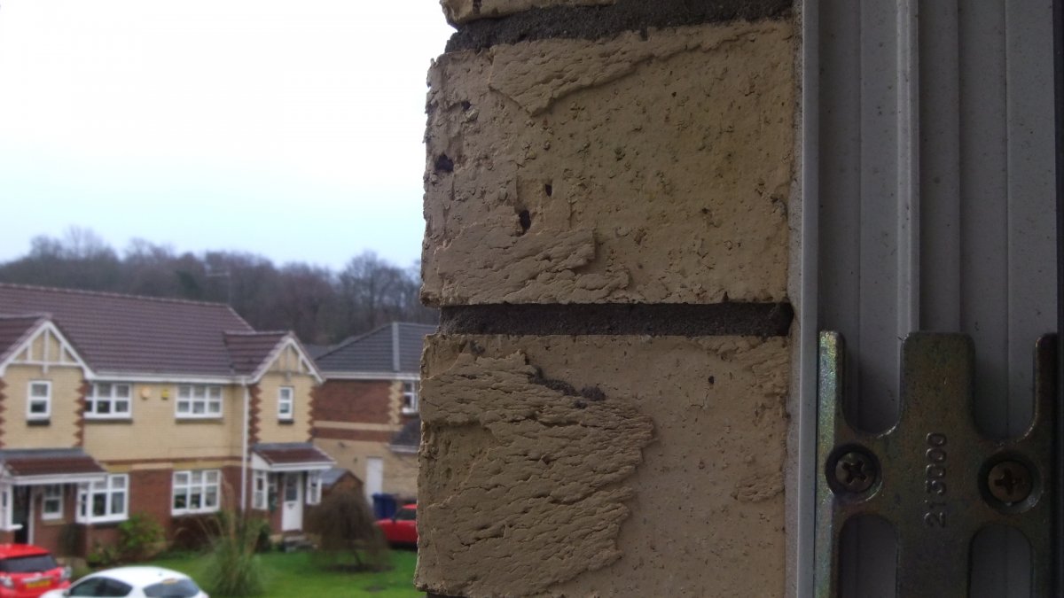

I took a couple of close up shots from my bathroom window:

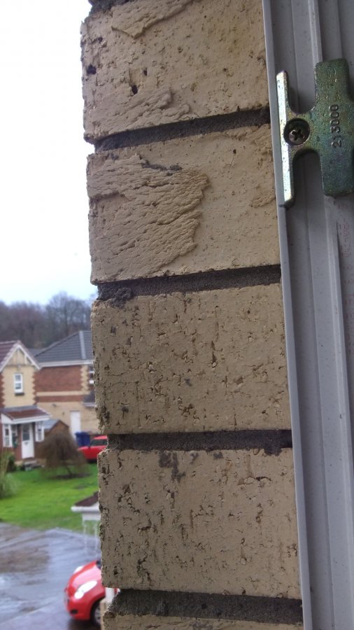

First of all two bricks that are 'shedding':
And now comparing these two 'shedding' bricks to the ones just below them:
It reassures me that, as you have hypothesised Woody and as can be seen, once the bricks have 'shedded' they appear to be smooth and robust.
One can only wonder if this 'extra facial layer' applied to the surfaces of these bricks was an intentional attempt at cosmetic render or accidental?
The brick joints(recessed/raked)aren't really suitable to your climate(over exposure to rain/frost/freezing) as they don't shed water and therefore freezing temperatures will cause problems, ie, bursting the face.

The bricks like Bectons or similar which are made that way.
The joints look like standard tooled joints which have weathered over the years and now look recessed in places.
If you live in an exposed area the slop clay used for the texture will drop off in time but the bricks themselves will last longer.
Thanks, stuart45; so the answer to question 1, is the texture is intentional and the answer to question 2, is the brick will last longer than this intentional 'slop texture'.
The house was built in 1999. If the 'slop' of the bricks has lasted 16 years before beginning to erode and the actual brick is going to last longer than that, then I should have little to worry about for a few decades?
