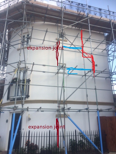

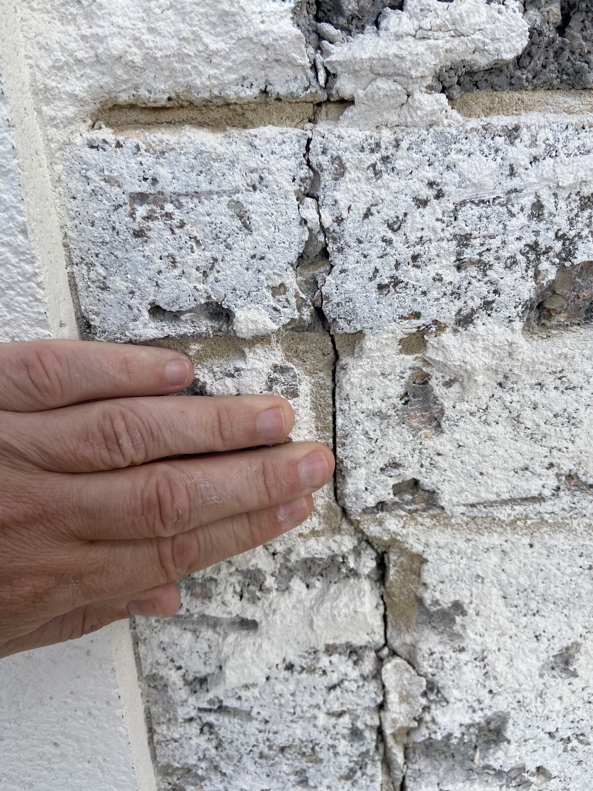

Hi all

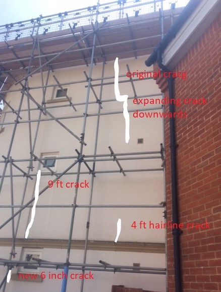

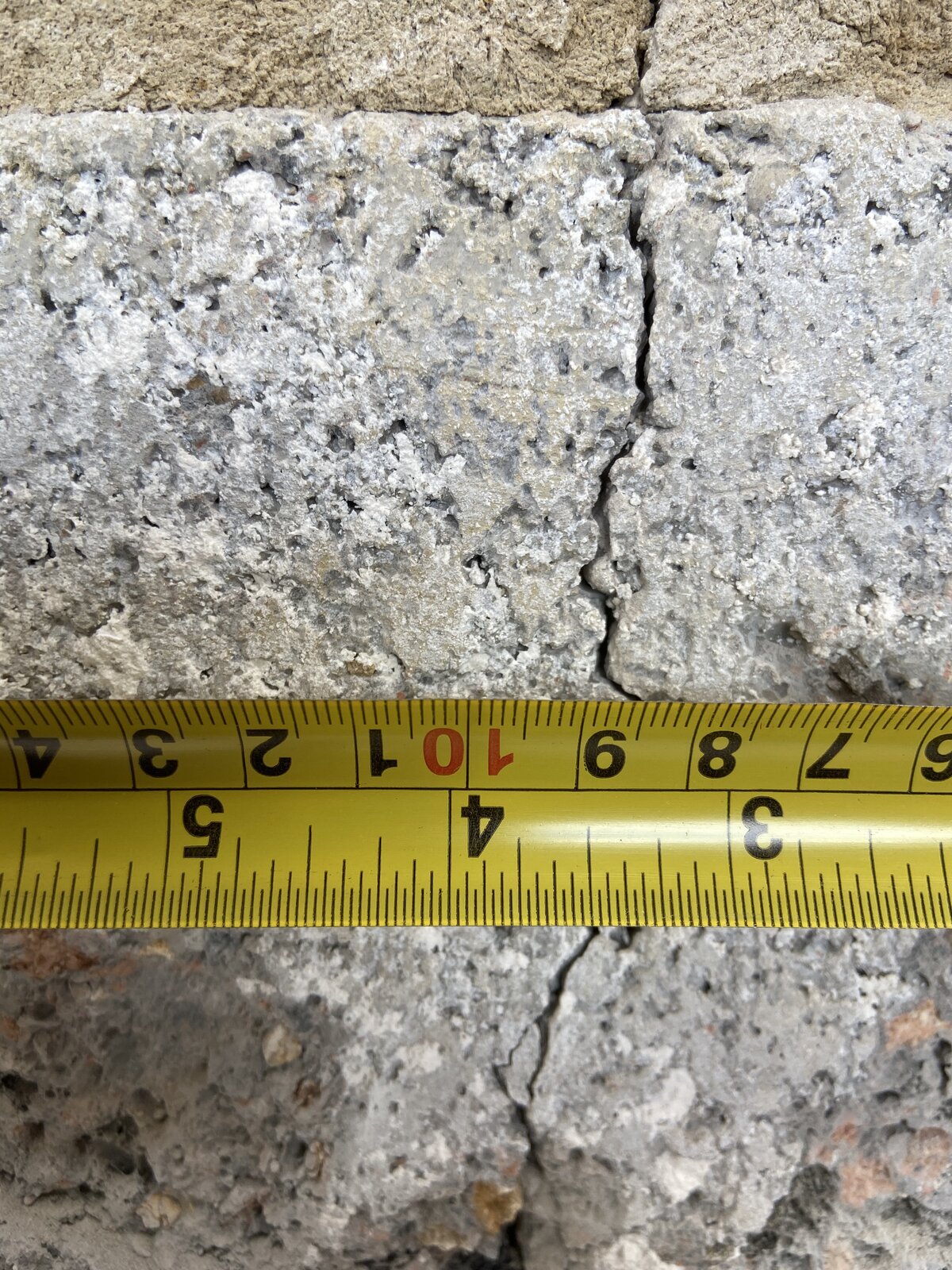

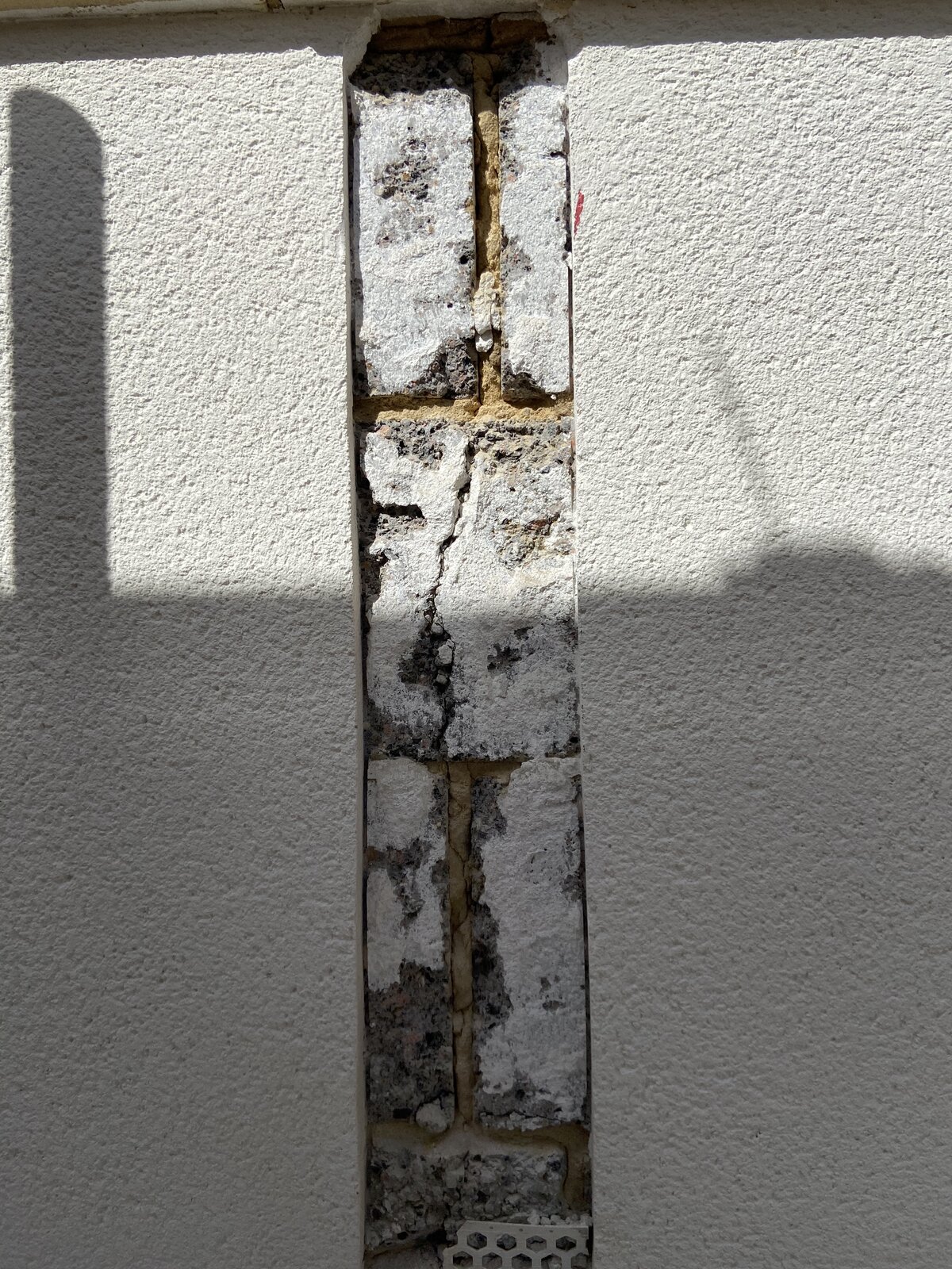

I’m having cracks repaired on my render. They have cut the render back to the brickwork and I’ve noticed the crack is all the way through the brickwork.
It is 18 foot long vertical which does an L shape in middle.
other smaller repairs have cracked brickwork also.
is this subsidence?
The house is built on clay.
If they simply fill in with render I guess it will just crack open again.

Looks a lot like an expansion crack? not Subsidence.

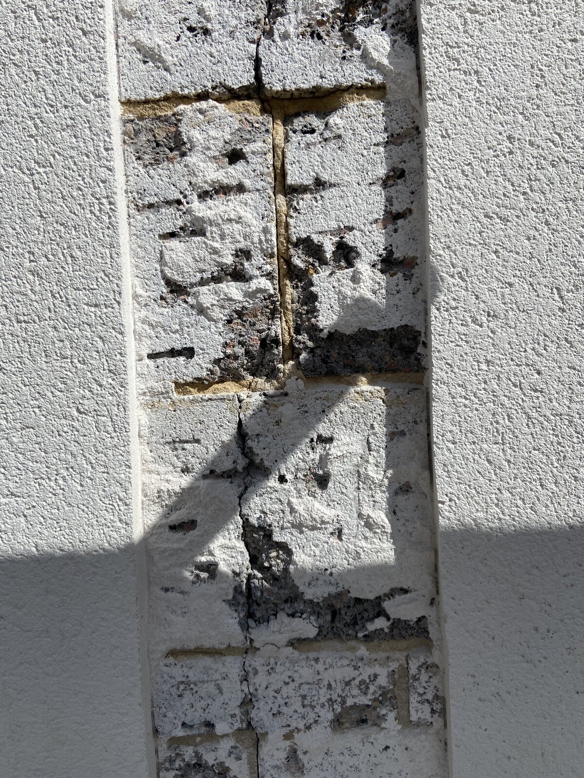

The crack looks to mimic the crack in the render. There are more cracks.
The 18 ft vertical crack in this picture is the main one with the cracked block work. The top crack in the picture.
However, they have cut the render out horizontally from this crack in 2 other places.

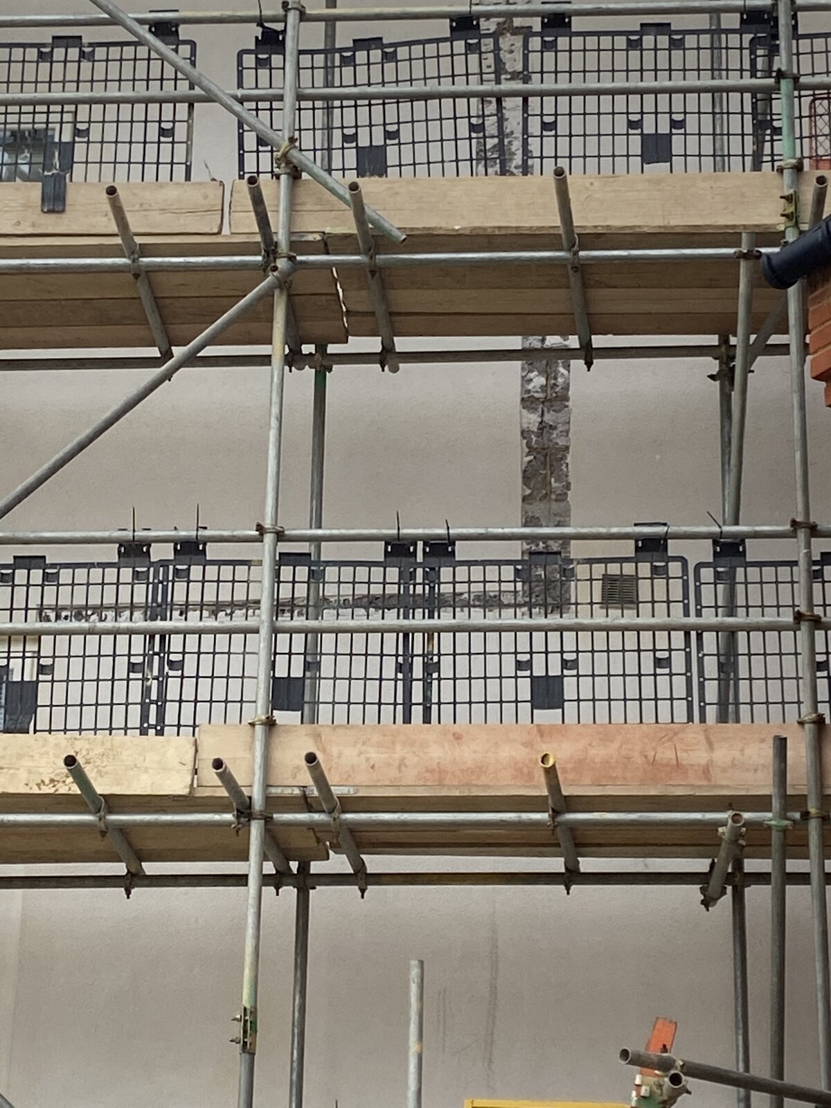

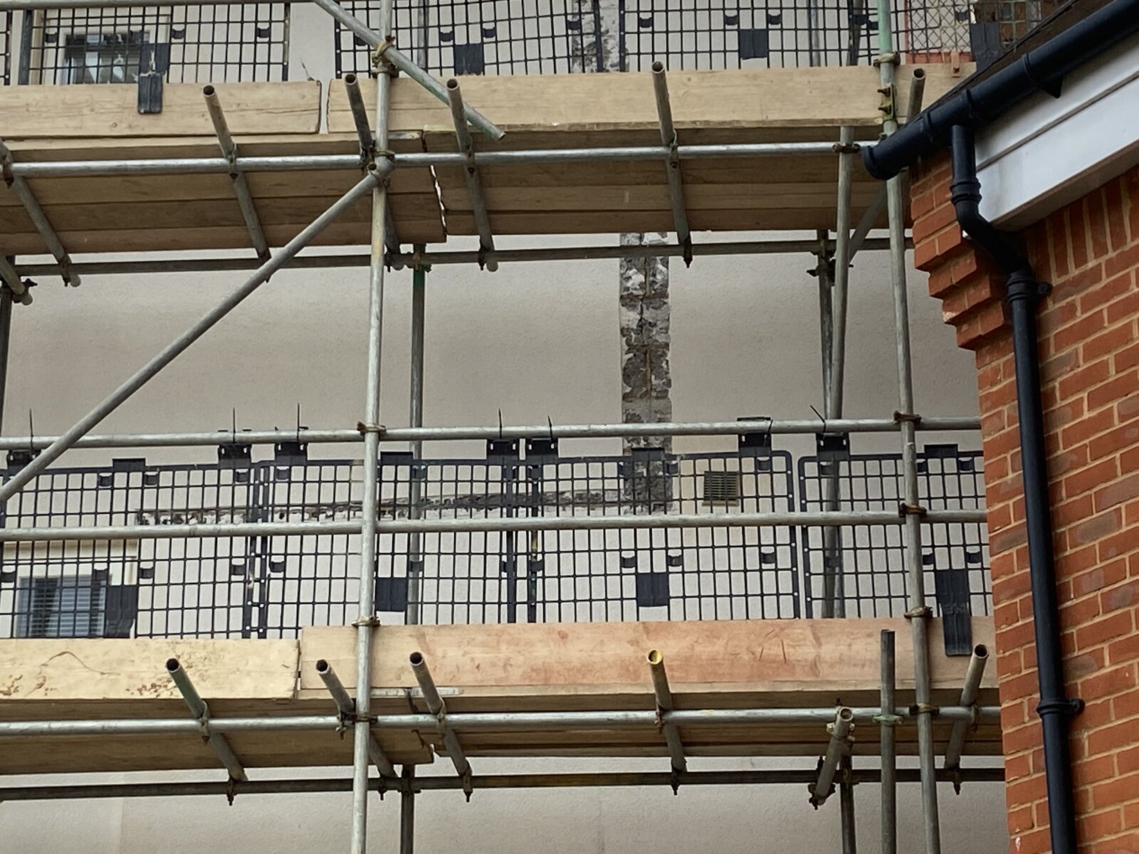

The building is 40 plus foot high. That main crack is 18feet in length coming down the house.
They have cut two other channels out from this main crack that I`ve marked in blue.
the expansion joint I`ve marked in maroon colour. It goes from the ground to the window. Then a gap and starts again higher up.
The expansion joint is 13 feet from the right hand side/end of the building.

The image showing the 18 ft crack you can see the 4 ft crack below it. That crack goes all the way up and meets the 18 ft crack so the crack is from top to bottom. Wider at the top.
The render company said its expansion cracks.
Should they investigate further with a survey or is the mesh the correct fix?

As a general rule, on an elevation such as yours any expansion joint MUST be continuous over the full height of that elevation, with as little "deviation" as possible from the vertical.
It would appear that because on your elevation, the purpose built expansion joint is not continuous that in and of itself is causing thermal stresses to accumulate causing secondary cracking in other areas of the elevation.

I asked the render guy why the expansion joints stopped and he said because they hit the natural barrier, the sunken in windows and structure.

I would have thought that the "missing" section of expansion joint should have been cut out, with provisions made to install cross expansion joint wall ties with if needed [Structural Engineering input please] tying the two cut faces of the wall that has been [or not been] cut.
As for the lack of mesh? when the manager turns to ask him to prove to you that there is mesh in the repair? if needed, use a magnet ??? it will be held to the repair if there is mesh in there, unless the mesh is Stainless Steel.

The longest crack 18 Ft has two other 10 ft horizontal cracks that have been cut out.
You can see one in this picture and the other runs level with the next level scaffold board.
