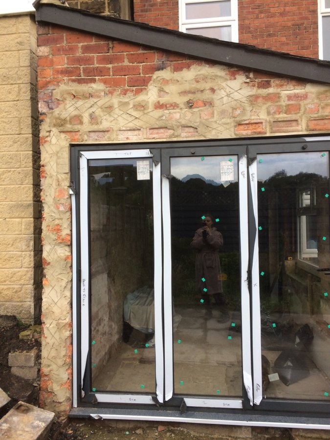

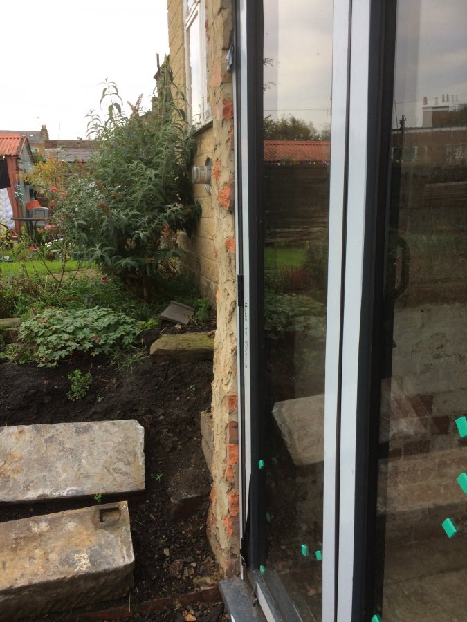

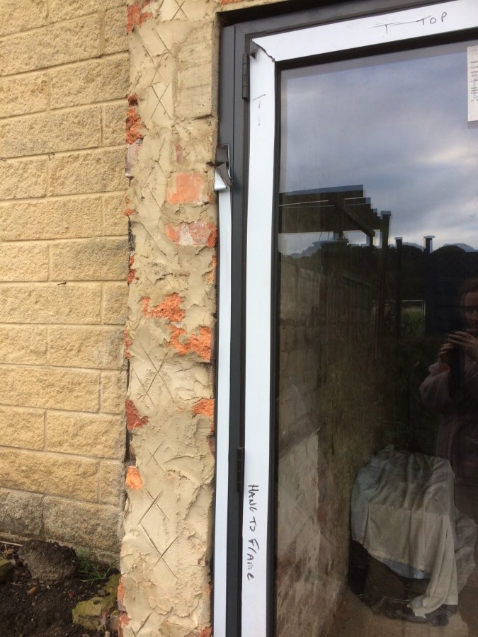

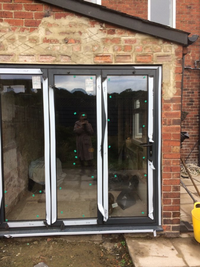

So we had a coal shed knocked down which was tied in to our kitchen wall. Then we've had a bifold door put in. At the time we planned to render the brick, but now we've decided it would look tacky and out of character for the old house. The builders have done a really rough job of the brickwork probably because they were told we would render and because they've rushed the job. Now we're left with an uneven messy bodged up wall, how can we fix it? I just want it to look normal! thanks

Erm that is a mess - even if it was going to be rendered there are bricks the wrong way round. Is there a Steel Lintel above the bifolds as there should be but it doesn't look like there is.
The only way it can be fixed is to be taken down and rebuilt - otherwise Render it but I wouldn't be happy rendering that even as render needs a solid surface or it will just crack.
yeah seconded on the lintel, it looks odd. Do you recall any kind of beam going in above the doors? I think its going to need to be rendered.. you could get a nice smooth render done though.
Let's play 'Spot the Lintel'.
& the rules are : muppet diy'ers are not allowed to enter.

That wall is just crying out to be rendered.
Even as a muppet DIYer I think I could have done a better job on the brickwork than that.
And I can't see a lintel either.
Gerrembacktodoitagain.
Not sure I get the point here - especially as that looks like a single brick wall i.e. there isn't a cavity so I would expect to see something!
If you are happy with the structural bearing then you could always get some brick slips and clad it to a better finish
That's definitely probably the best solution in the circumstances, and there are some really nice ones on the market now, but I'd be very unhappy with builders leaving it like that in the first place. Nice dressing gown by the way :)
