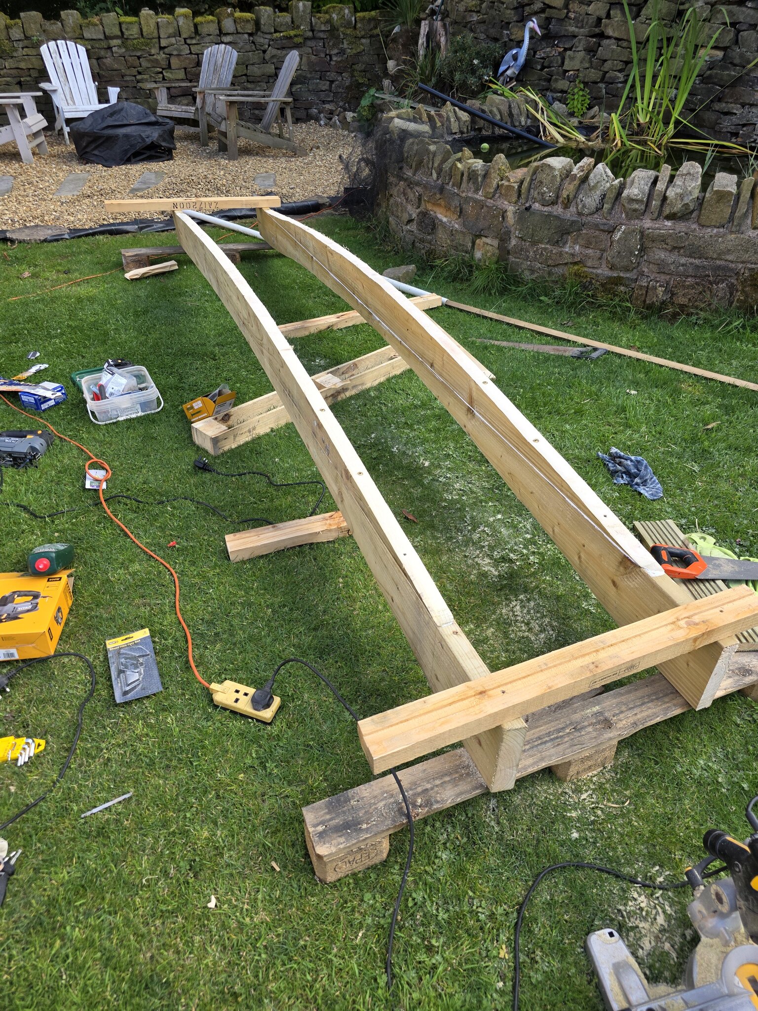

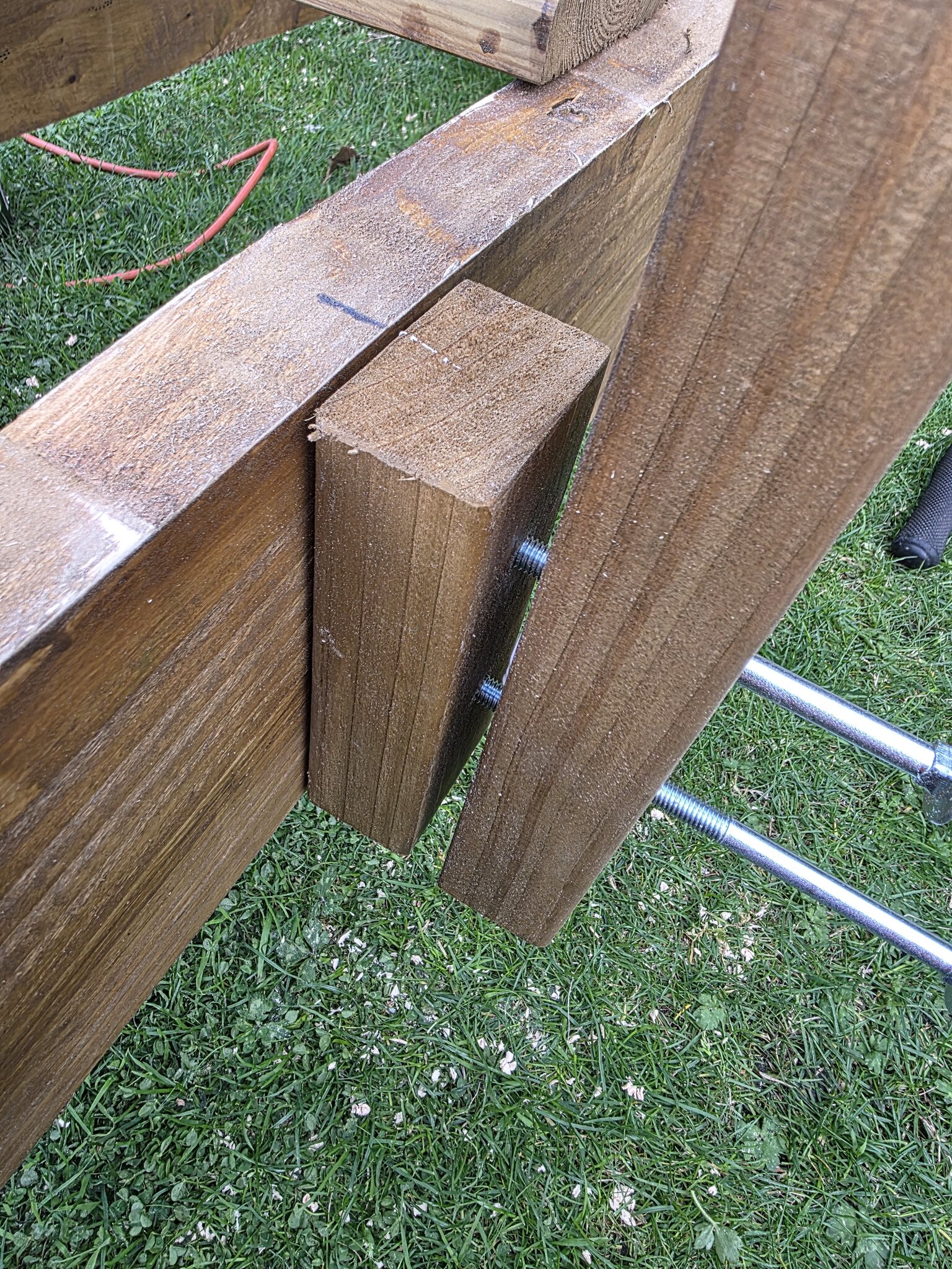

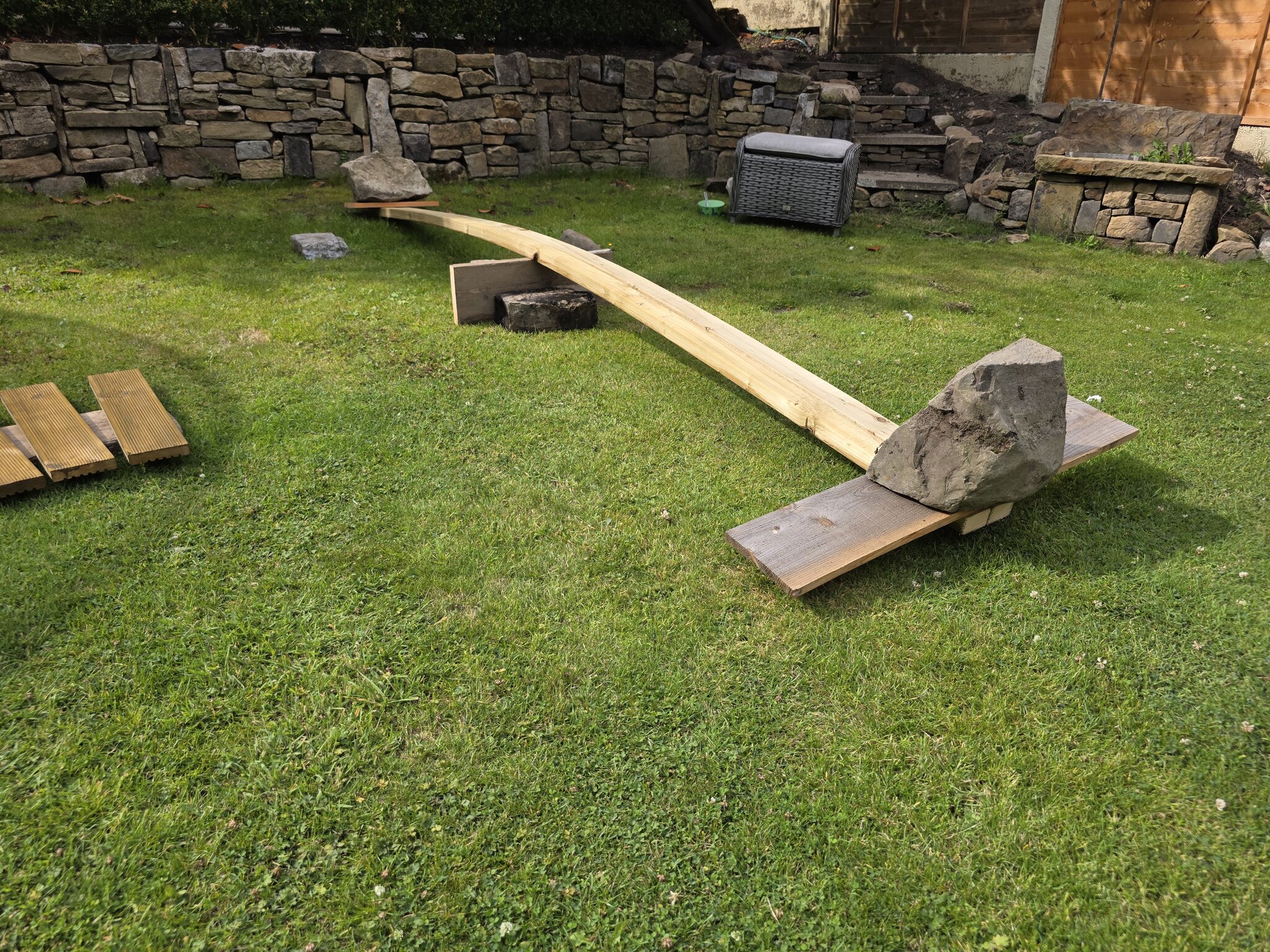

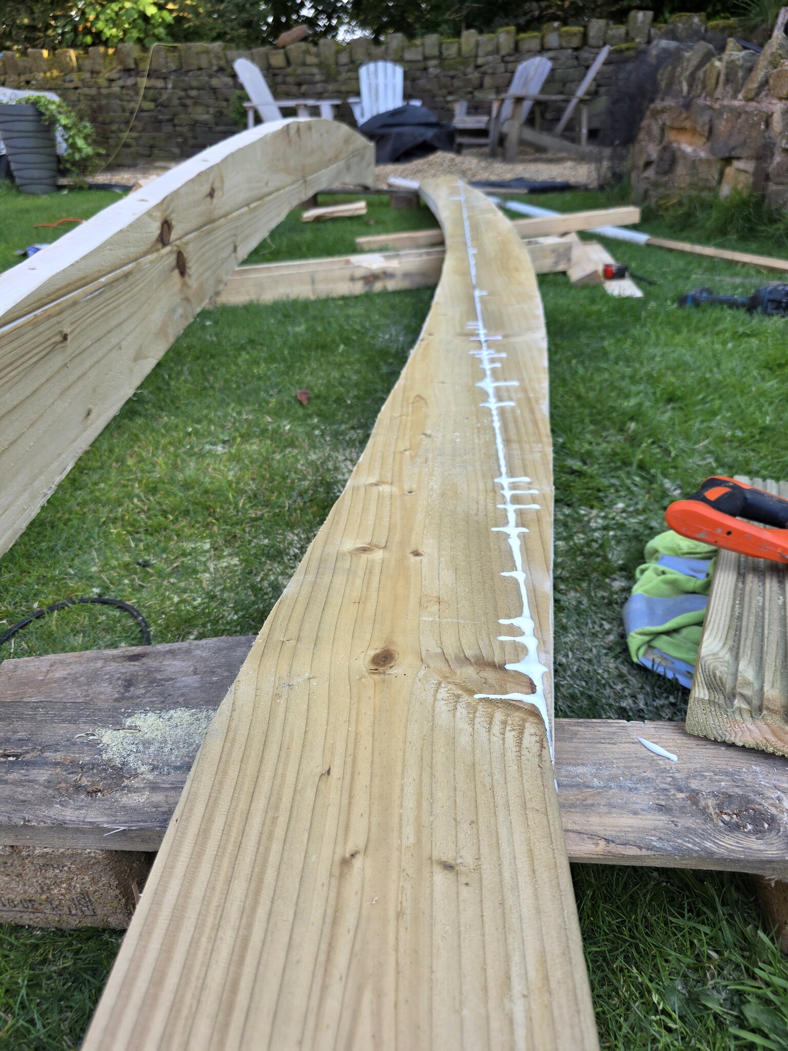

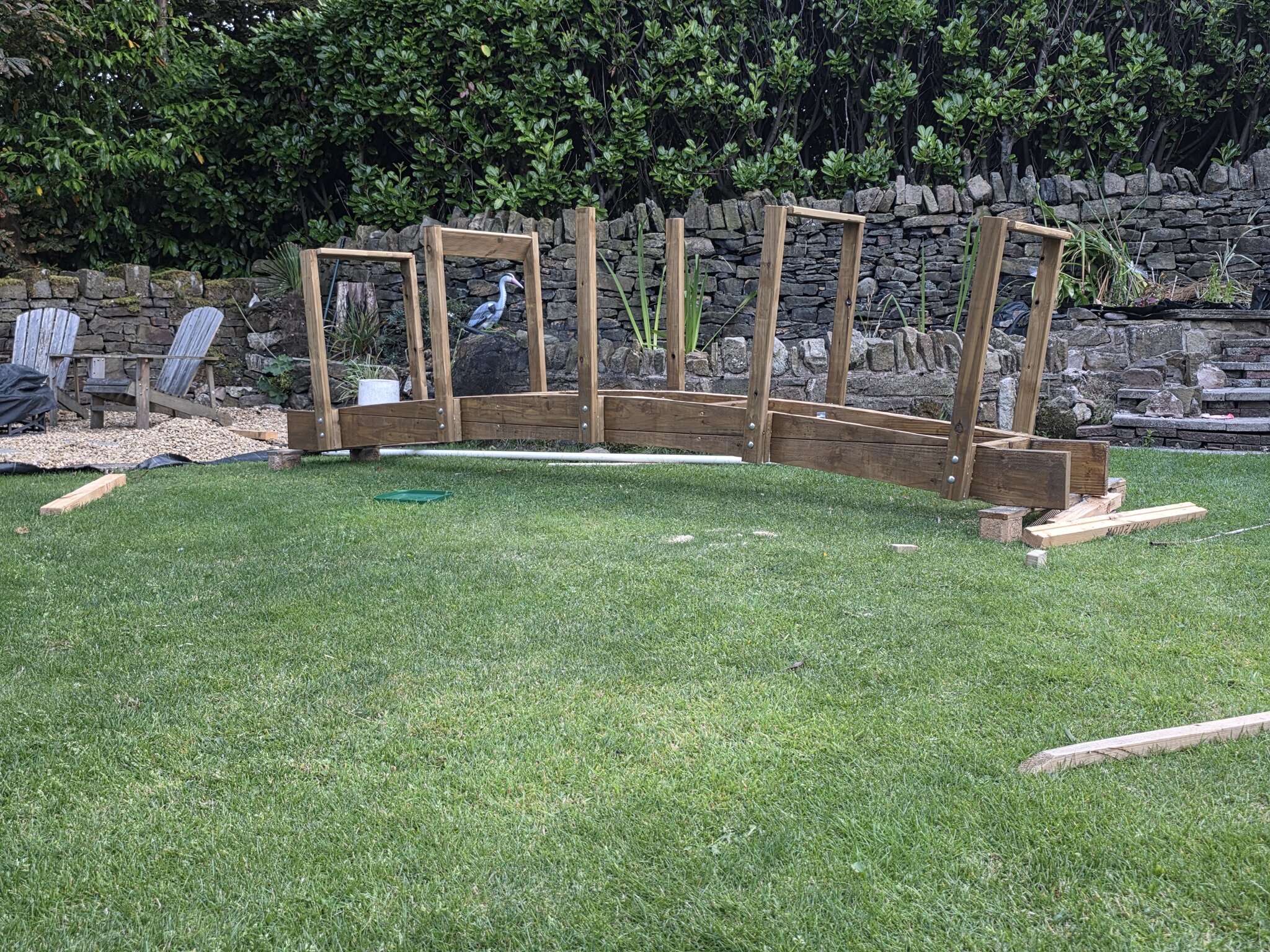

Hello,
I'm going to build a bridge over my pond, its doesn't actually go anywhere so I'll rarely be on it, it's more to shade the water and give me something to attach my net too.

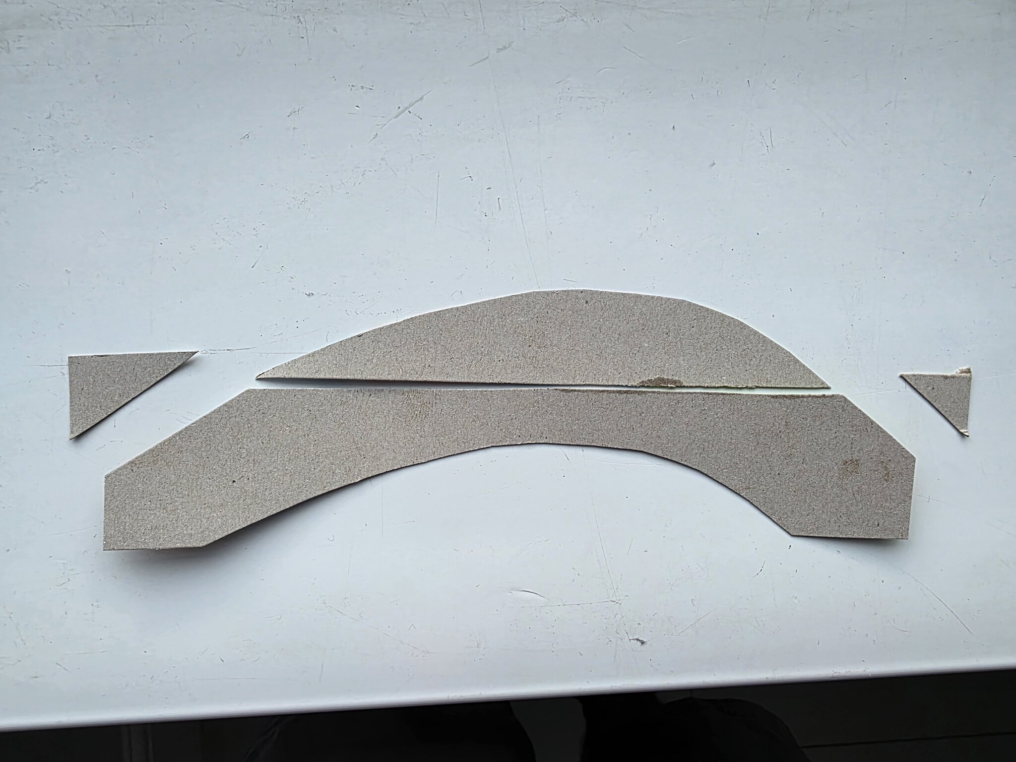

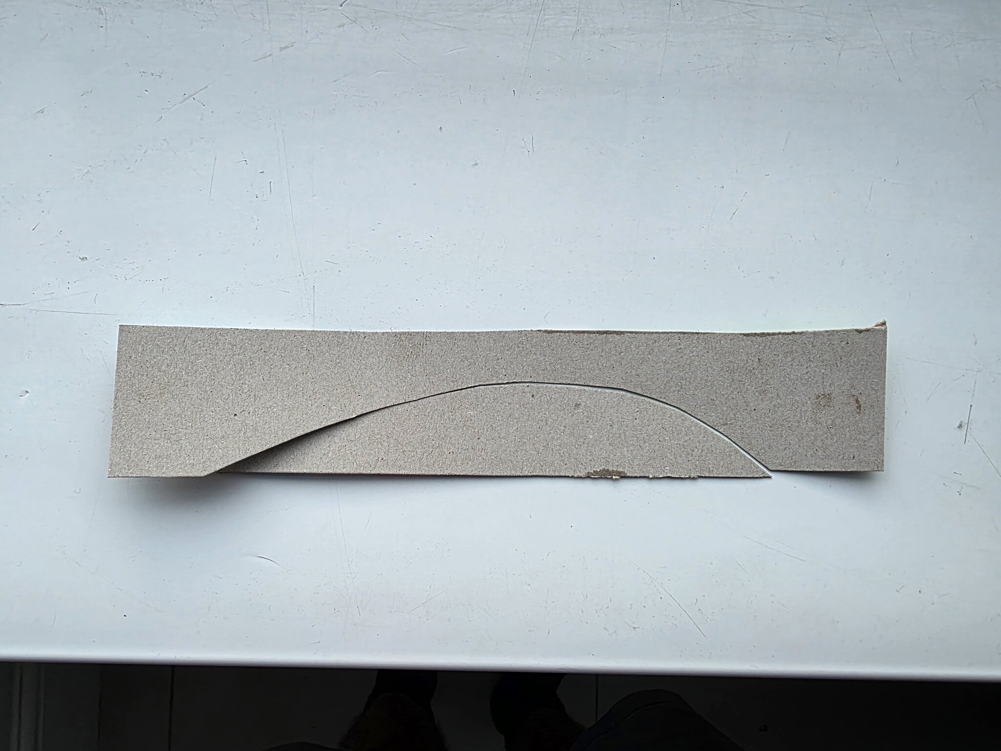

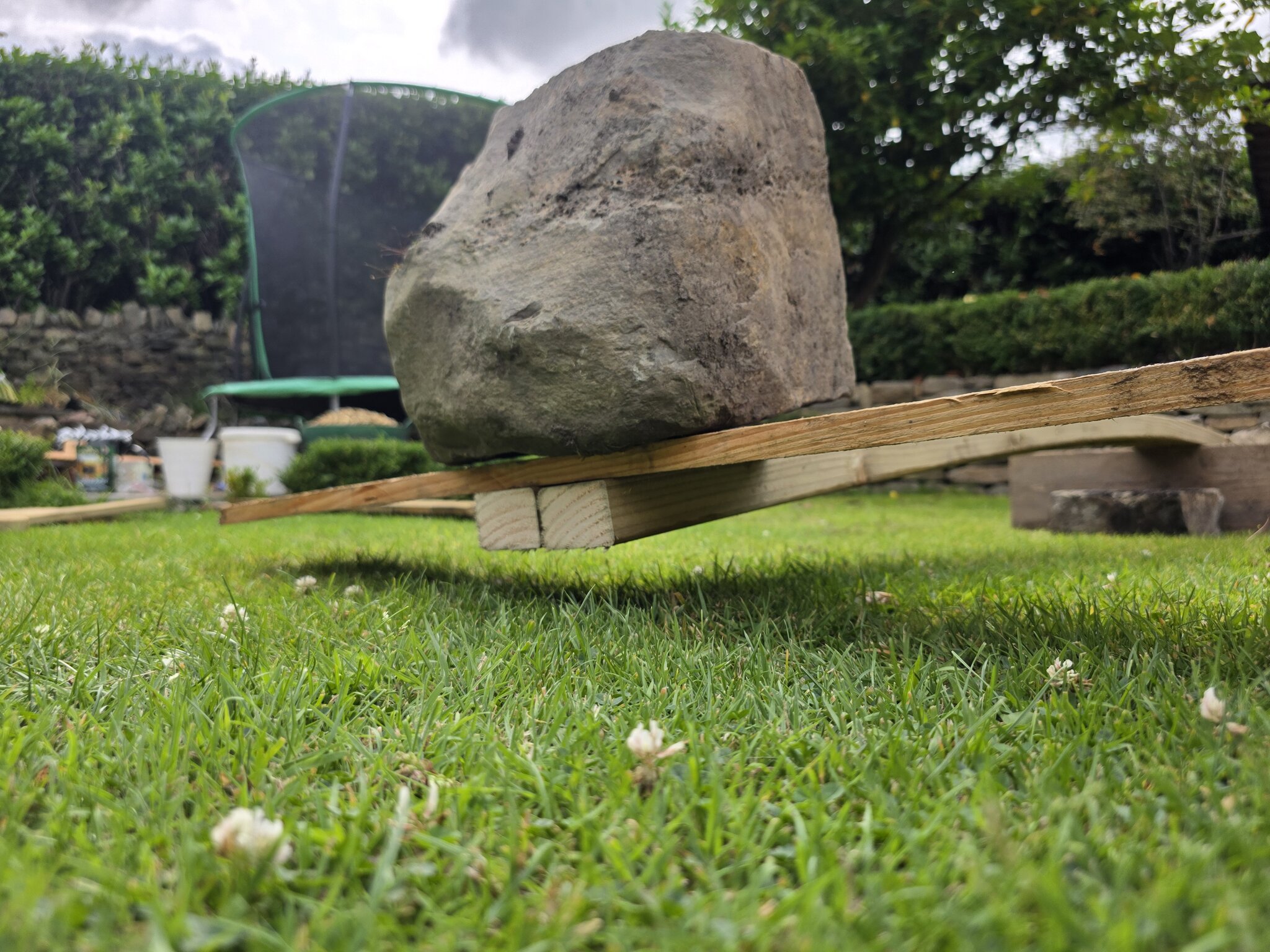

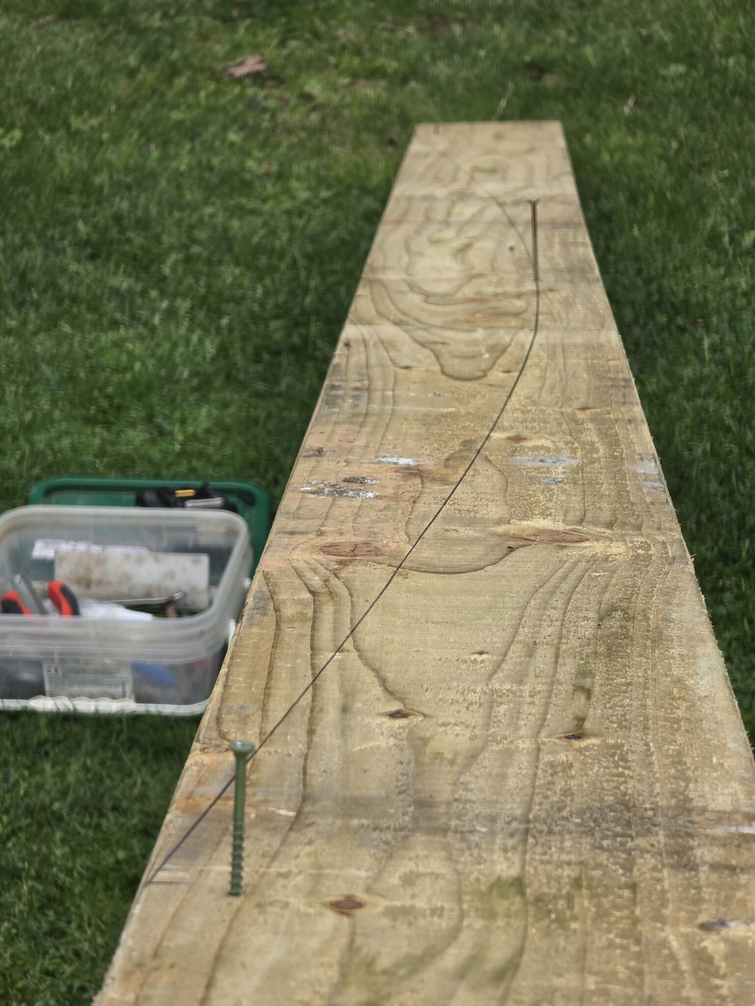

Its a 3.5mtr span and I was going to use a pair of 8x2's with noggins between and decking on the top. Then I wondered this, could I cut an arch out of the 8x2 and then glue and screw it back ontop? Would it be quite strong?
Here's a cardboard example of what I though:
I'd really like to go 6" into it in the middle if possible.
What do you think?
I do not know the answer. I am sure that @jobandknock would have though but he is on a "sabbatical".
Off the top of my head, I am wondering if creating a former and laminating several sheets of ply (with appropriate glues) might be stronger. Again, I don't know. Hopefully a grown up will be along soon to offer sage advice.

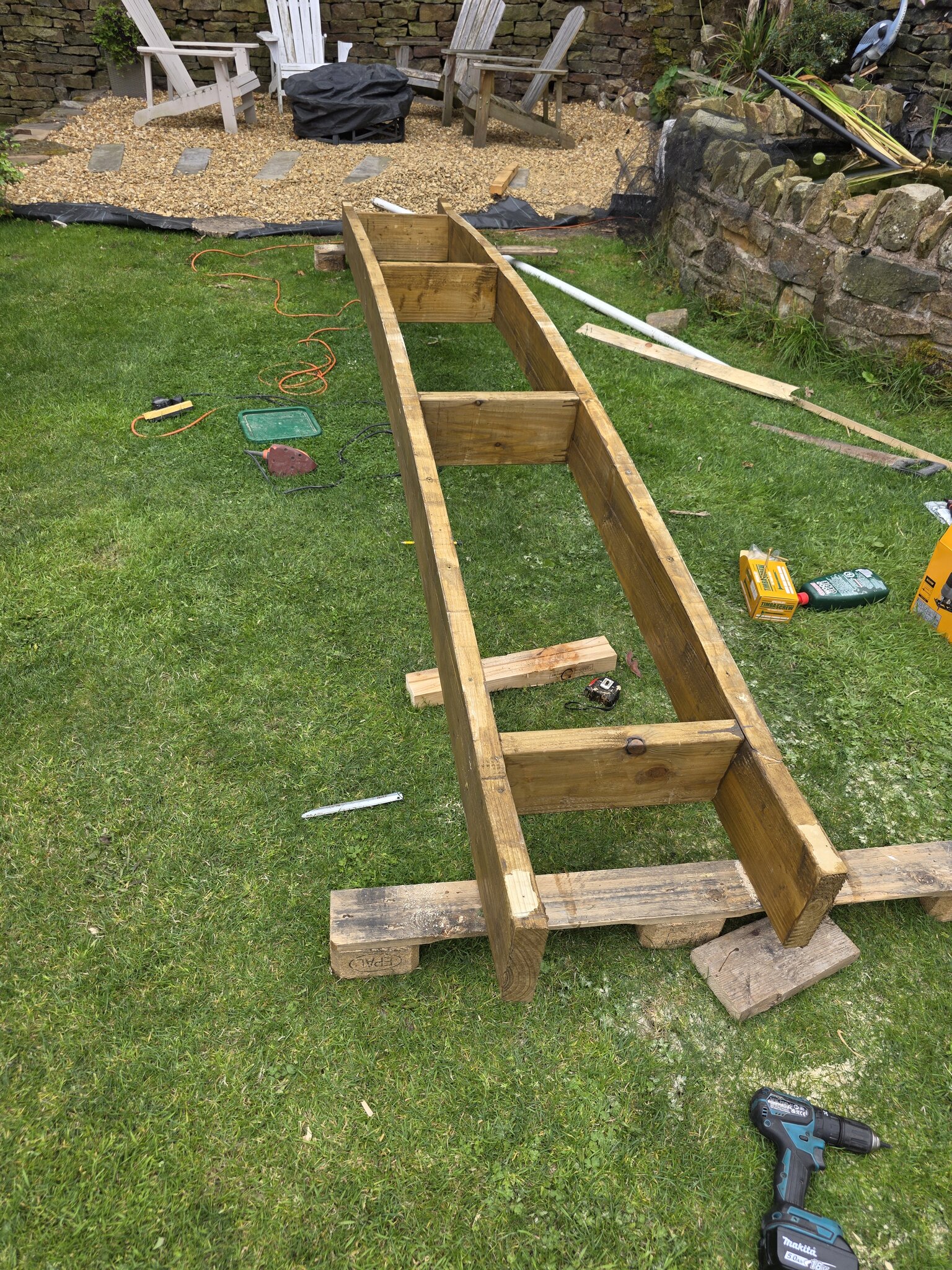

That's excellent, thanks :)
I'll give it a go, worst case I'll have to buy some new 8x2 and do it flat.
