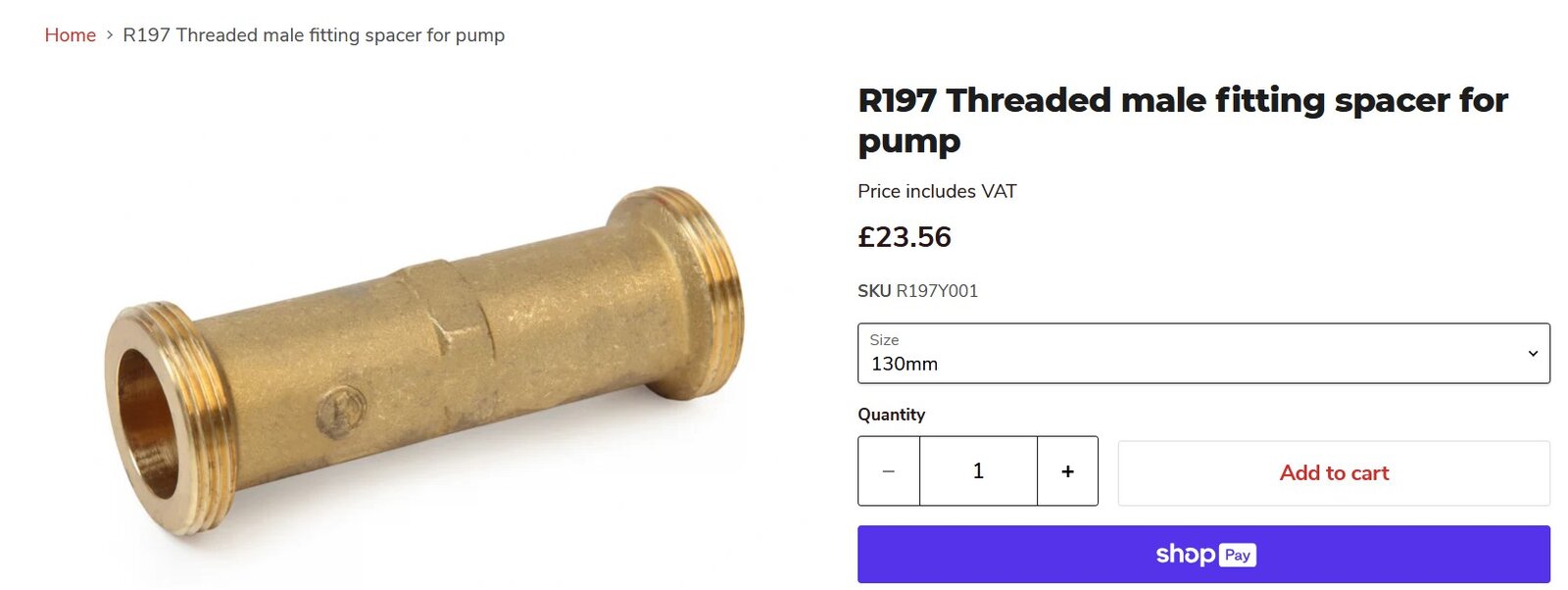

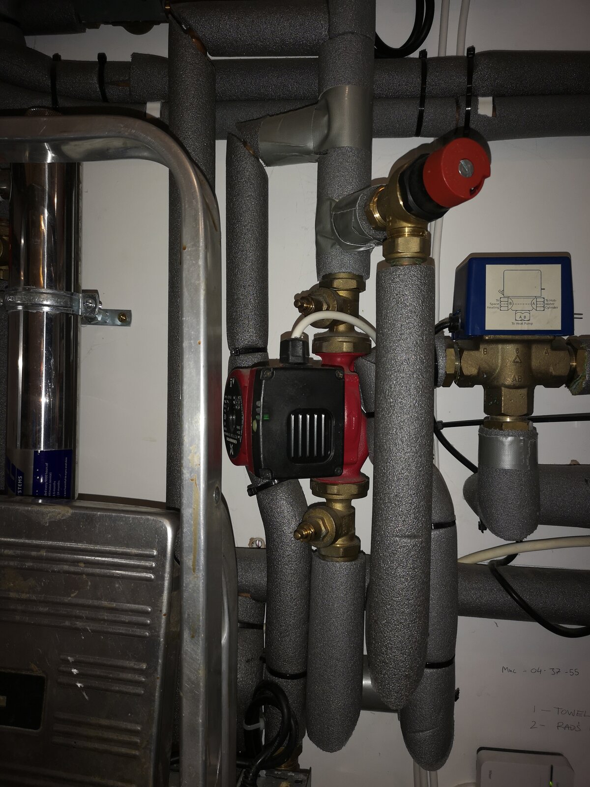

Anyone know of a fitting that can go between 2 circulation pump valves, in place of the pump?
Need to remove the pump but it may have to go back in at a later date.
It's on 28mm and between 2 fixed points so would be much easier if I could slide something with flanges in and couple up to the existing pump valves.
Fingers crossed.
Cheers.
Not sure I could seal up a plate on an old pump body! I suppose CT1 and some holes in it to clamp up with pump body screws!
The bushes and male irons sound a good option.
1.5" running nipple would be ideal if there such a thing?
I don't have the tools to thread a length of iron but could maybe get something run up by my local metal fabricator!
