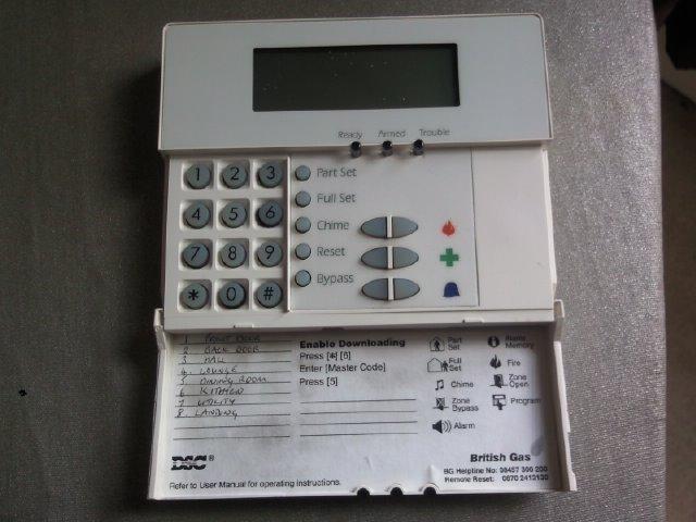

Hi,
I'm just trying to get my DSC alarm up and running. Theres no model number on the control panel it just says British Gas DSC.
It was installed by the previous owners. It looks like this:
There is also a door contact that is on the alarm box. This is no longer on the door due to them having a new door fitted.
I've put all new batteries in all the PIRs and also a new battery in the mains box. All i'm faced with is the trouble light though, it lets me get to program mode with both user and master code and then the armed light comes on, but it will not arm and when i press # to return the trouble light returns.
When I press *2 it displays 1, from reading about it seems to be either 'needs service' or 'low battery' I know it's not the batteries as all are new.
I've also replaced the batteries in the door contact to check whether that was causing the issue.
I also think it may be linked to the phone as when I press the buttons on the control unit I can hear the beeps on the phone line.
Does anyone know what the problem is or am I best getting British Gas out? They are after £85+VAT though the robbing gits. I've tried a local company and they said they can come out but have said that sometimes British Gas can lockout the alarm if they've previously monitored it.
Any advice welcome

You probably need to sort the door contact out. It could be Zone 1 - hence the 1 on the display. Did you just get a new door, or a frame as well? If it was just the door, could you fit the old magnet to the new door?
If the whole door and frame have been replaced, can you get to to the old cable (or did you say that it was wireless?)?
Whatever it is, try to persuade the alarm that the front door is closed! If you've got a wireless contact, make sure that you defeat any back tamper (a spring/lever/button that sticks out of the back to warn you if anyone tries to remove it from the frame - use a rubber band...).
Good luck :wink:
Cheers for the reply,
I tried again tonight with no luck. I taped the tamper on the door contact to stop that.
I pressed *2 and then a no.1 showed again. I then pressed 1 again and a number 2 came on.
The door and frame was replaced by the previous owner.
Looking up the no.2 it's saying bell circuit trouble. All the wires look to be connected ok.
