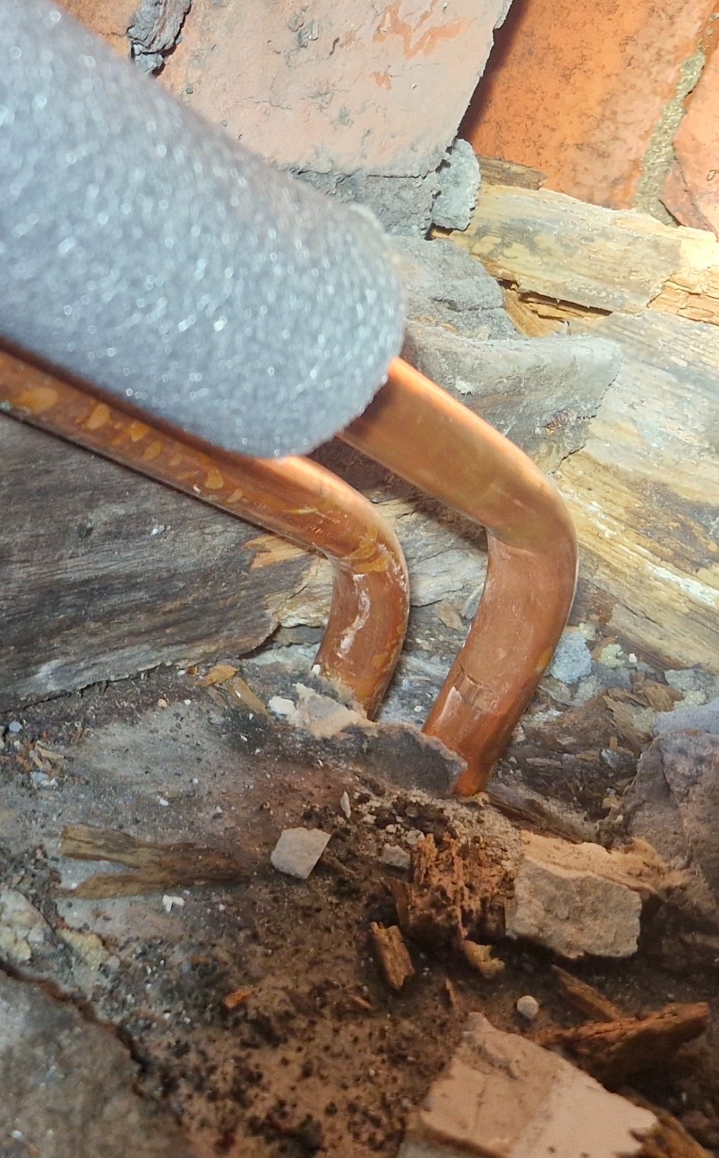

Hi guys got a full new install last year from british gas for a wet heating system with copper droppers down the walls
looking in the loft today ive been looking at some of there pipe work
i do abit of plumbing my self and to me this dont see like a great bend at all has a wrinkle and also look abit flat
what would anyone else say or am i just being to fussy ?

Very poor, but if it's all working ok then it shouldn't be an issue.
Those timbers don't look very healthy though.
Yeah i mean im gonna have them back if others agree that its poor work...
Yeah the ceiling timbers are rotten on that end as we have had a water issue from the outside so this will need replaced
Yeah i mean they say there gonna send someone out and they likey be like like im some sort of picky arse... but it cost over 9k to install so i feel it sould be perfect
you are being a picky arse they are not going to change it , it has no detrimental effect on the heating and its not on show . As has been said i would be more worried about the state of that wood
yeah its by looking to sort the wood that this has came to my attention if you want to do a sub standard job charge a sub standard price and then maybe a customer wont be a ""picky arse""
