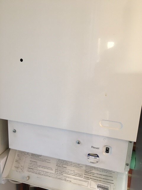

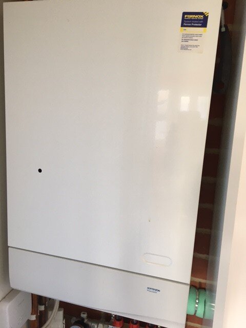

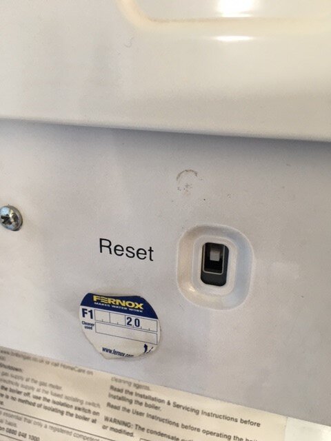

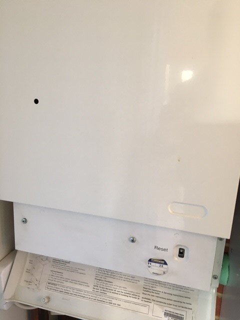

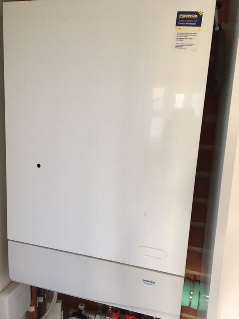

When it locks out the three lights flash in a sequence what is the sequence ?
thanks for your reply. am lost though when you refer to 'tree lights' flashing in a sequence.
there is only one light which comes on where the reset button is and its a constant red. there is no sequence to it. its always been constant red when i go to the boiler and i when i press it, the red light disappears and the boiler fires up and starts working.
thanks so much. please see picture. my boiler has a single button at the front and the red light comes on behind/around the reset button. currently working so its not showing the red light.

British gas do not make anything, the Potterton precision was a rebadged boiler so BG could sell them and pretend it was their boiler, Potterton/ Baxi and main are all the same company, yours looks like some sort of Main variant, but not sure which one, when was it last serviced properly ? as @Chris_W says it sounds like ignition lock out but may not be the actual boiler it could be other things, I would recommend a Baxi fixed price repair if they still cover that model
serviced every year in February. last service was feb last year so due a service soon. i will get the service engineer sooner then. many thanks
Make sure that it is properly srtip serviced and not just a Flue gas analasis which all the big guys do now, it is a total rip off, make sure you tell the engineer aabout the first fire lock outs, dont just expect them to find the fault during a service
