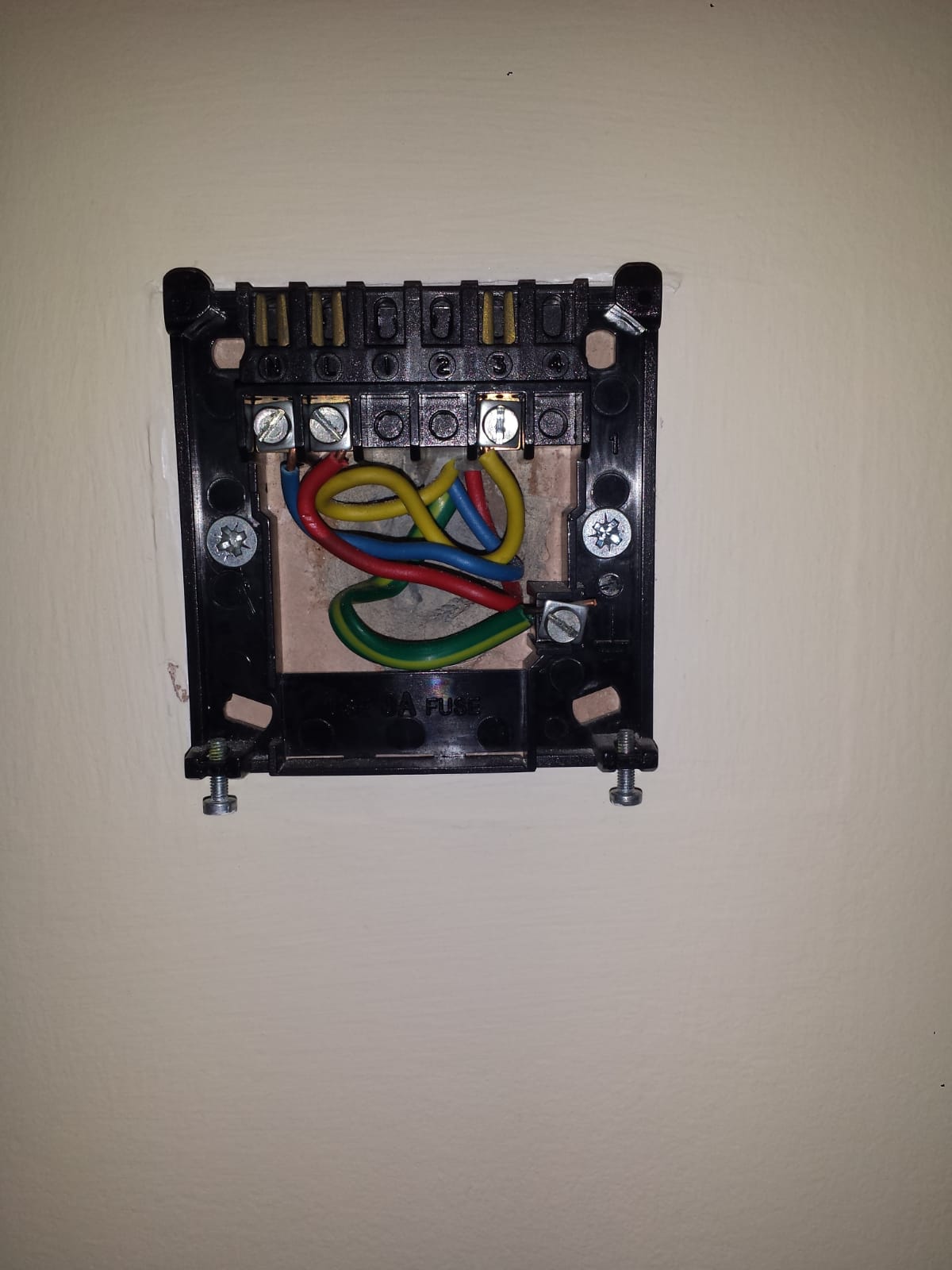

The heating system is an S-type system with 2 x two port valves, a British Gas UP1 controller and a British Gas RS1 room thermostat (see pic).
Once the heating is switched on from the controller, it stays on, even if you turn it off from the controller. I've worked out that this is likely to be a stuck valve.

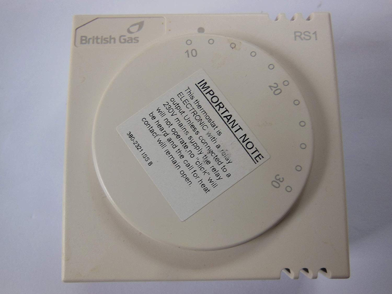

However, the room thermostat does nothing at all, i.e. it doesn't "click" when turned. I've tried replacing it for a new Drayton RTSI 2400I Room Thermostat but that doesn't "click" either.
My question is, although the stuck valve would render the room thermostat useless, surely it should still "click" if it was wired correctly? And if not, can someone tell me why not please?
Thank you in advance for your responses. Below I have provided information about additional testing I have completed, in case it is useful...
I opened up the room thermostat (see pic) and used my voltage tester to determine the following:
i) When the controller has no mains power from the FCU, there is a no voltage between L and N, nor between the yellow wire (Switched Live) and either L or N.
ii) When the controller has mains power from the FCU but the heating is Off at the controller there is a voltage of 12v between L and N. Nothing between the yellow wire (SL) and either L or N.
ii) When the heating is turned on at the controller, there is a voltage of 230v between L and N but nothing between (SL) and N (I guess this is two be expected since the thermostat hasn't been switched as the cover is off).

That thermostat only makes an audible click (relay sound) when 240v is applied to it from the programmer,no voltage no click (y)
Thanks for your quick reply. I did swap it for a brand new Drayton RTSI 2400I and it still didn't make an audible click when power was applied from the controller (i.e. the heating was turned on), any idea why this might be the case please?
you will need to get a multimeter and see if you have 240v at the L&N terminals at the room stat as already said if you dont it wont click and wont work either
Thanks for your reply too Ian, i've tested at the room stat. When the heating is turned on at the controller, there is a voltage of 230v between L and N but nothing between (SL) and N (I guess this is two be expected since the thermostat hasn't been switched as the cover is off). Yet, despite this, the brand new thermostat didn't click either?
Turn the thermostat up to full and try again, if still nothing, turn the power off and remove the yellow wire from 3 and put it into the Live turn the power back on and switch the heating on at the programmer, and if the heating comes on then the stat is faulty
Thanks for all the replies. It turns it that the stat was faulty but at the same time, was so was the two port valve for the heating!
