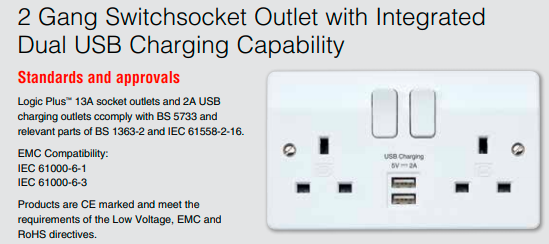

I just wanted to ask if there is a British Standard I should look out for when purchasing wall sockets with built in USB sockets?
Cheers
Would it be BS1363 (socket outlets) that still applies?

The datasheets for MK 'Logic Plus' ones say the following (see below). One would obviously expect the 'socket aspects' to comply with BS 1363-2. BS 5733 is a very 'general' Standard ("Genersl Requirements for Electrical Accessories") ...
Kind Regards, John

With regard to standards I believe the relevant international one is IEC 62680. This is essentially a straight copy of the relevant USB-IF standards. However the version based on USB Type-A receptacle seems to have been withdrawn in favour of a version using the Type-C receptacle. This is logical because it allows powers up to 100W (so far). I am not totally certain whether such a receptacle would have the USB logo to indicate compliance, or whether this would not apply if tested to IEC 62680, but the only compliance procedure I am aware of is the USB-IF one. It is pretty clear that the vast majority of existing combined 13A sockets/USB receptacles (if not all) do not carry the USB-IF compliance logo.

Interesting. As you can see in what I posted above, the MK ones do not claim compliance with IEC 62860. On the other hand, they do claim compliance with IEC 61558-2-16 - what does that relate to?

Safety of Power Transformers.
Depending upon how wide is their definition of "power transformer" (I hope that our resident pedant is not reading this :-) ), it sounds as if that might well be an/'the' appropriate Standard for the 'USB part' of one of these accessories. doesn't it (although you mentioned only IEC 62680) ?

IEC 61558-2-16:2009 Safety of transformers, reactors, power supply units and similar products for supply voltages up to 1 100 V - Part 2-16: Particular requirements and tests for switch mode power supply units and transformers for switch mode power supply units.
USB Charging has a lot more detailed requirements than that. For example the voltage which appears, its tolerance, the current available to be drawn, the signaling to determine the level of current and the connector details. I have seen a review of tens of USB supplies and I can say that I would be unwilling to plug anything expensive of mine into a random adapter without first putting it on an oscilloscope.
