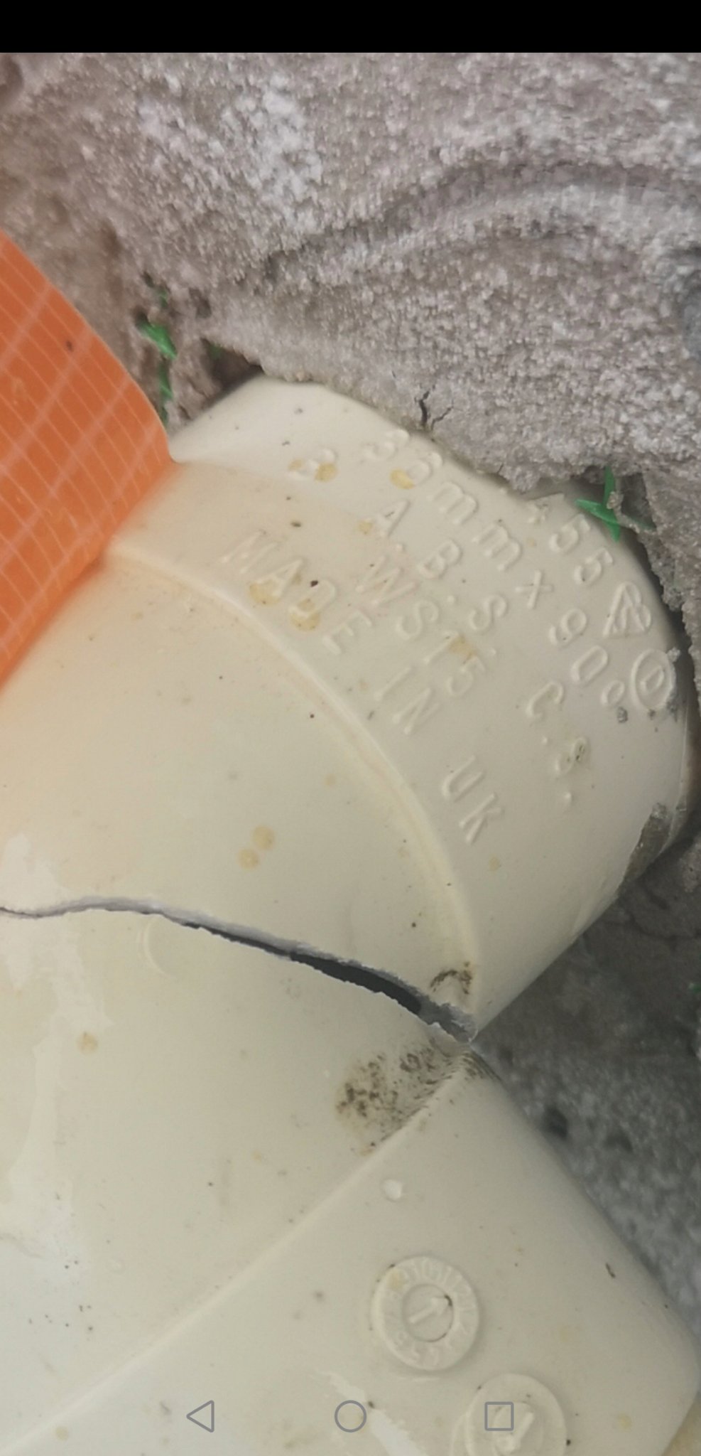

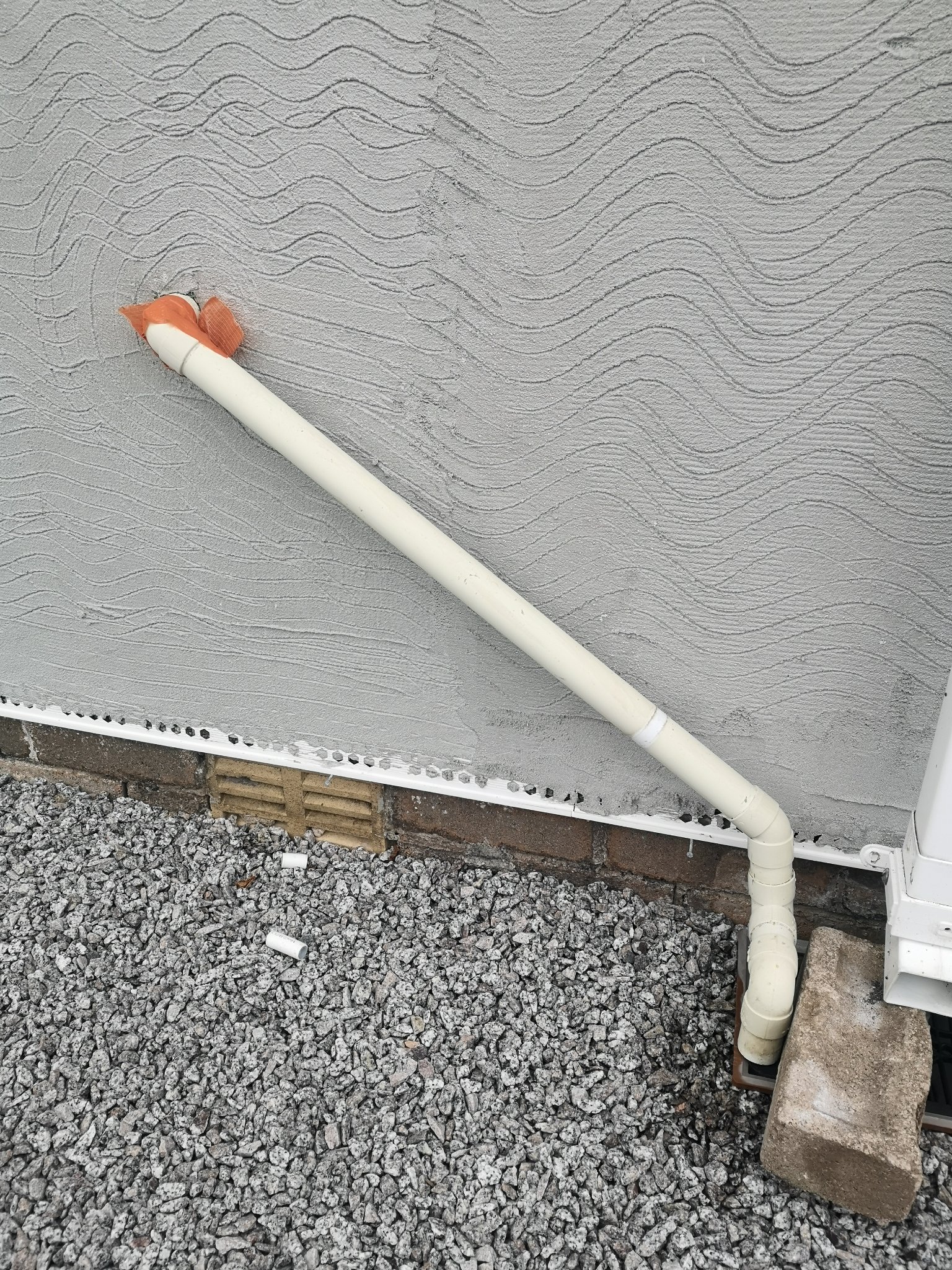

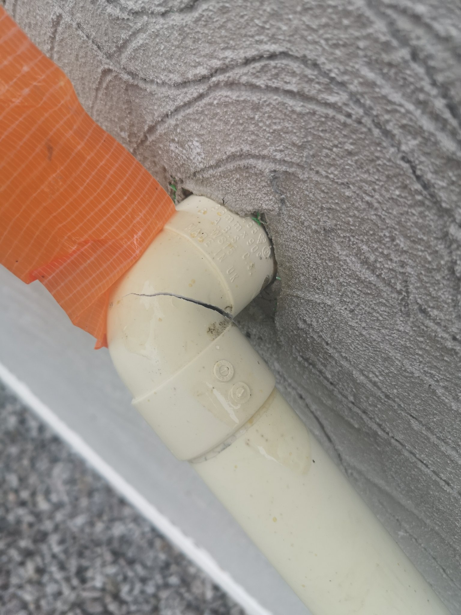

Hi all
Presently having house rendered and unfortunately the renderer has broken the pipe as shown.
Any ideas how best to resolve, many thanks

Unfortunately, there's only one right way to do it. Either cut the render/wall back to get to the straight pipe, cut off the broken elbow and replace. If that's to much, then it's cut off from inside and outside and replace the pipe through the wall, a new elbow and then short piece of pipe to rejoin to outside run.
Unless he warned you about the risk of broken pipe and you agreed, then it really should be for him to fix though TBF.
Id replace it from inside if possible but leave the outside unwelded until the rendering has finished so he can take it off to save him having to get around it.
Old fittings get brittle its just one of those things. I doubt he was being careless at the time
Repipe and use a swept elbow or tee with cleaning eye.
Let renderer finish his job with just pipe protruding out the wall then do the external waste run.
