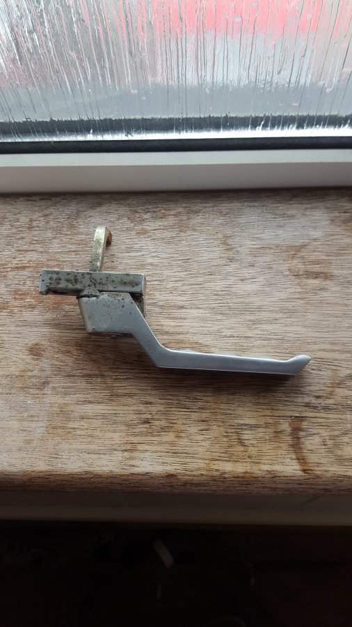

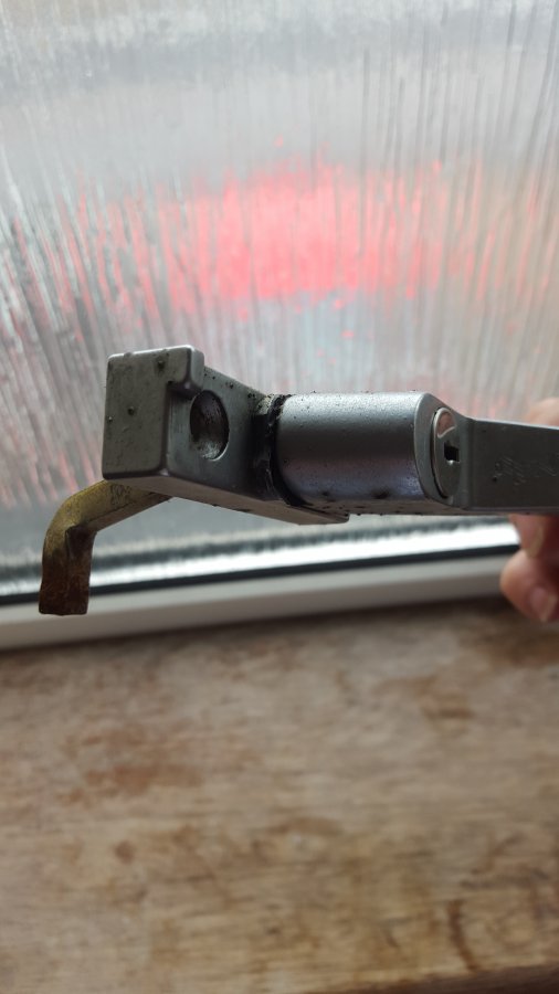

Hi
Bought a handle but i have found that the ones that i have, have a bent bar? Is there a name for these? They appear to be manufactured by Halo

I have emailed the above with some pics, to me it looks like they are bent but i can't think how its possible to bend something like that unless you are superman or something
Bummer. As I said it may be worth trying to swap the spindles over.
They can be stuck in there really well so practice on the new handle 1st. Your probably going to need a Vice, Mole grips, Pliers and possibly a blow torch to get them out.
Or you could try taking the handles to a local metal working place. They may be able to swap the spindles or cut and weld the old spindle onto the new handle or bend the new spindle as needed.

Been in touch with loads of handle people and they have never seen anything like this which is a bit of a bum. the only thing that I can think of is that the spindle has somehow been twisted/bent.
I still am not able to pull the spindle out but I have tried another handle with a straight spindle and it doesn't appear to catch onto anything.
For now I appear to have two options, buy another window (which I would rather not do) or replace the handle somehow. I have seen these cockspur handles which may do the job but my concern is the fixings into the window, from what I can gather, these are pretty knackered on mine but is there some way of securing these handles (bigger screw maybe - but then again its the hole in the handle itself that I have to match.
Do these cockspur ones come in different sizes? How would I be able to get the right size? (measure the distance between the two hole centers?)
